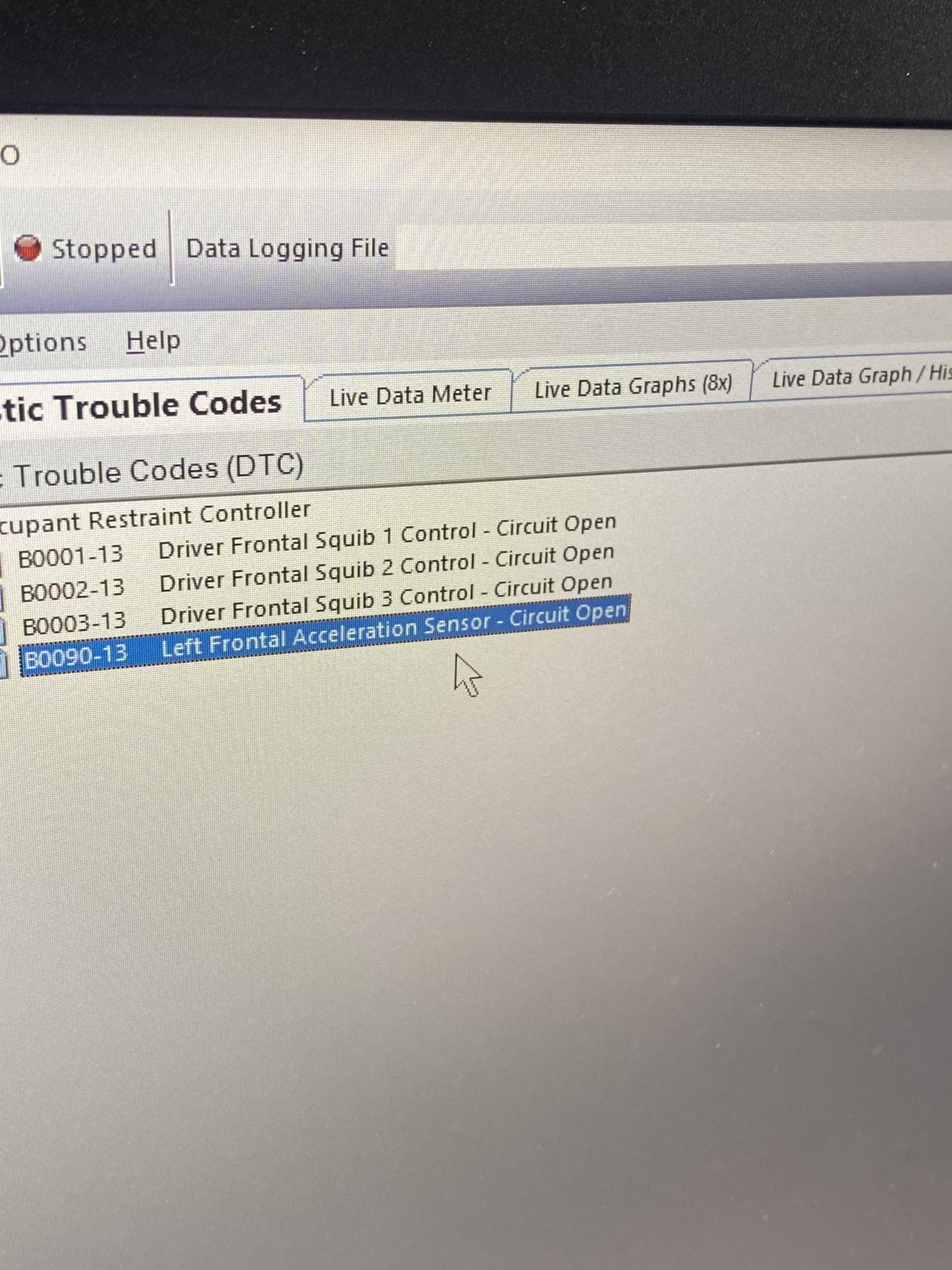

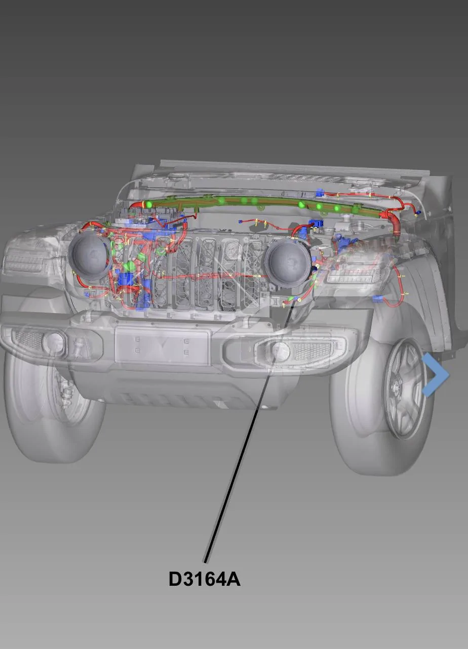

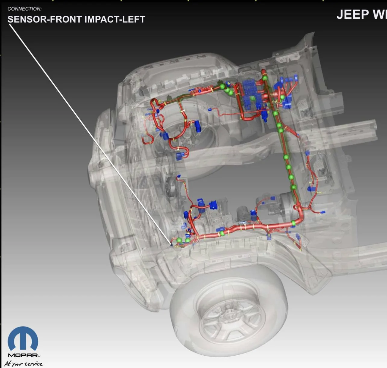

Hello. my airbag light is on and have the following codes attached in picture.
I've replaced my Steering wheel airbag and have sent in my computer and both driver and passenger seatbelts to get repaired stage 3.
could anyone please guide me to the location of the front left sensor
im also having issues with ESS. I recently replaced the small battery and when I remote start the fans are on full blast when I get in the car. ess works for the first stop then at the first red light it shows an error and stops working.

Just a hunch - likely those errors prevent ESS from working. It's amazing what it monitors to ensure it can or even should be working.
