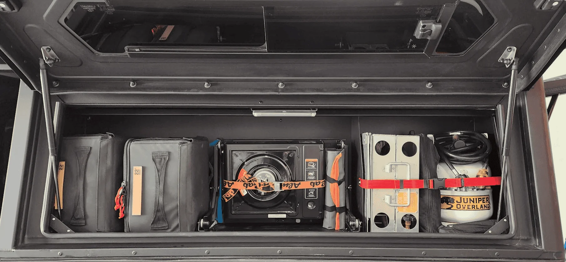

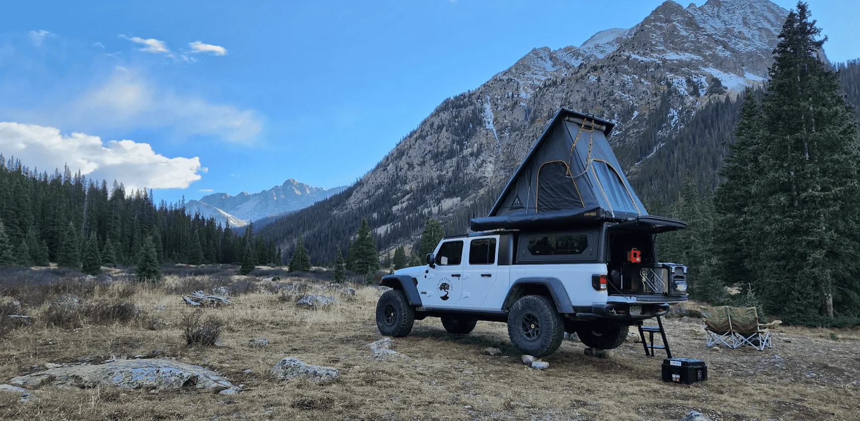

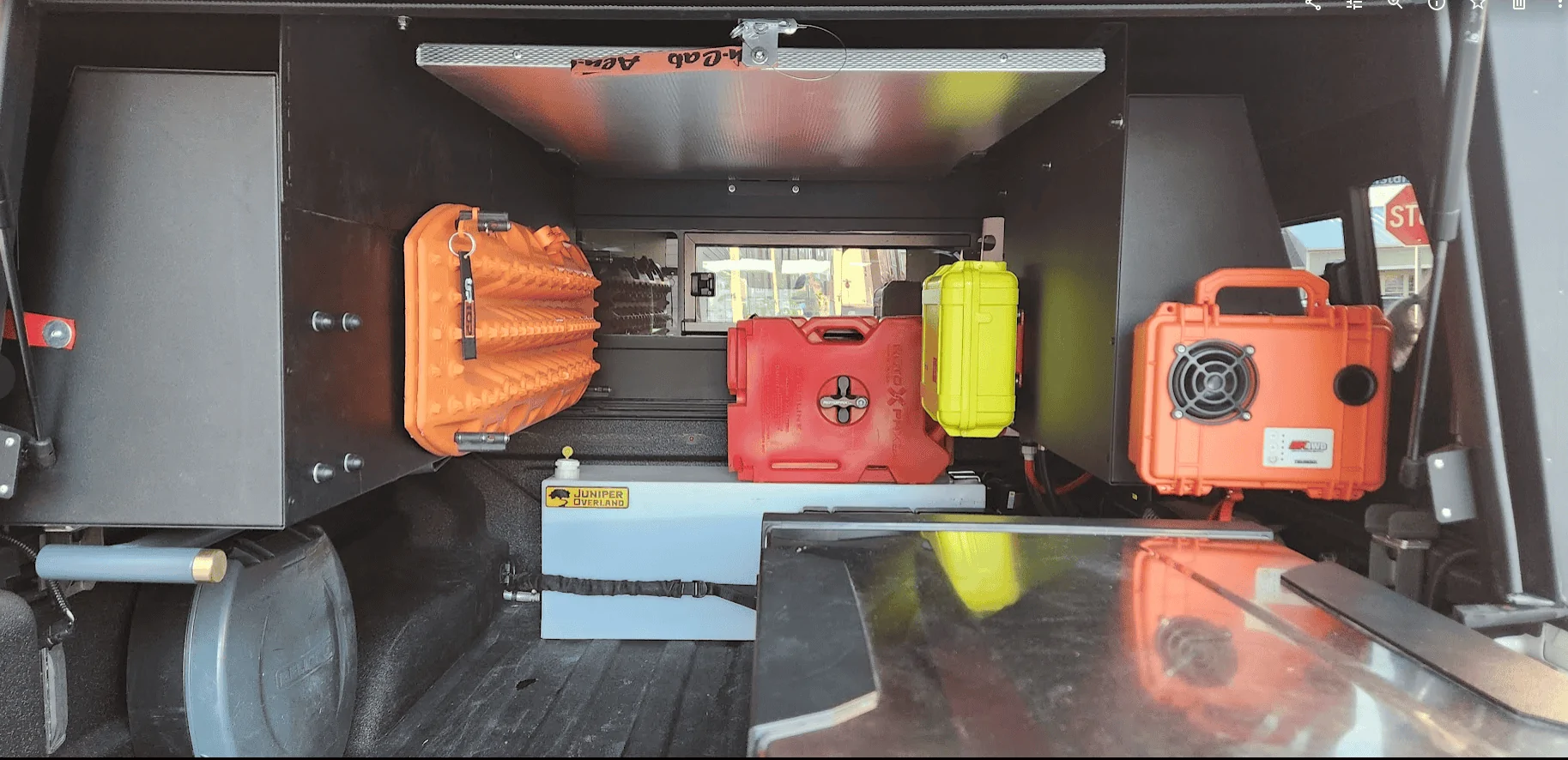

Here's some pics to give you an idea of what I carry... minus a 75lb bike rack and (2) 30lb-ish bikes sometimes.
AluCab Canopy = 137lb
AluCab Tent = 168lb
AluCab Shadow Awning = 53lb
ARB Fridge = 75lb
misc = Stove, Kitchen gear, propane, RotoPax, recovery gear = 125lb-ish
