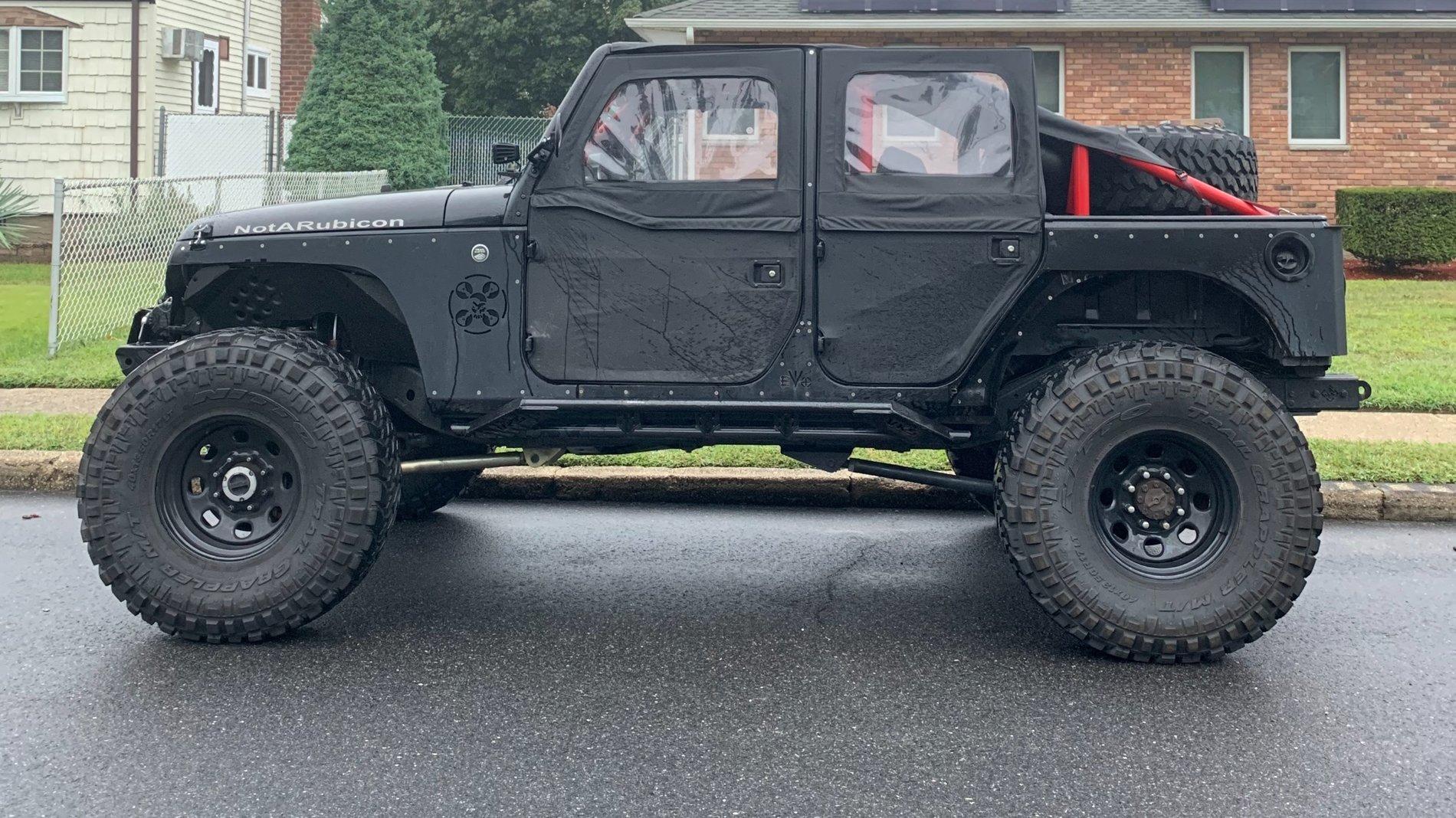

3"+ lift, depending on whos lift is also a very doable in the driveway job. In 8 hours I threw a lift with shocks and springs in plus rotors, pads and full caliper rebuild all around. Now Im a trooper and don't expect anyone else go nuts like I did but as long as you aren't relocating brackets it can be a quick and fun project. A solid day and you'd be rolling like rock star for saturday night.
40's is a lot of tire. Never mind regearing to keep your acceleration at factory rates, 40s are heavy and will impart a negative aspect to unsprung weight, fuel economy and general on road dynamics. I'm sure a few people are going to say you dont need to regear, the automatic is great but the reality is even with 4.10's your time to speed and throttle to speed, aka the ability to leave a light and the ability to pass are gonna are gonna be murdered. Gearing will help that get back to stock so it moves like it should.
But 40's are heavy, I'd want to up size the brakes and look at steering assist options. Gyroscopic forces being what they are, the stock kit won't give you what you want.
Other than that a gladiator sitting on 40" MT's with some butch bumpers and skids & armor will look real tough.
For reference a buddy has a jku on 40's with a 3.5" lift, dana 60's under it.
It'll put the top rail of the bed at about 5' from ground.
