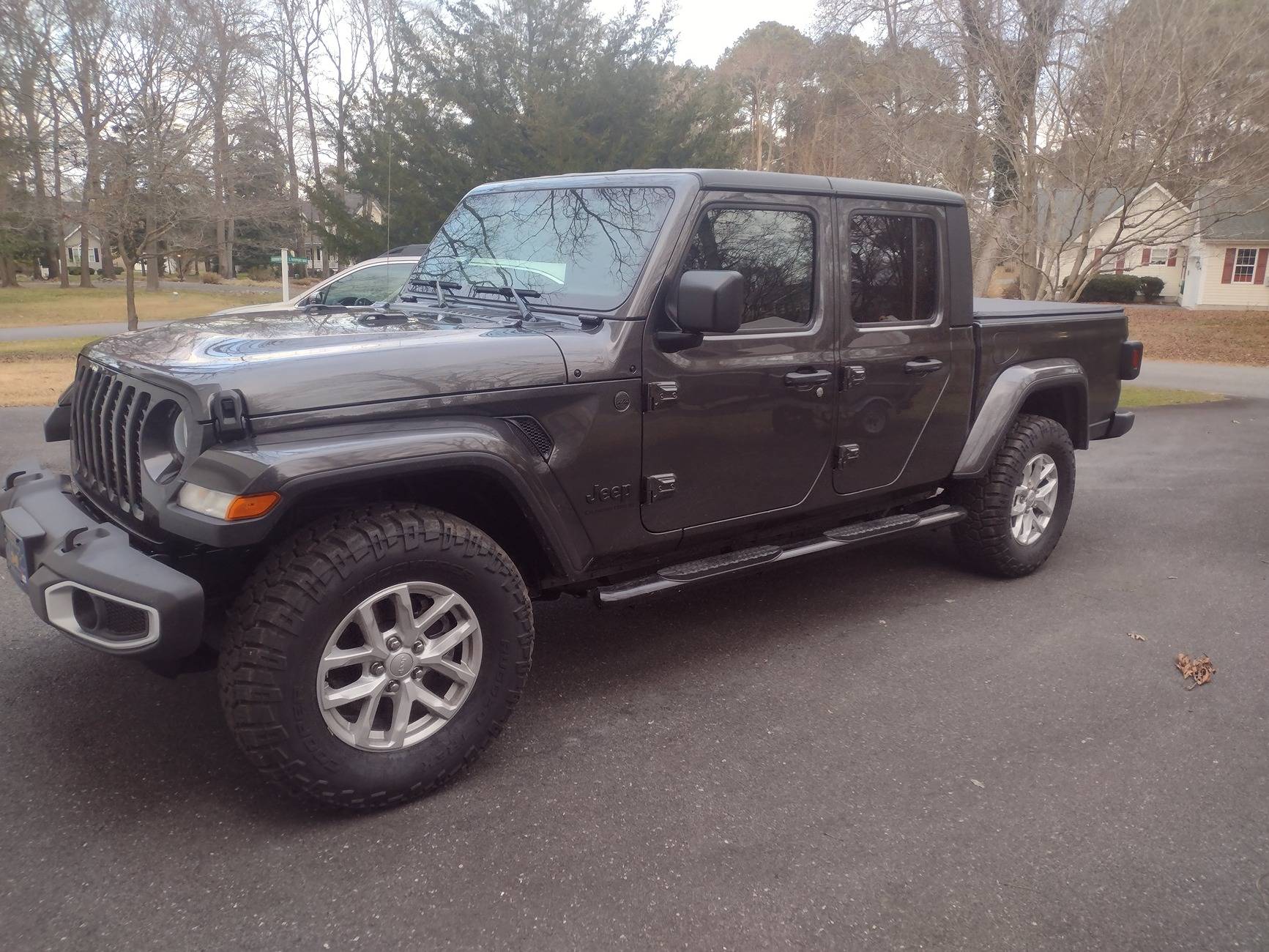

I bought a Sport S and changed tires in the first 600 miles to Cooper Rugged Trek (https://www.tirerack.com/survey/Sur...eMake=Cooper&tireModel=Discoverer+Rugged+Trek.) I went up in size to 285/70/17 without any regrets. Mileage stayed the same (no highway driving here at the beaches in Delaware) and the road noise is minimal, again, no highway driving. They are great on the beach and look a lot better than the stock Bridgestones. I did sell the Brigestones easily and got $400 for them to offset the new tire costs
Jeep Gladiator All Terrain tires vs "Highway Terrain" tires IMG_20231224_155029454 (2)
