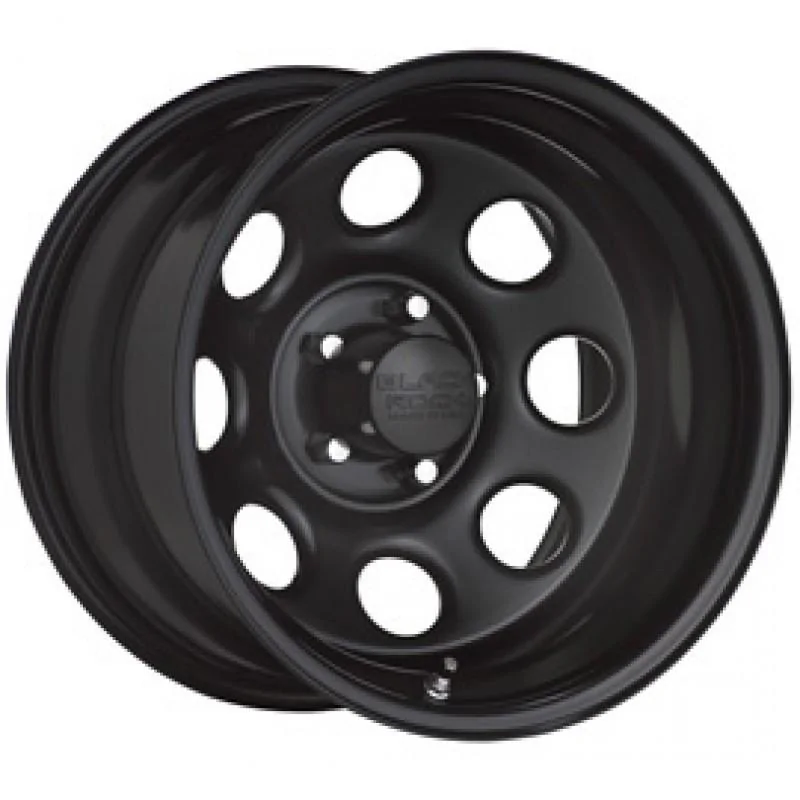

Some like this are what I'm looking at. A few brands make ones similar to this. Black Rock and Pro Comp are the two I've narrowed it down to just because I like their center caps better than other brands. Really want just all black including center caps. What crazy is you have to buy the center caps separately, which seems like a money gimmick looks like they want $30 to $40 a piece for the center caps.

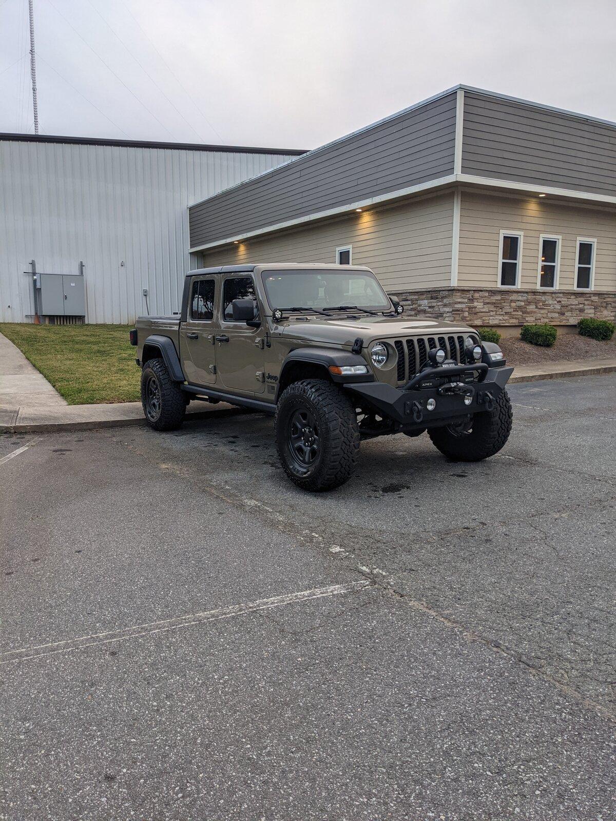

I'm running the stock black steelies now. Looking at other wheels now because the stud got broke off one of my spacers and I'm between if I want to buy another spacer it just get new wheels. You make a good point about being able straighten one out with a hammer This is mine right now and the wheels I'm ruining which are stock

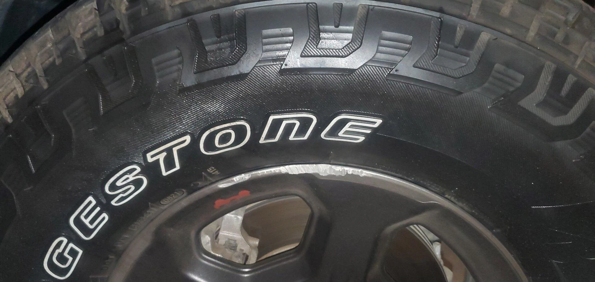

I'm not worried about cracking a wheel, but I'm not a hardcore off-roader. I just like hitting the trails about once every couple of months. The reason I was at one point looking at steel wheels is because I'm still not great at picking lines. I figure, the image below would have made me a lot less upset on an $80-100 steel wheel than on an alloy. Unfortunately, the offset on all the steel wheels i have come across is ridiculous. I can't have the tires stick out around here. But I did this getting my first badge of honor, so I'll wear it with pride. Right now, it's on the passenger side, and the badge is on the driver side, so it's kind of like having an extra badge.
