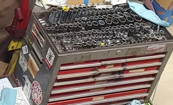

I have so many sockets they won't all fit in my tool chests.
I have a quarter inch drive, 2 half inch drive and 2 three-eighths inch drive. Come to think if it I may have 3 half-inch drive torque wrenches.
Engine and transmission building, differential rebuilds, they are absolutely necessary.
(these are about half of the sockets I have....)
Are you bragging or confessing to your vice:LOL:
