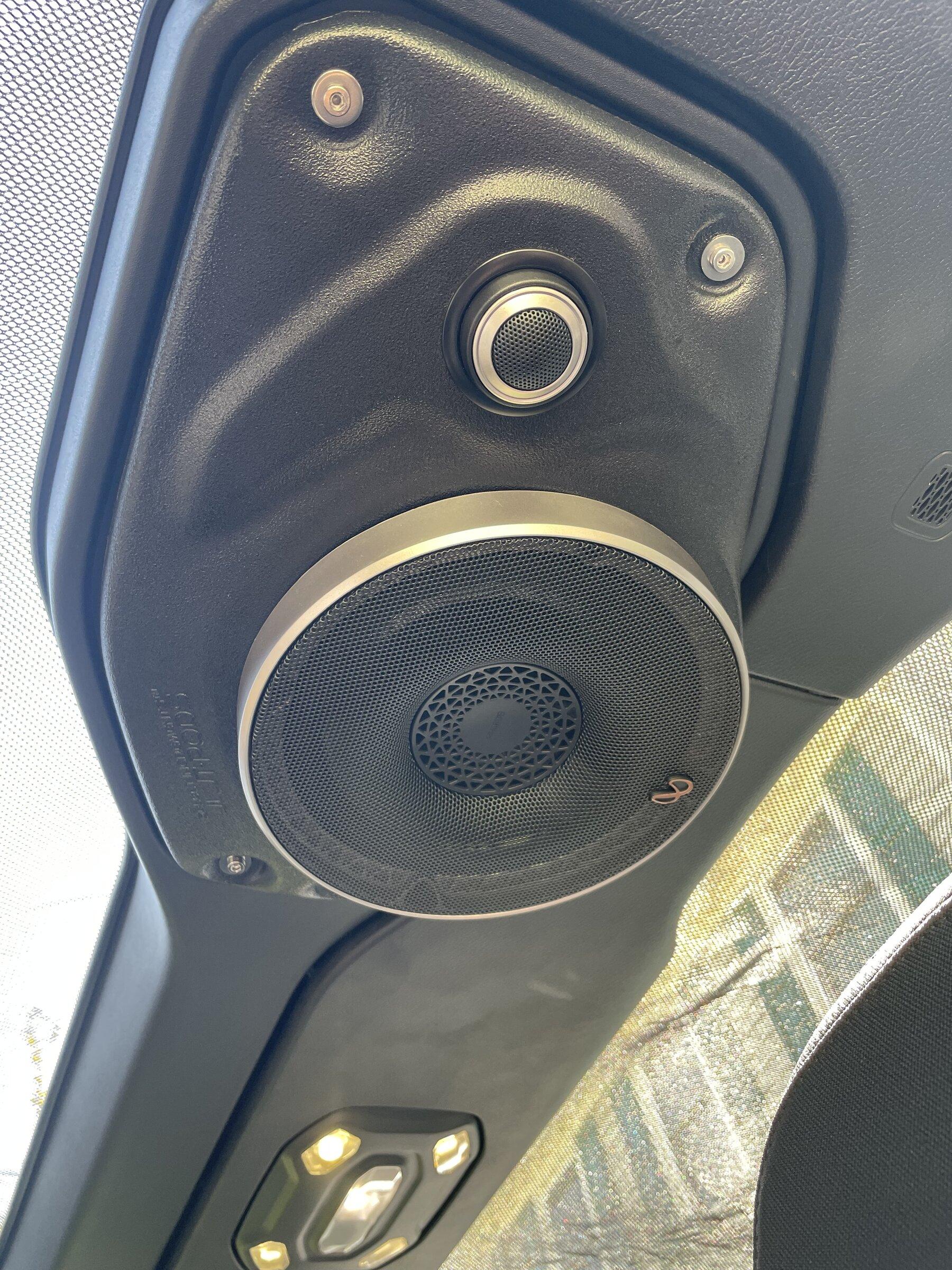

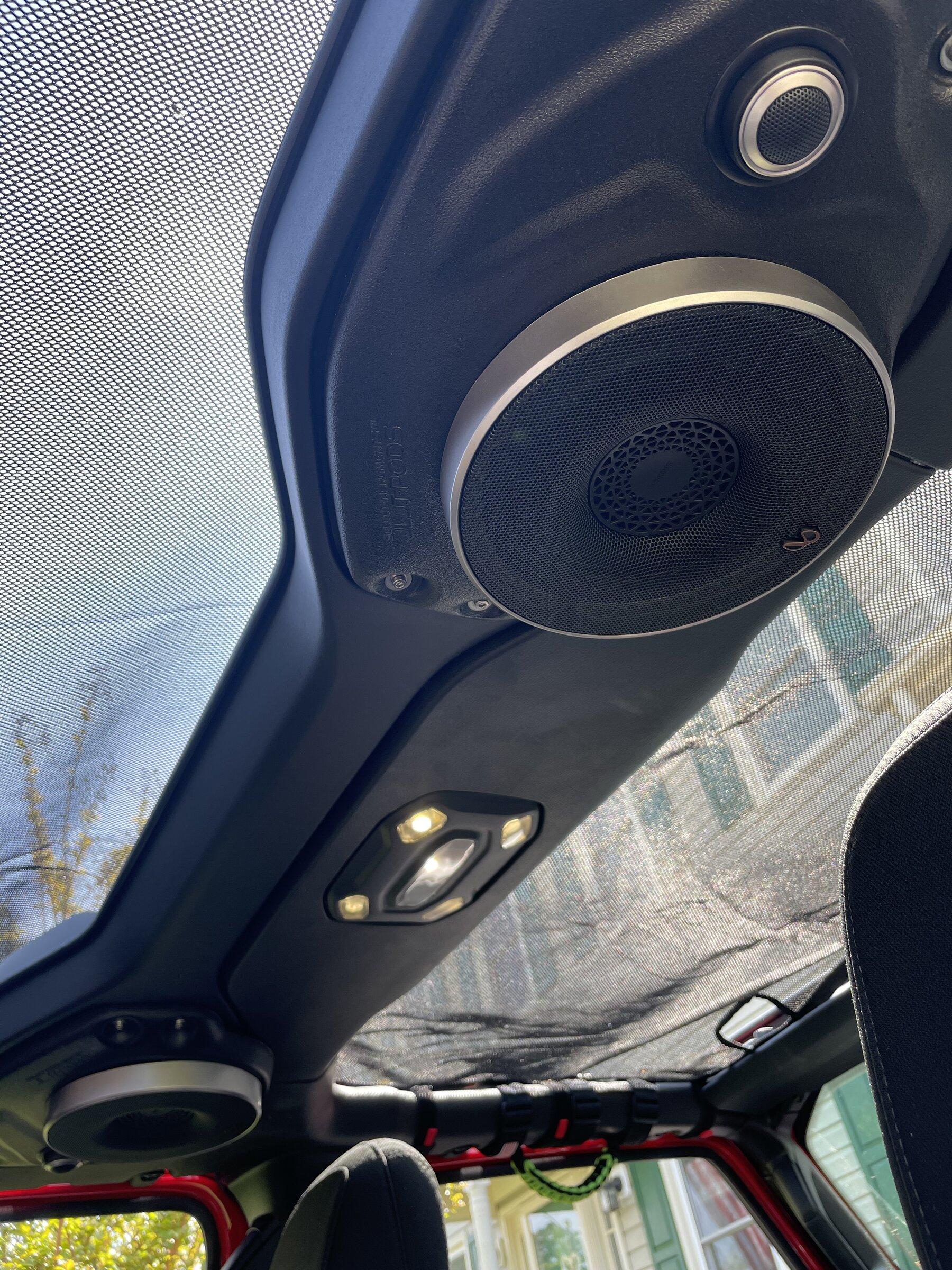

Was on the fence considering the low power of the factory amp. I went with the select increments pods, infinity primus components, and the reference 3020 3.5” in the dash. Left the knee panels alone for now. Worth the time and money especially if you plan to upgrade the amp down the road. The infinity speakers are a bit lower than 4 ohm so I still get good volume at maybe 20w hitting the speakers. Sounds great for now on the stock amp!

There is a chance that your amp will probably shut the sound bar down in about a week. I had a set of Ref6530's and had it happen to my JLUR with the factory Alpine. The amp didn't seem to like the 3 ohm load off the tweeter in that corner but is ok with the 3032's in the dash. According to what I have found those are 2.7 ohms. Hope I am wrong.

That’ll accelerate my amp upgrade timeline a bit then if so!

I have had the infinity 6530s and have had no issues.

How do these compare to stock Alpine sound bar units? Do these hit lower or is it the clarity that you are looking for?

I noticed the bass more specific from the sub vice the entire sound field...but that was replaced with clarity in the rear. Stock soundbar speakers didn't put out much volume, and definitely no highs. Felt like the soundbar/sub were tuned for just bass...loose crappy bass. I can certainly hear them now! About to head out for a ride with the top off and see how it goes with the volume up.

Sounded great with the top off and volume around 25. With the stock speakers I had to keep bass at -2. Dialed it up to +2 and had okay bass from the factory sub/amp. Overall a much better experience than stock, can only imagine how it'll sound with a proper amp getting 50w RMS or so.

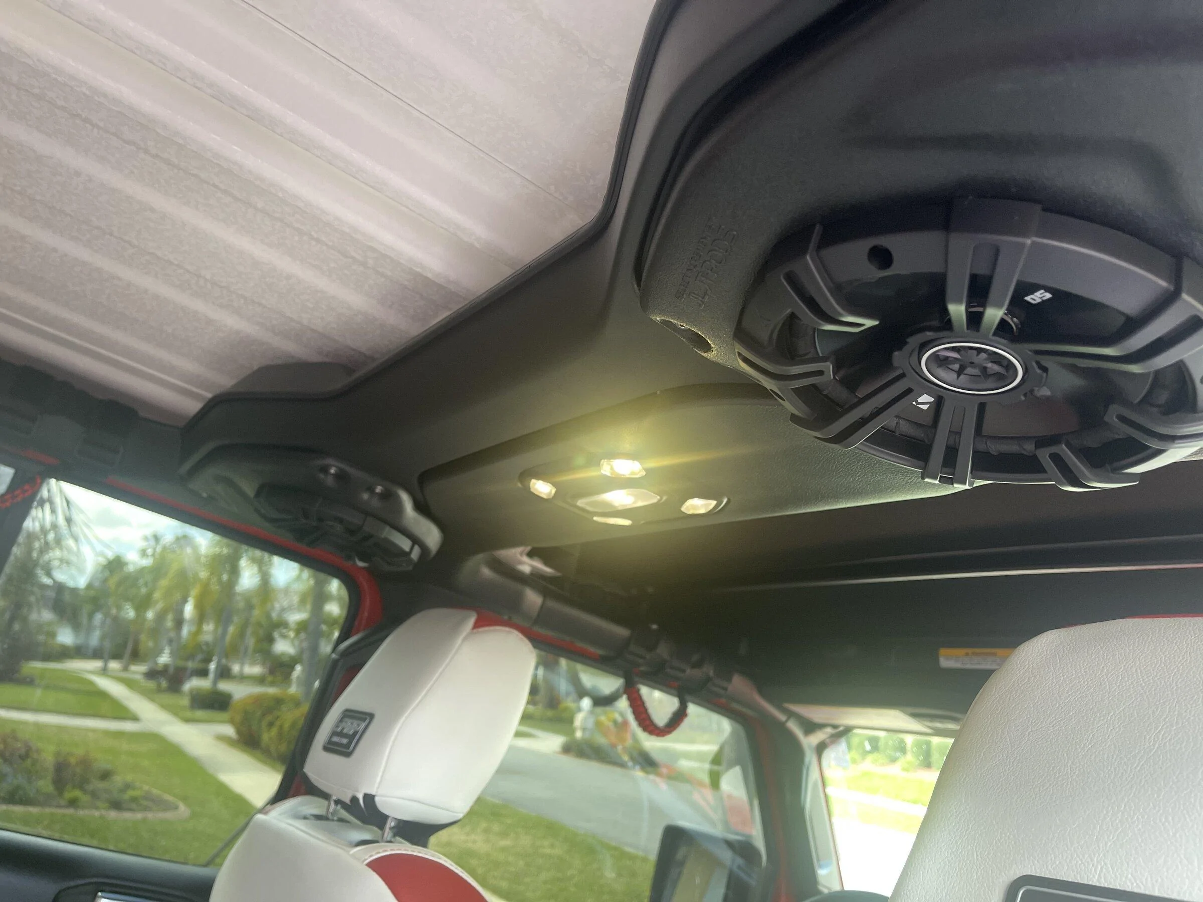

I don’t have the alpine system but upgraded from the stock speakers to the Select speaker pods with the kicker speakers. Def an upgrade. And honestly for the cost, regardless of OEM system it’s an easy and affordable upgrade. Plus the housings will work with any 6.5” or 6.75” speaker.

That’s what I plan on doing, I have the premium Alpine, interested to see how big a difference these make coming from that.

It's worth it. And if you decide to add an amp down the road, you've already got speakers there!
