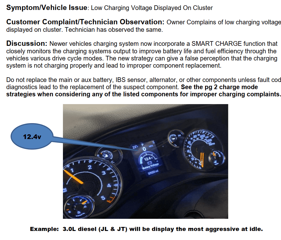

No, that's not relatively low.
Depending, these will go as low a upper 12s. Mine has gone 12.7.
There's a TSB on this telling people it's NORMAL.
These control alternator output based on need. These are not regulated like the old day to a set voltage.
As long as your voltage is actually fluctuating like that, it's likely fine.
Not sure where you found the "relatively low for a new vehicle".

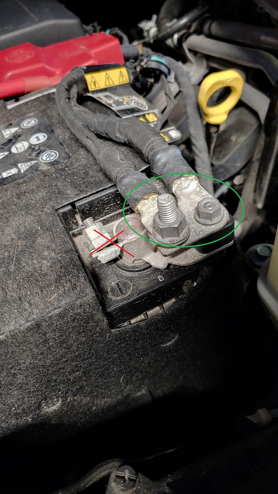

Anything you add to the Jeep, make sure the ground comes from either the body ground studs or the top of the IBS - never charge directly to the negative battery post, never pull directly from the post.
This is normal if the system finds the batteries at capacity and the electrical load needs are low. It's to cut power robbing charging when it's not needed.
In the past the alternator was a parasite even when not needed.

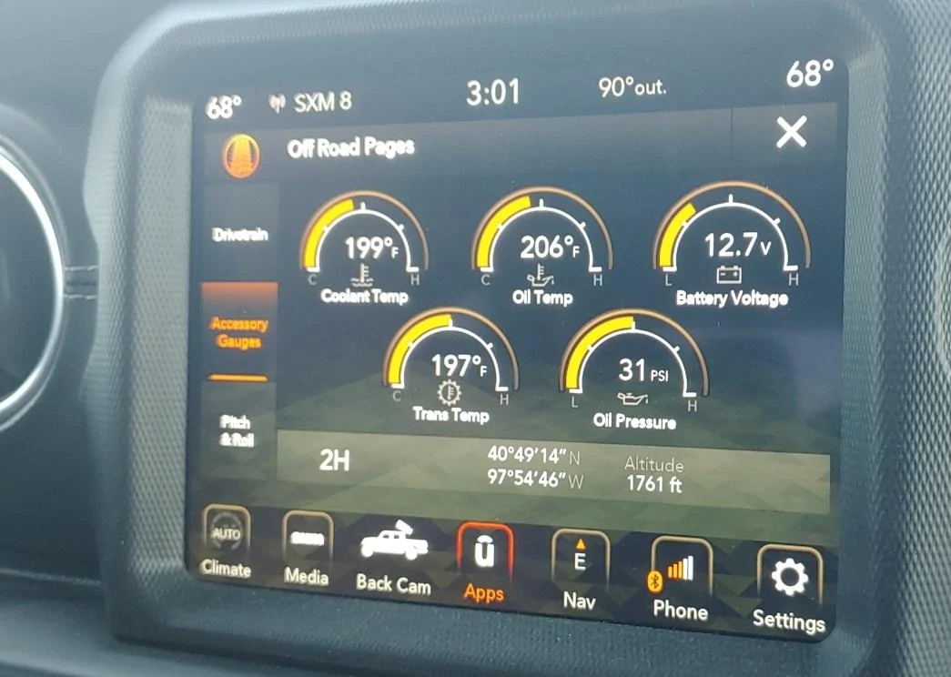

Cut parasitic draw of an alternator that's not needed at that time, vary output based on need and load more than regulating to a set voltage no matter what.
When mine first showed 12.7, or rather when I first saw it at 12.7, I noticed we were tooling down the interstate at about 80 so cooling fans weren't really needed, it was NE so there was almost nothing for hills, it was daytime so no lighting load, etc.

I’ll triple check but the only thing I have connected to the negative post of the battery is the winch. Everything else is on those studs on the body near the battery.
Should I move that winch wire to those posts?

The idea is to take negative not from the negative post itself, but from above the IBS, or a body connection.
I have my winch negative on the stud on top of the IBS.

I posted the bulletin above in another post in this thread.
I was coming back from Colorado Springs when I first noticed mine at 12.7 volts.
Jeep Gladiator Alternator or battery? 1653180181155
Oh oh gotcha. Yeah I’m pretty sure I have that set up properly but I’ll check again tomorrow morning.

Yeah, it sure is.
I'd not sweat it as long as things are working.
