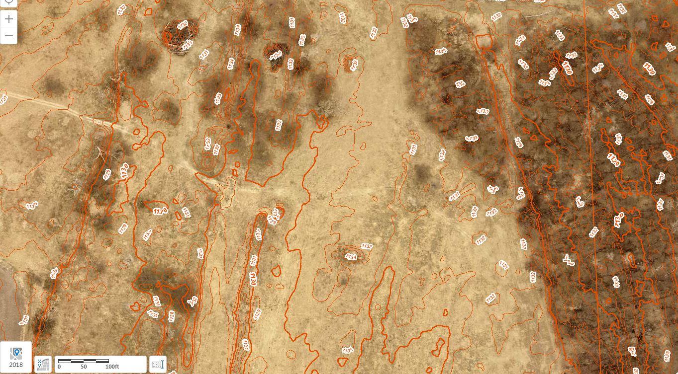

I think you'd be surprised how accurate the topos are that are available. More and more counties are putting that information online via a Geographic Information System (GIS). Here's a random bit of field and trees from the Douglas County GIS with 1' elevation lines. Not saying that's how the Gladiator gets it's elevation data, but that information is available.

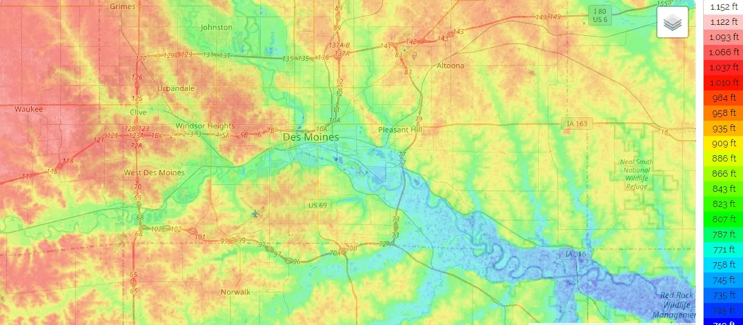

Yes - Those red lines- VERY close together for my area ;-)
Digging into current info, they do have things mapped out pretty well, but where I live, the Jeep was showing elevation changes extremely fast and accurate. So not sure what they are using, my bet - GPS as it's been extremely accurate in this Jeep.
