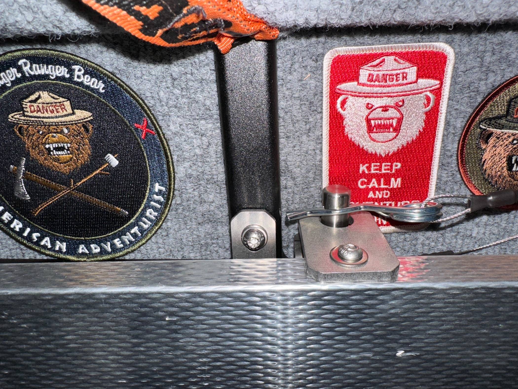

Got a couple of small but important projects done today. Installed an 813 Designs table mount under the bed to hold the Alu-Cab table securely out of the way yet way to get to once we make camp. It was an easy install and my first opportunity to use a rivnut tool to attach the mounting brackets to the lifting bed frame.

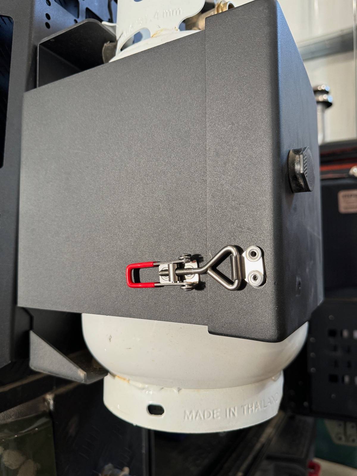

And I replaced the push button locking pin on the propane mount with a toggle latch clamp. The pin kept wiggling loose. Expedition Essentials switched to this type of latch recently but this is an older model. I found one on Amazon and it seems much more secure. I tried to use the existing hole from the old mount, which was a mistake as the hole was too large. It holds but resulted in a bit of a crooked mount. Live and learn.
Looks great! Glad the table mount worked out for you.

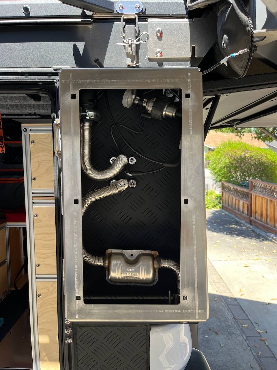

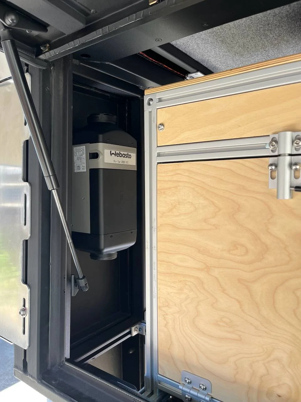

Just in case this is interesting for folks here:
Jeep Gladiator Alu-Cab Canopy Camper Roll Call IMG_6463
Jeep Gladiator Alu-Cab Canopy Camper Roll Call IMG_6461
Jeep Gladiator Alu-Cab Canopy Camper Roll Call IMG_6464
Notes:
  • We did not add any additional layer to the relatively thin aluminium skin of the camper. But I did design a brace the heater will sit on that attaches to the inside extrusions and has a hole for the heater outlet to go through and then sit on top of the metal. So, this should be solid enough. If this doesn't feel good when assembled, I will add a full on internal brace for the mounting points.
  • There is a lot of air in the box that replaces the passenger side molle panel. We had the choice of using an internal tank there or include the silencer directly in the housing and went with the silencer - just less fuzzing around when using the camper and wanting the silencer in place. Also, there is still the option of going to the vehicle tank.
  • Exhaust exits at the diagonally opposite corner to the air intake. Air intake also has a silencer attached.
  • All recommendations regarding mounting where followed. The Webasto Air Top is okay with this mounting according to the manual.
  • The box will get powdercoated in the next few days, we left it raw to drill all the mounting and pass through holes once the positions were figured out and tested.
And now I have a right side molle panel I can't use and probably will sell at some point in the future.
