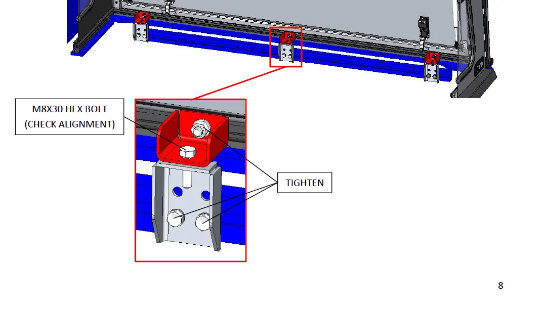

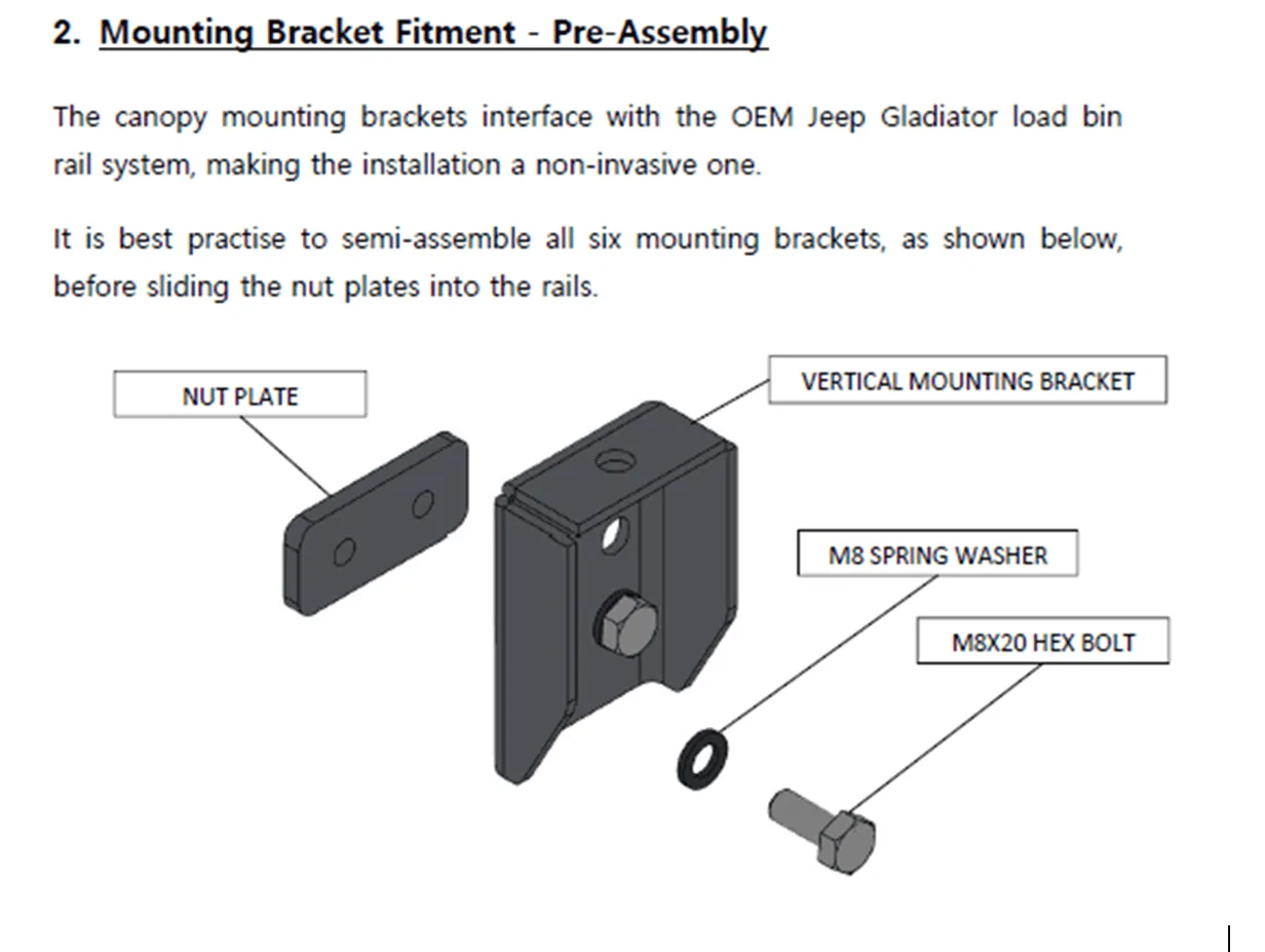

@LifesaverJT, who installed your canopy? Did it come with "d-rubber that you had to secure to the bed rails, or was this rubber on the canopy rails, and that sits on the bed rails?
I asked the dealer for the install directions, he said they don't have them for the JT, but do for the Tacoma, and its virtually the same......at 6 pages, it was not complete in my opinion, but i checked their site......that's the manual they give. They mention items needed, "turpentine, cloth, black sealant, silicone or sikaflex, window cleaner" But then don't mention them again. So I don't know if you're supposed to glue this thing down with the sealant, or if the sealant glues the D-rubber down..... D-Rubber is also not listed under tools nor items needed........Wish I bought an RSI.....JUST KIDDING!!! :CWL:
Sometimes you gotta go straight to the manufacturer cuz the dealer doesn't know. I got the Gladiator Install instructions. LOOKS SIMPLE.....not confusing like the 2016 Tacoma directions at all. Alu-Cab must have upgraded to Windows 10 Translate, lmao.
I like the colored diagrams and very detailed instructions on the shimming process. So glad I didn't change my order to an RSI....:CWL:

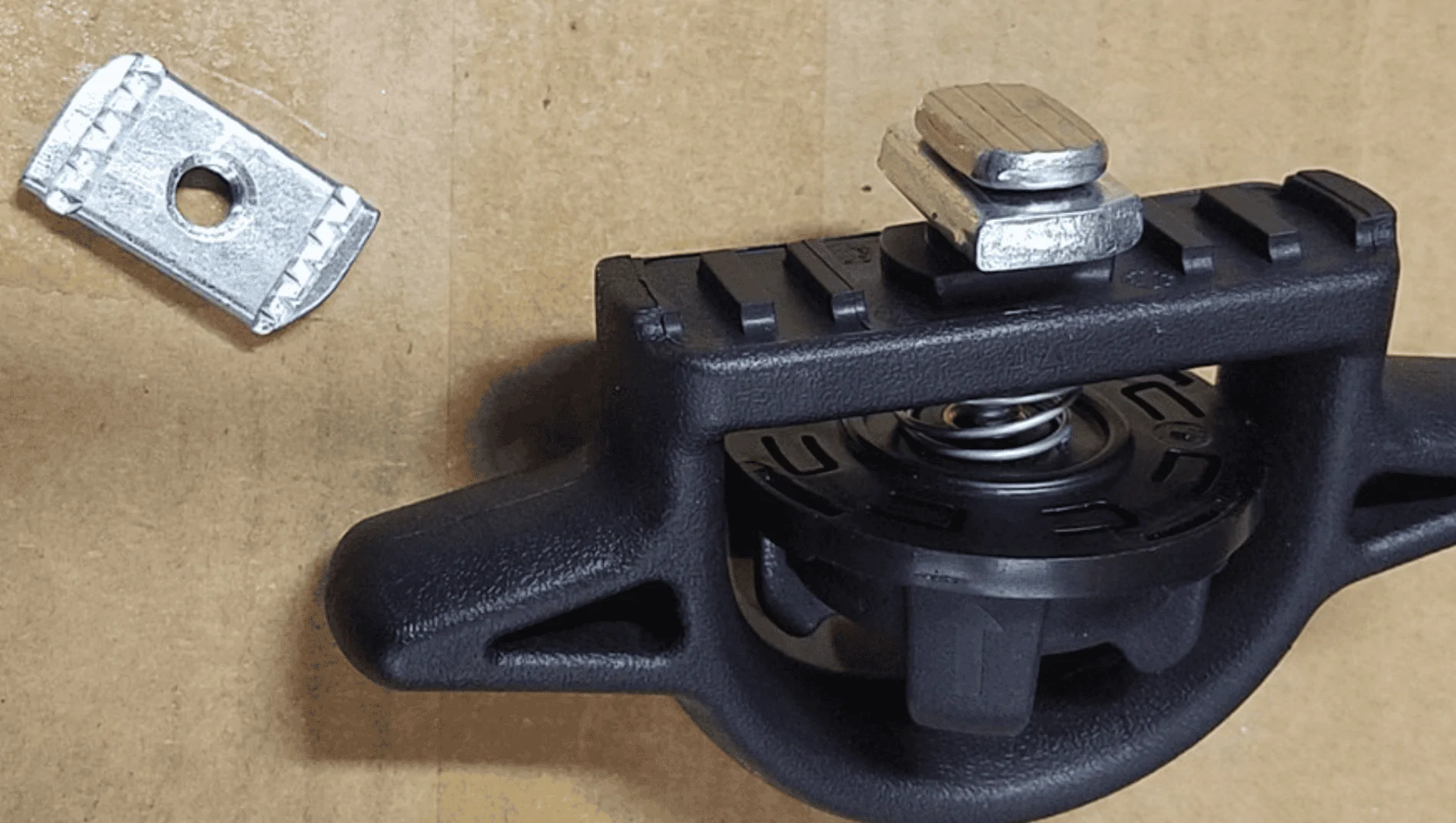

ohh, wanted to ad one more thing from my post a while back
What did you do TO your Gladiator today?
I had to modify the toyota tie down because it was pulling out of my rail, so I ended up getting a specific thread m8 strut nut that fits the RSI rail.
Jeep Gladiator Alu-cab canopy Jeep Gladiator #001 upload_2019-11-29_21-28-14-png
I plan to do the same thing with the Alu-Cab nut plate seen below, Thread 2 strut nuts onto the bolt right in front of the nut plate so the teeth of the strut nut bite into the rail.

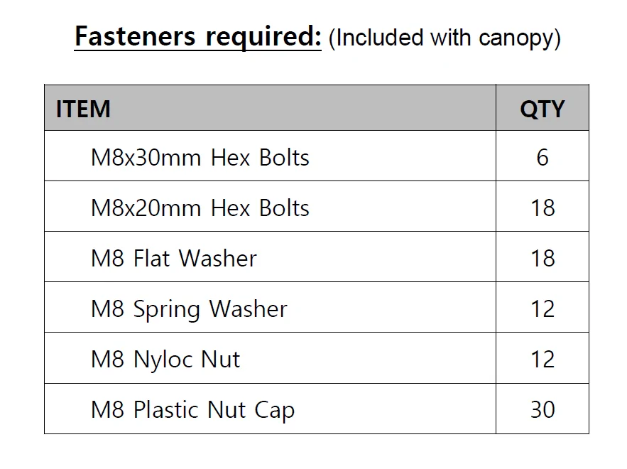

When the directions only say M8 hex bolts, what thread pitch do you suppose they use?
@LifesaverJT, do you know? If you want to be the coolest Alu-Cab owner EVER and want to take one of the 12 bolts out and check it on a thread gauge at your local big box or hardware store, I would thank you. lol
I've seen M8x1.25 pitch and also M8x6mm for unistrut nuts on amazon, suppose I could just buy a set of both.
I'm sorry, i'm all over the place. What would you guys do if you didn't have the mopar rail.
  1. use 2 strut nuts in place of the nut plate.
  2. drill out 2 nut struts so the bolt passes through and sandwich the nut strut between the nut plate and the rail?
8 x 1.25

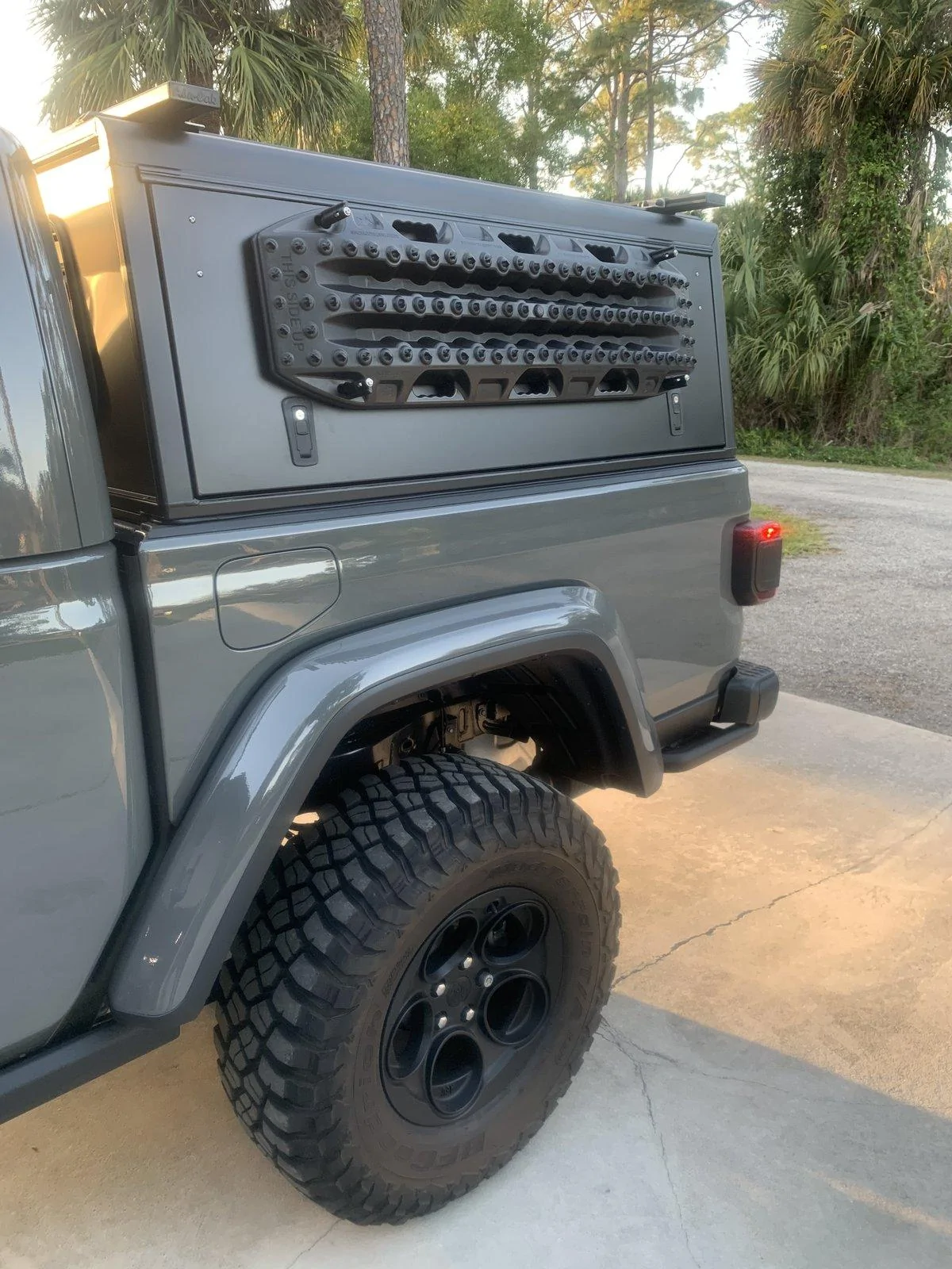

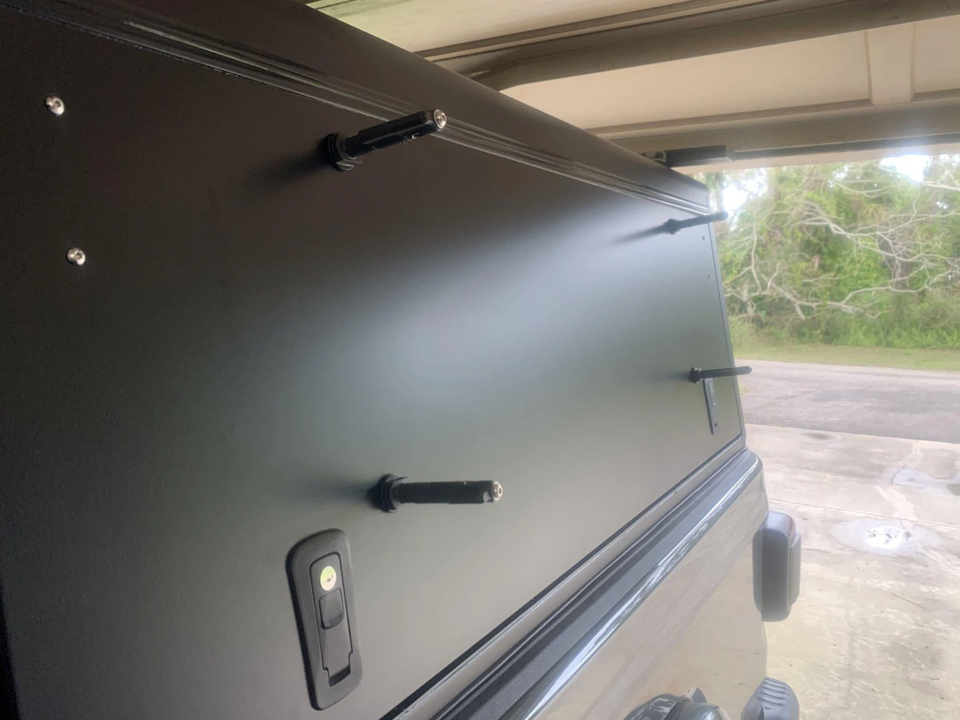

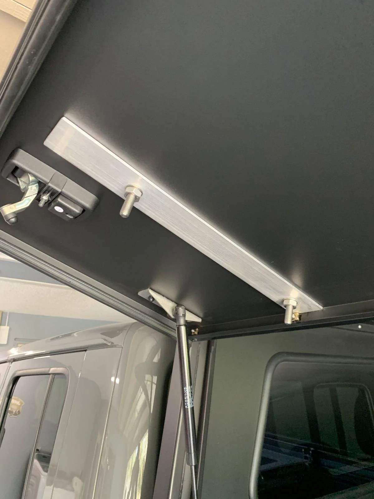

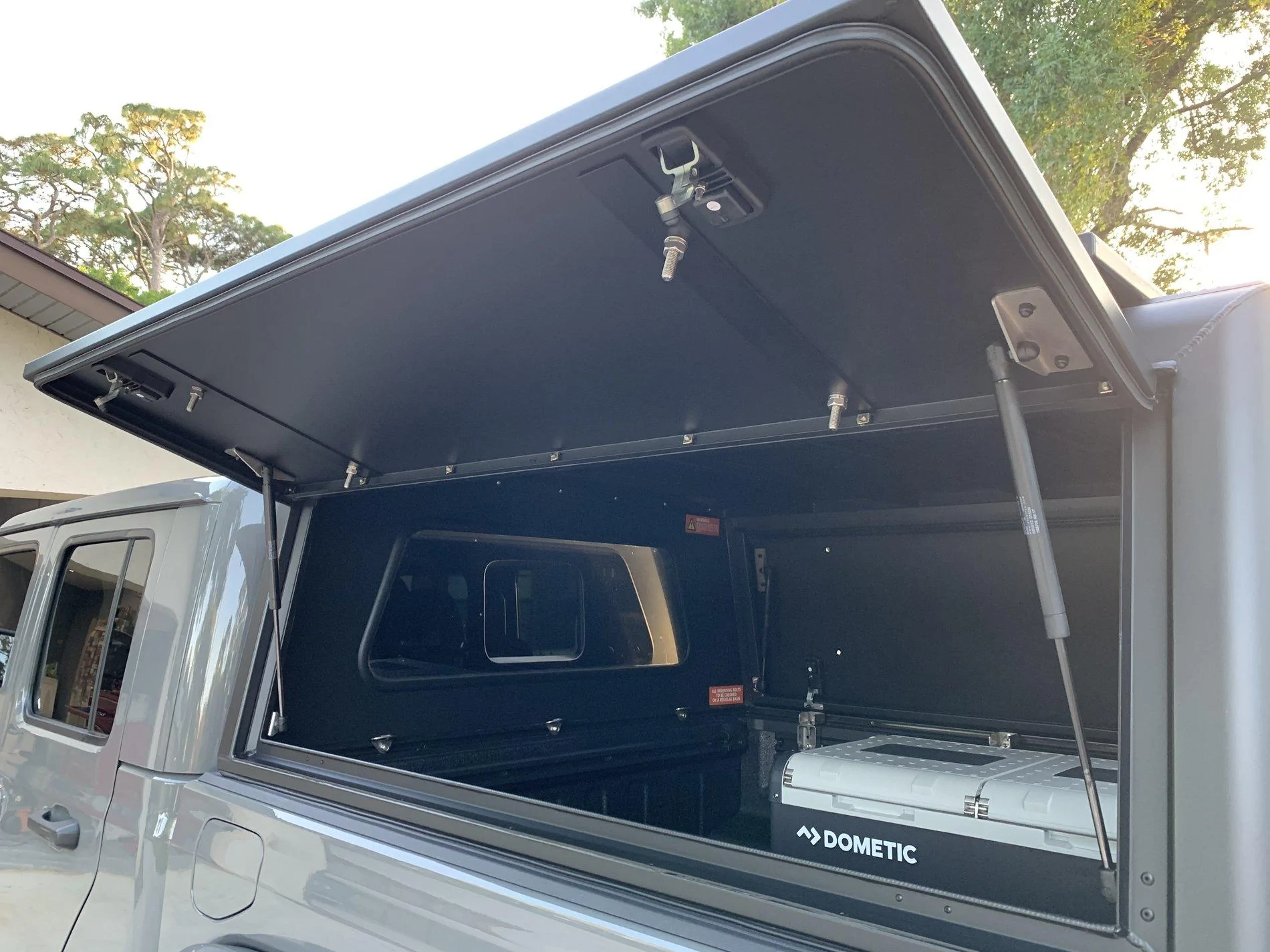

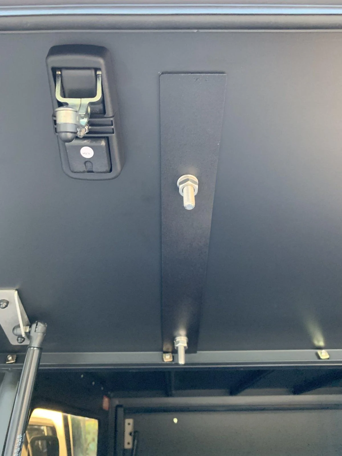

Well I got the maxtrax mounted two on each door. I used 2”x16”x 1/8” aluminum flat bar as a backing plate and primed and texture painted them. I used the maxtrax pins and am very happy with the results
Jeep Gladiator Alu-cab canopy Jeep Gladiator #001 8D51F4BE-3DBA-4A99-92A8-2F836EF41696
Jeep Gladiator Alu-cab canopy Jeep Gladiator #001 78A7F895-E229-4FD9-AC83-1A3129C4ED78
Jeep Gladiator Alu-cab canopy Jeep Gladiator #001 E6424D77-AB46-4E59-8283-DC3A4CA8A3B4
Jeep Gladiator Alu-cab canopy Jeep Gladiator #001 189589DC-42DD-4FCC-ADAA-84BC147DCB63
Jeep Gladiator Alu-cab canopy Jeep Gladiator #001 8FD79373-DF3B-42D0-BEB1-1F6CE4F1AEBF
Jeep Gladiator Alu-cab canopy Jeep Gladiator #001 111C9A2F-07C2-4D54-B07B-9CEFF634DAB3
