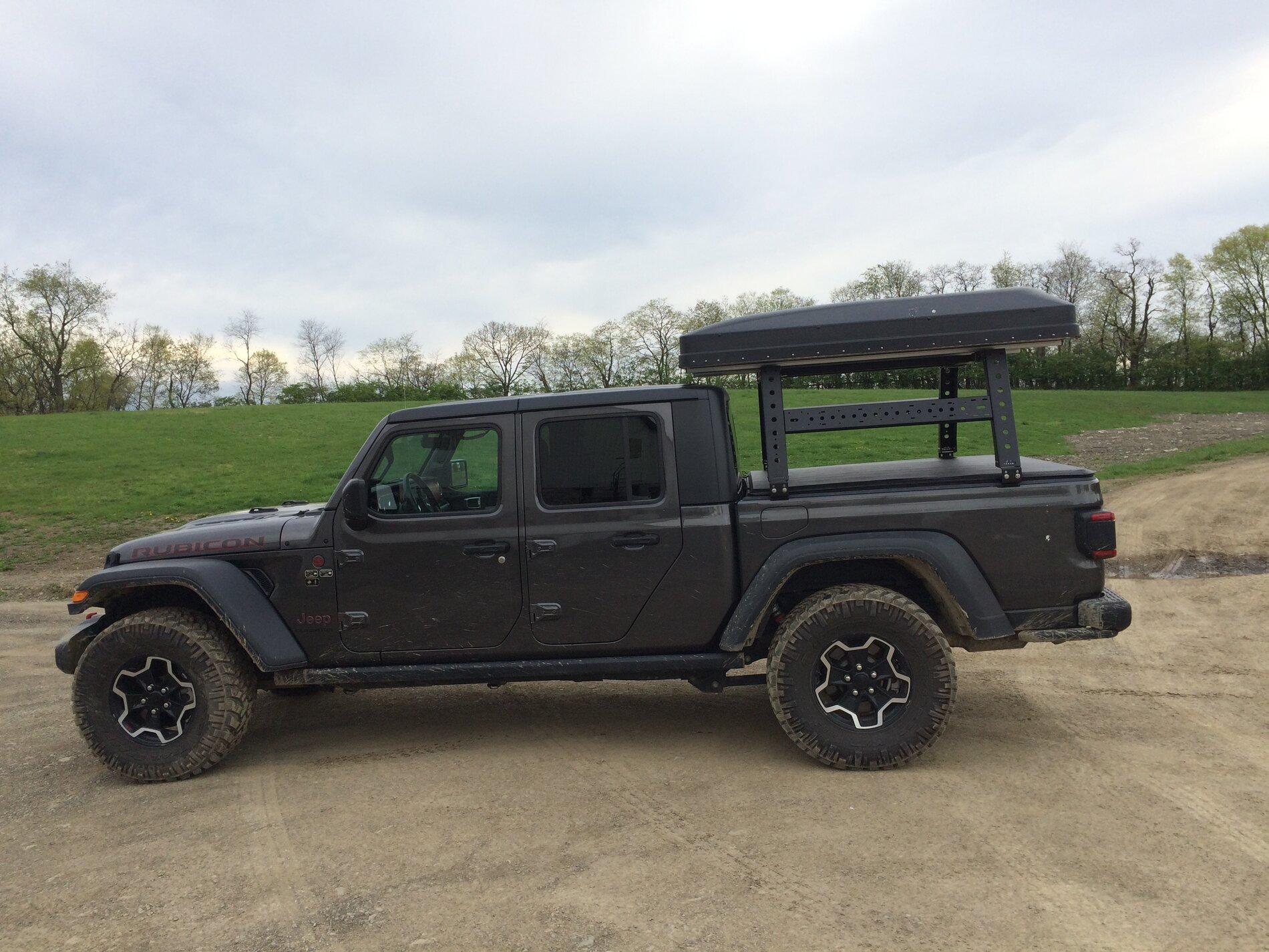

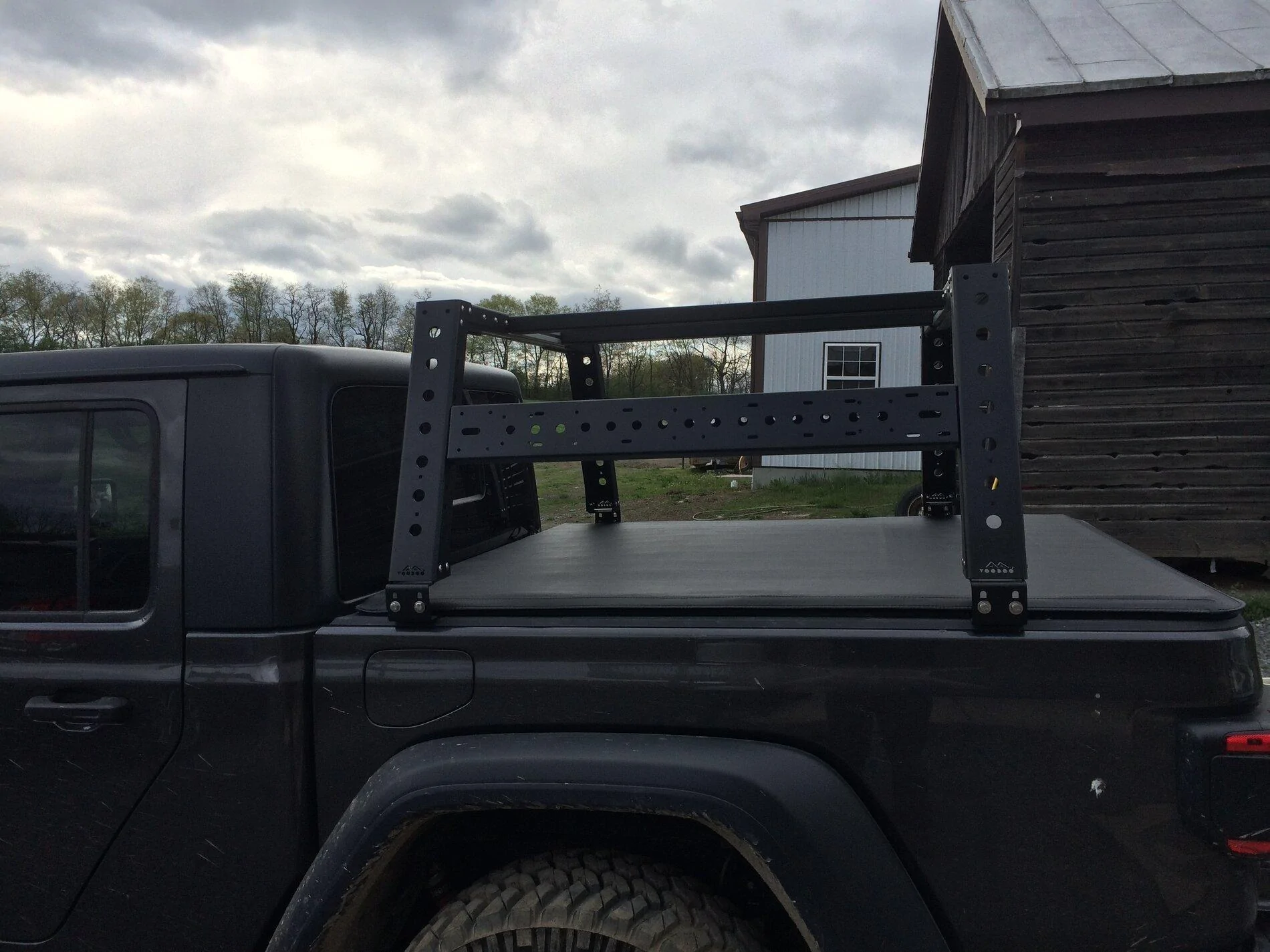

KB Voodoo Max Modular Alumax rack, 22" tall, 47" long with tonneau cover brackets. Puts my RTT about an inch and a half above my hardtop. I also bought the cheapo Amazon tonneau cover for a Colorado for $160 and 'Bob's you uncle'!
Voodoo Fabrications was super to deal with. I had a couple of specific questions that they answered in a day. Product was shipped within 3 days and arrived in perfect condition.
Looking back on it, I bet that using their 'factory Mopar tonneau brackets' would allow use of their 58" long rack.
Their top bars fall too narrow for my RTT so I flipped them upside down to make it easier to mount crap to the top on the inside. The 60lb rack, 160lb tent and tonneau dropped the rear end 1.25" stock suspension, 35's.

Looks great! I'm considering the same rack to carry two 14ft kayaks partially over the cab and a little past the tailgate. I would use it part time with the Tonneau cover and sometimes not without the Tonneau brackets. Can you verify the rack will still sit above the cab without the Tonneau brackets?

The tonneau brackets add 2.5" to the height.
