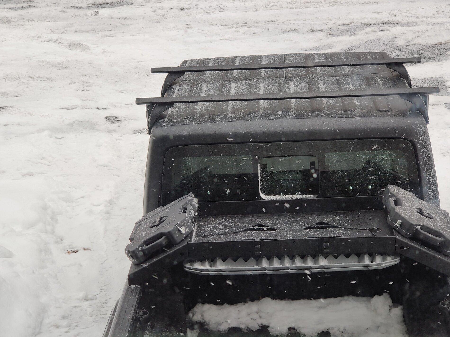

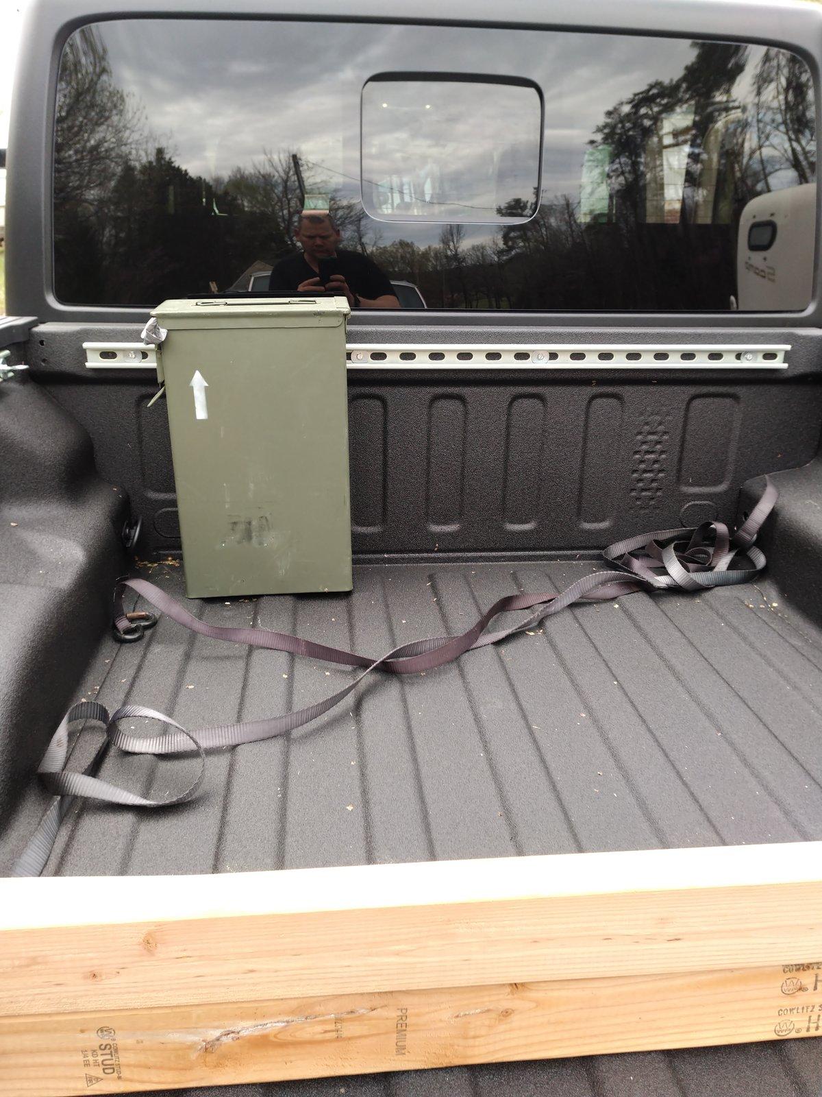

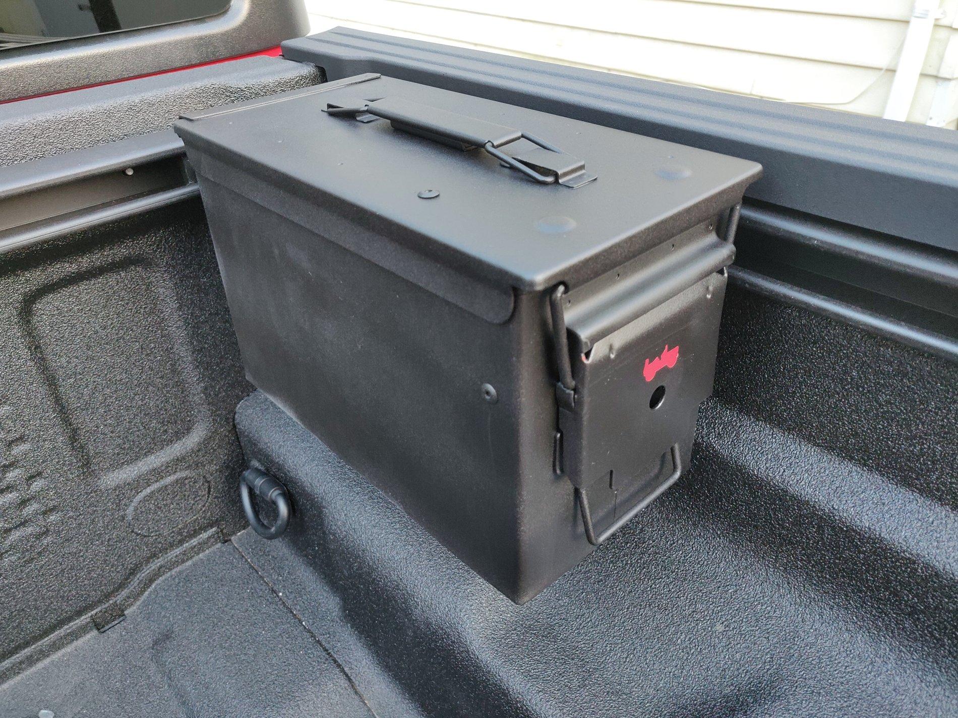

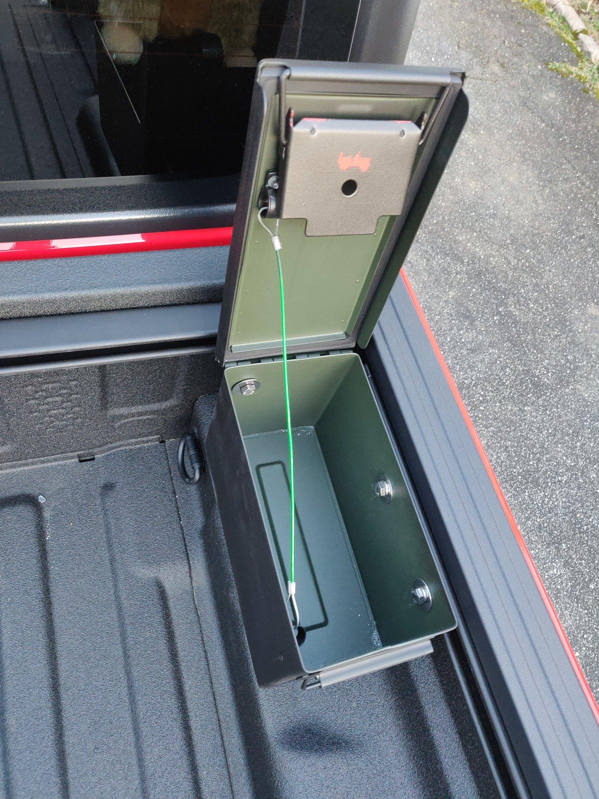

I made my own bedrails (another thread) and attached this ammo box to hold my ratchet straps and gloves.
  • I used a Harbor Freight box because its lid has a straight overhang. All of the real ammo boxes that I have, have an angled overhang on the lid.
  • I riveted on some wire rope to prevent it from opening into the window.
  • I put a piece of white polyethylene (painted black) between the box and the rail, so the box can open / close. I am going to replace this with a black piece since nothing sticks to polyethylene.
  • I put a magnet under the handle to stop it from rattling.
  • I am going to re-paint soon. Not happy with the finish.
  • Will be putting a lock on it next week.
When I get my hard folding tonneau, I am going to have to rethink this. But I probably wont get it for another few months.

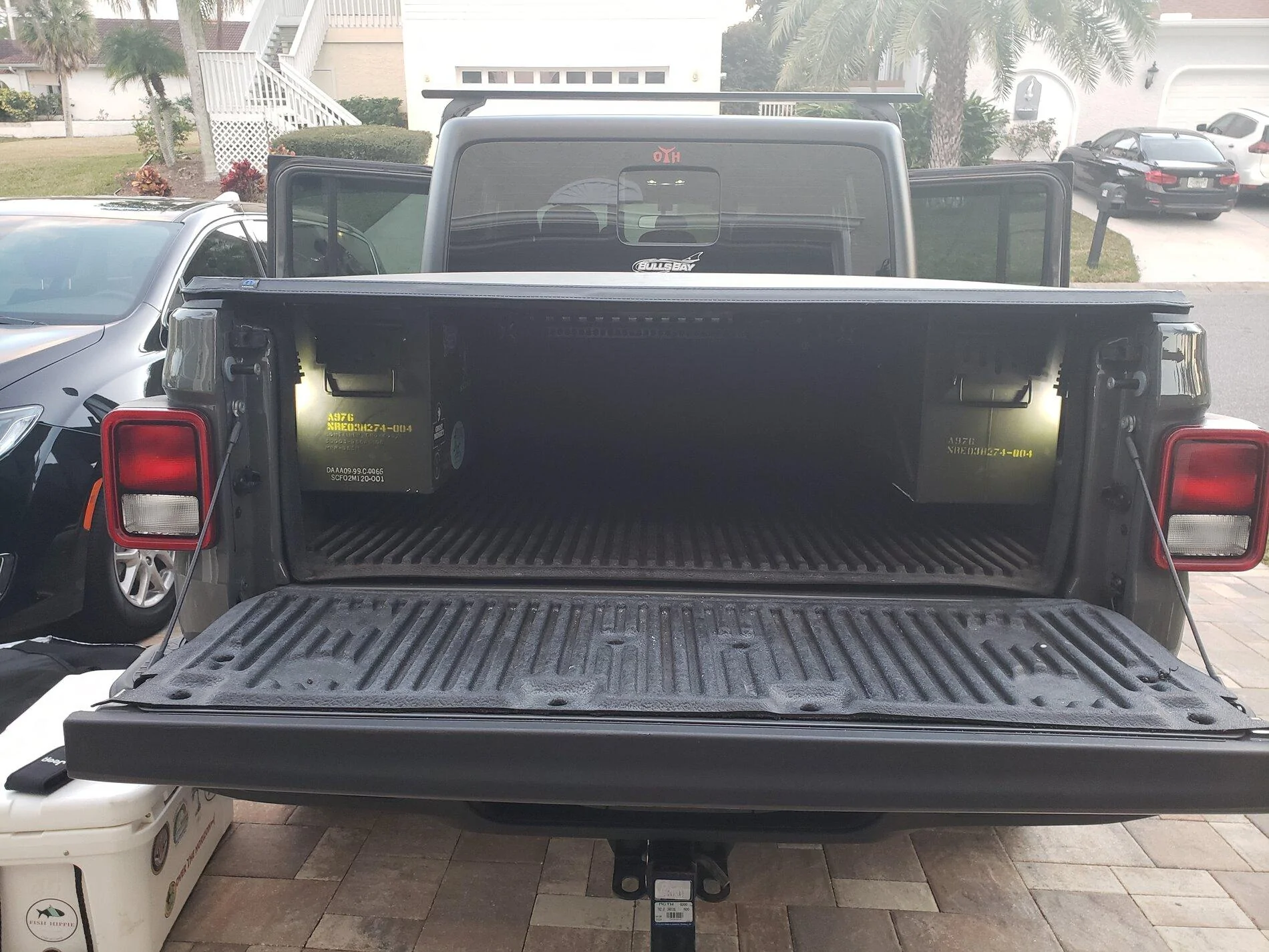

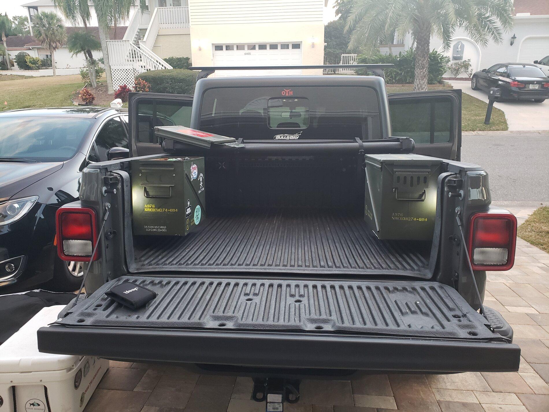

Jeep Gladiator Ammo Box Bed Accessory IMG_20200322_153957

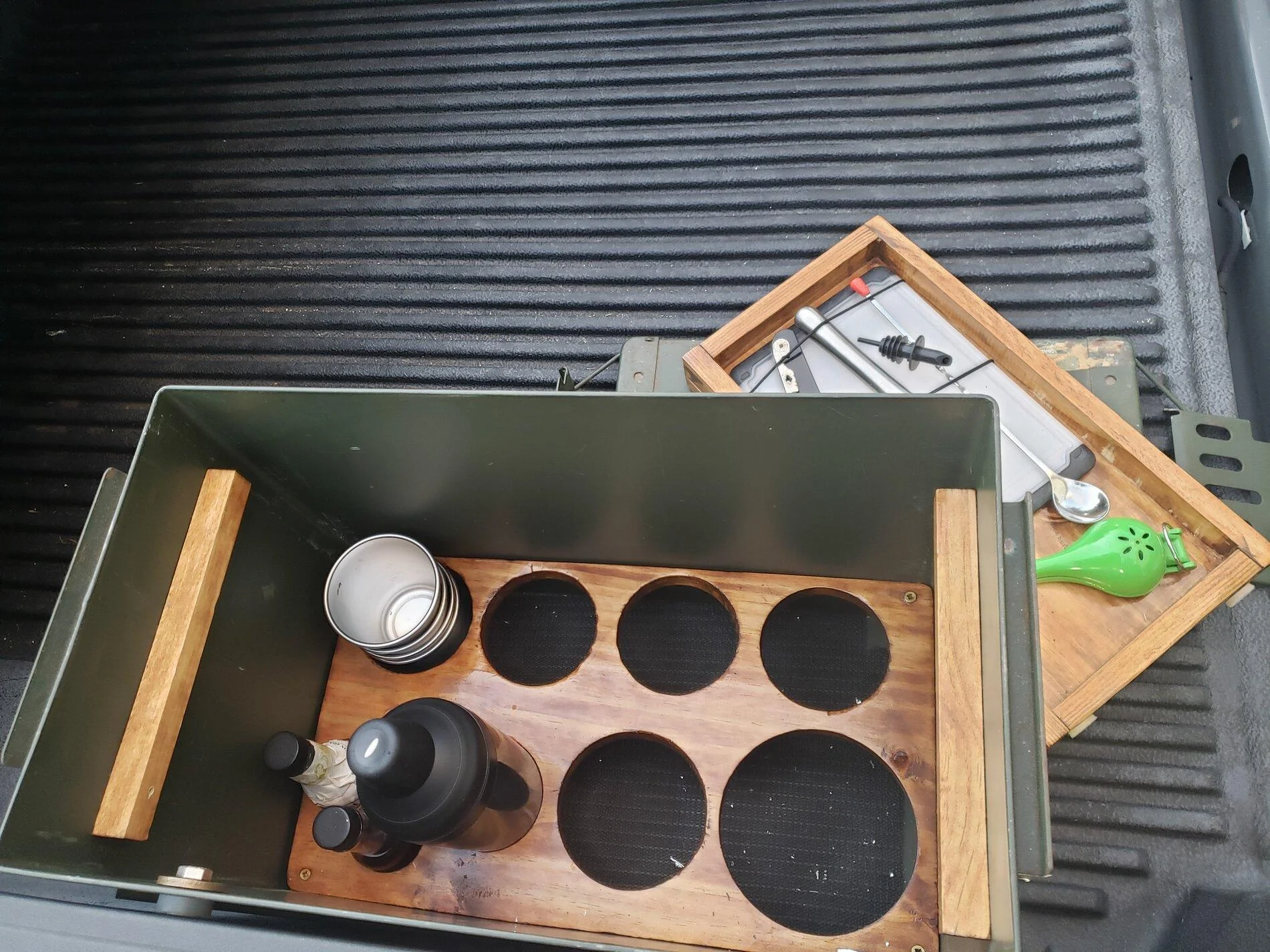

If you can, I'd just make an extended bracket to drop the can down some to get the clearance you need. Also, nice work on your rail system. I was thinking about just adding a couple extra anchors, buy I might do a rail system like yours now. I've also got some random ammo cans laying around that would make a good storage solution. Got a couple fat 50s and a couple 40mm cans.

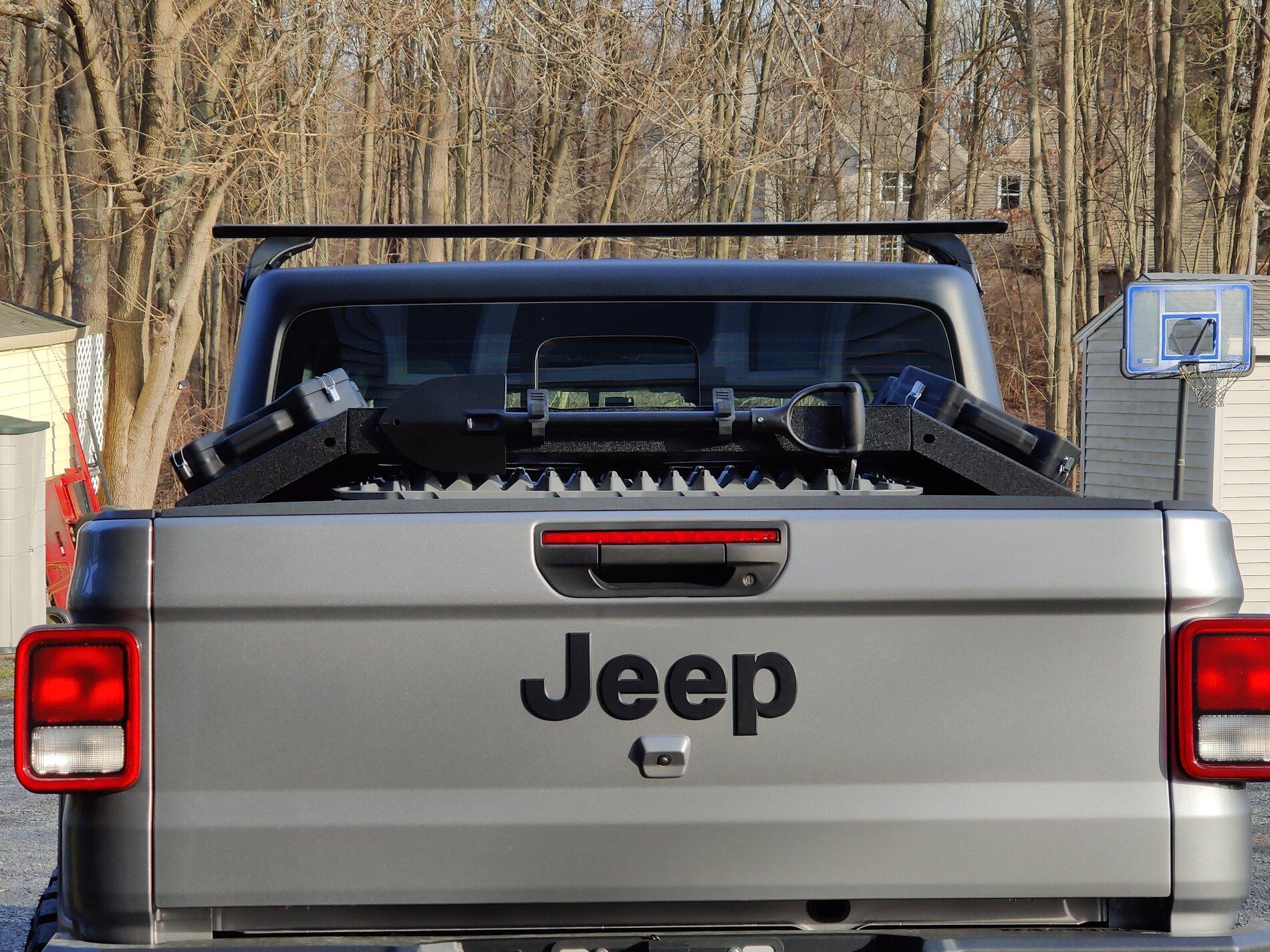

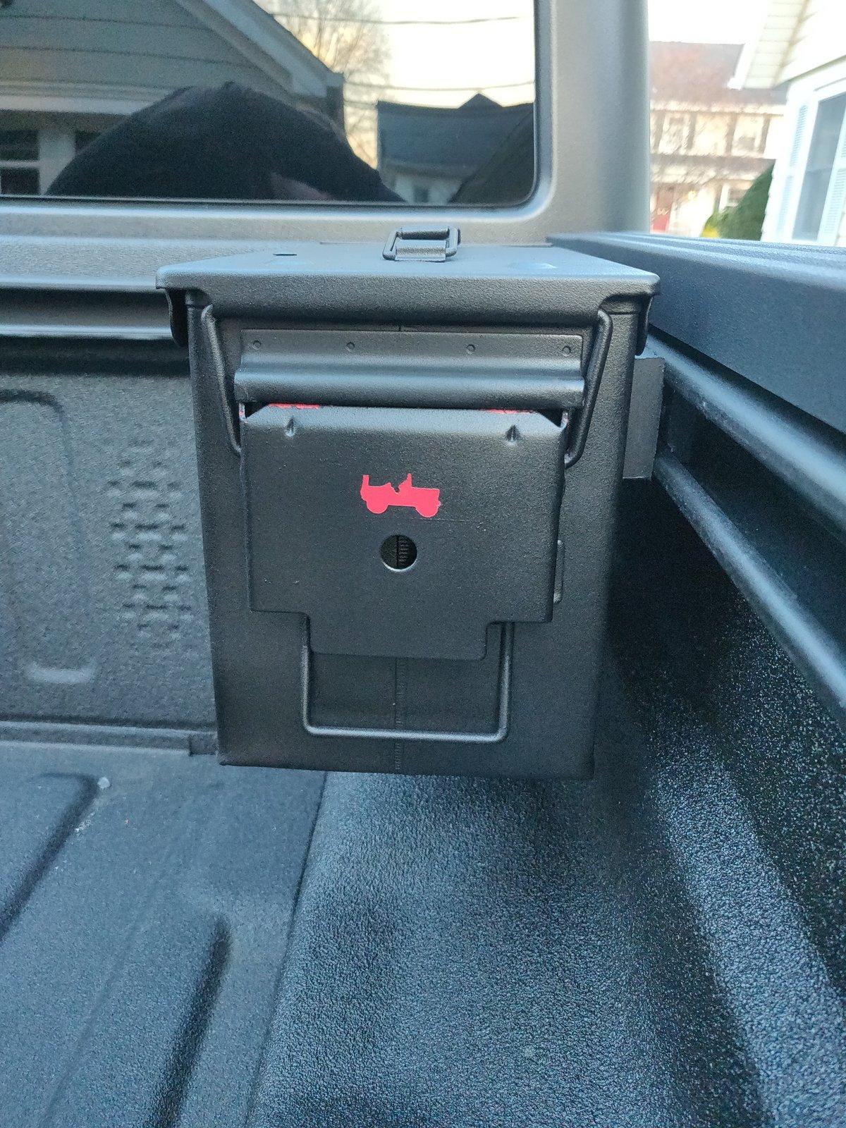

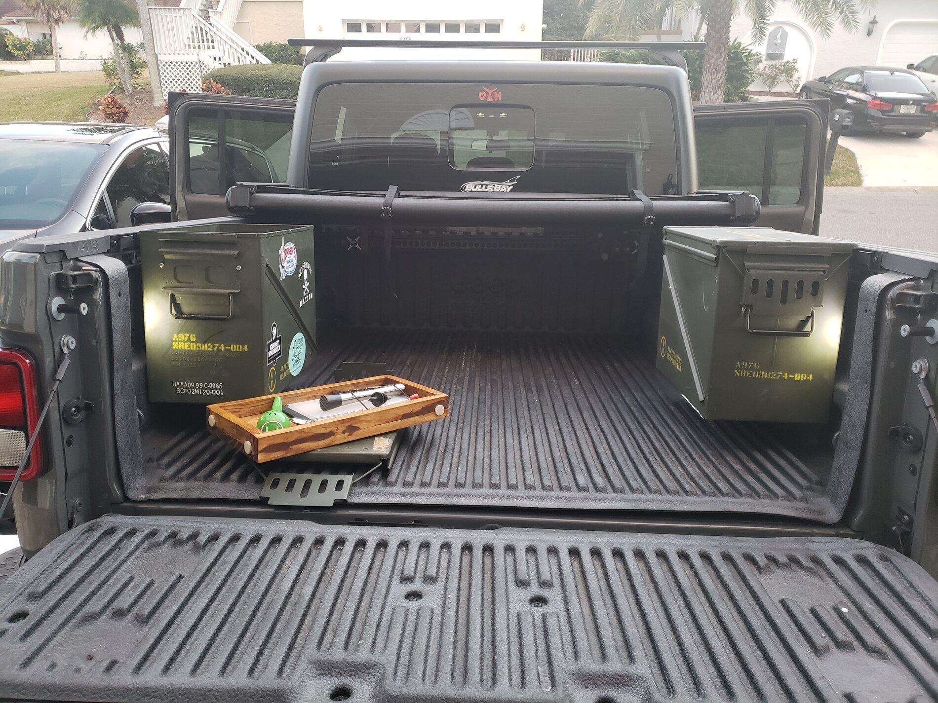

Jeep Gladiator Ammo Box Bed Accessory 20210130_180648
Nice!!!
That would be a good place to mount an ARB single compressor.
