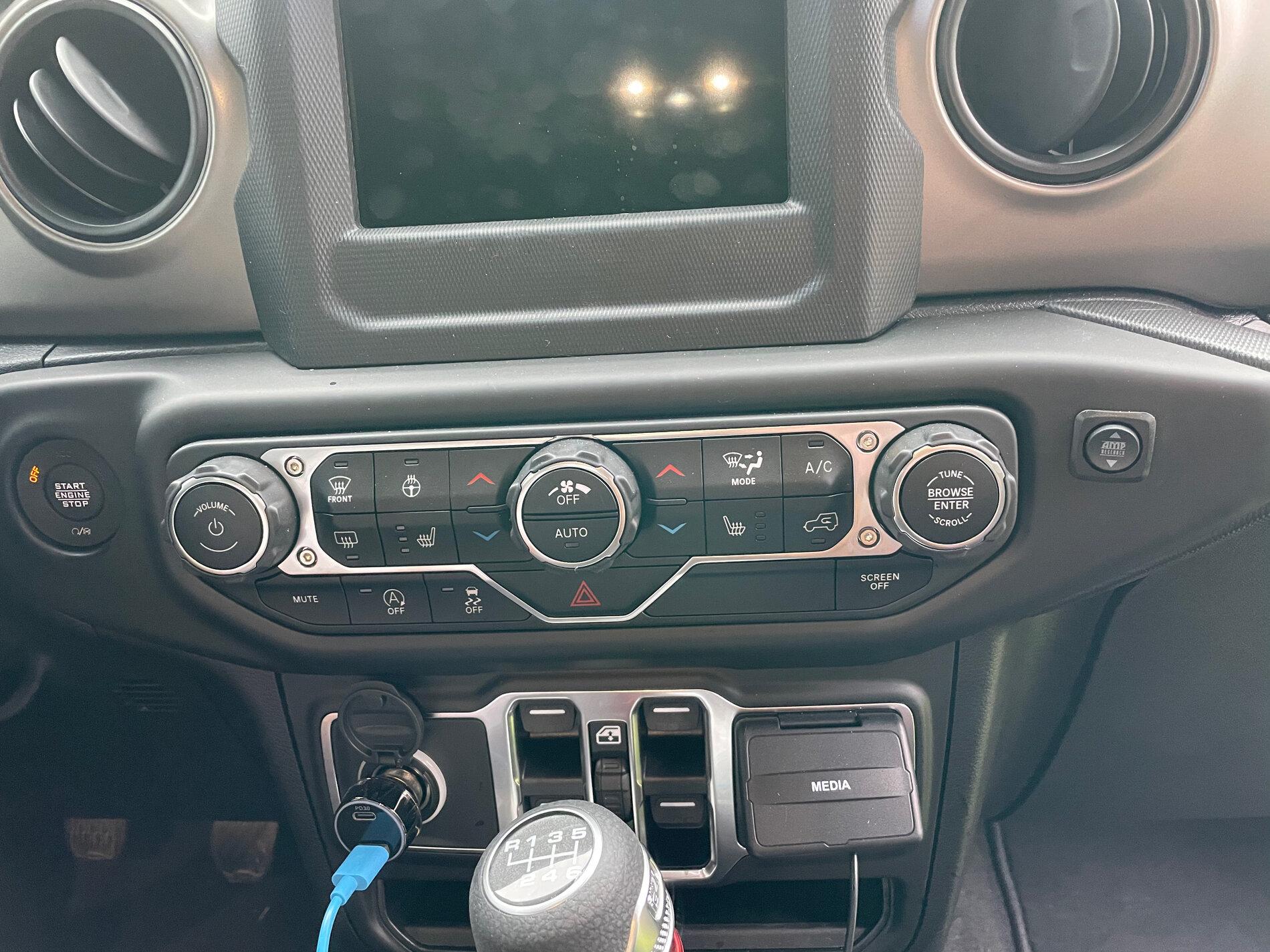

For those who went with the AMP powerstep xl - if you installed the manual switch, where did you pit it? Looking for a spot for mine.

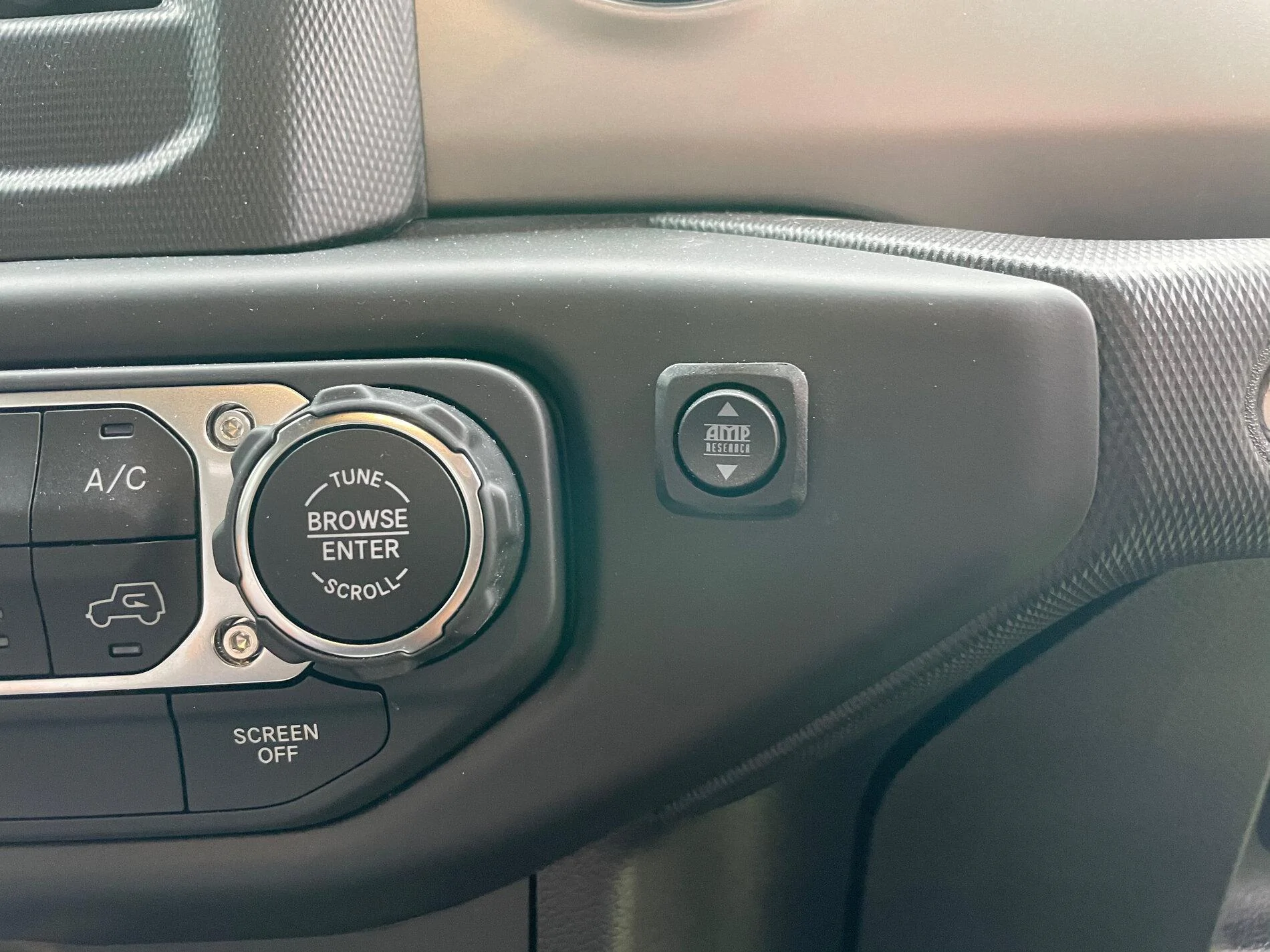

To the right of the A/C controls.

How hard was that? What part(s) of the dash did you have to remove? Sorry, this mod stuff is new to me.
Thanks!
This was easy, that panel just pops out with a flat blade body tool. No screws holding it in just a couple of press in catches. Work the panel tool under the right edge and gently pry straight out. Mine just popped out. Just enough room behind it for that switch to go in with the wires just touching behind. Routing the wires through the rest of the dash was the trickier part.
