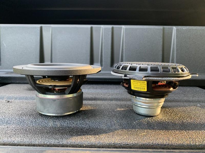

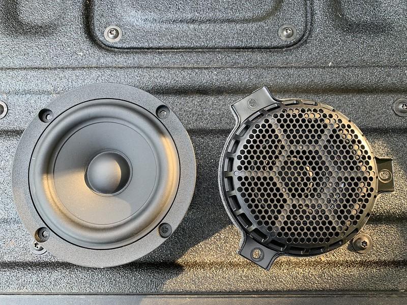

These are some SB Acoustics SB12NRX25-4 I have laying around in the speaker stash. Thinking they might work to replace the factory 4", but still looking for a suitable alternative to the 3.5"
Jeep Gladiator Amp specs for Alpine Premium System? 51312352712_315d1bb75a_c
Jeep Gladiator Amp specs for Alpine Premium System? 51314101090_ea2fa263dc_c

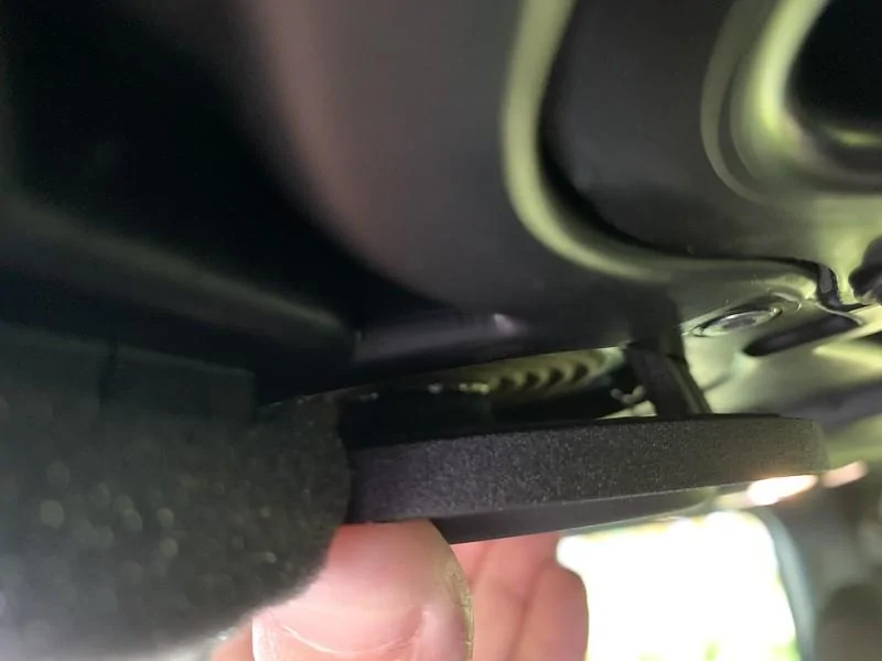

They are just barely too big for the 4" spot, would take a minor amount of trimming to make them fit:
Jeep Gladiator Amp specs for Alpine Premium System? 51313095226_5512230511_c
Those look like a lot better quality than the factory speakers. Now you will just need a different amp to power them since I am sure your new speakers are 4 ohms instead of the factory 2 ohm.

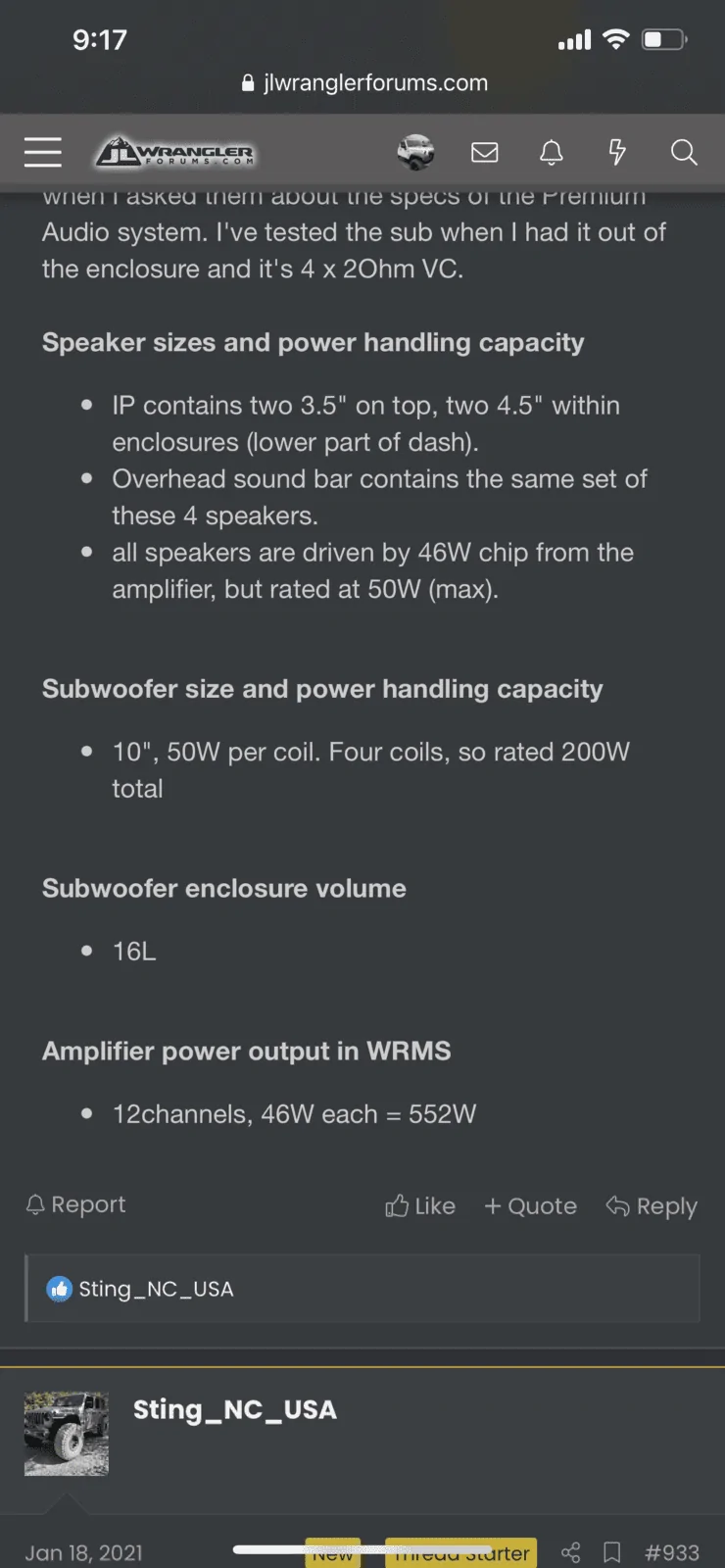

Everything I read about our Alpine system is that everything is at 2 ohms.
RMS is what I always look at in amp and speaker ratings as it is more reliable and constant vs. peak, like you mentioned earlier. Peak is typically at least double the RMS rating for most good speakers. Again, there is a lot of variance here as well depending on the construction of the speaker.
The 46W/channel peak rating for the Alpine amp in our system means that 23W at 2 ohms would be an extremely generous rating. Even if it still carried 70% of that power to a 4 ohm speaker that would be 16W/channel, not 32W/channel. This is why my Rockford component speakers that can handle 40W RMS and 80W peak at 4 ohms are starving with a 2 ohm amp that only provides 46W peak at 2 ohms.

This is from the JL forum but should help
