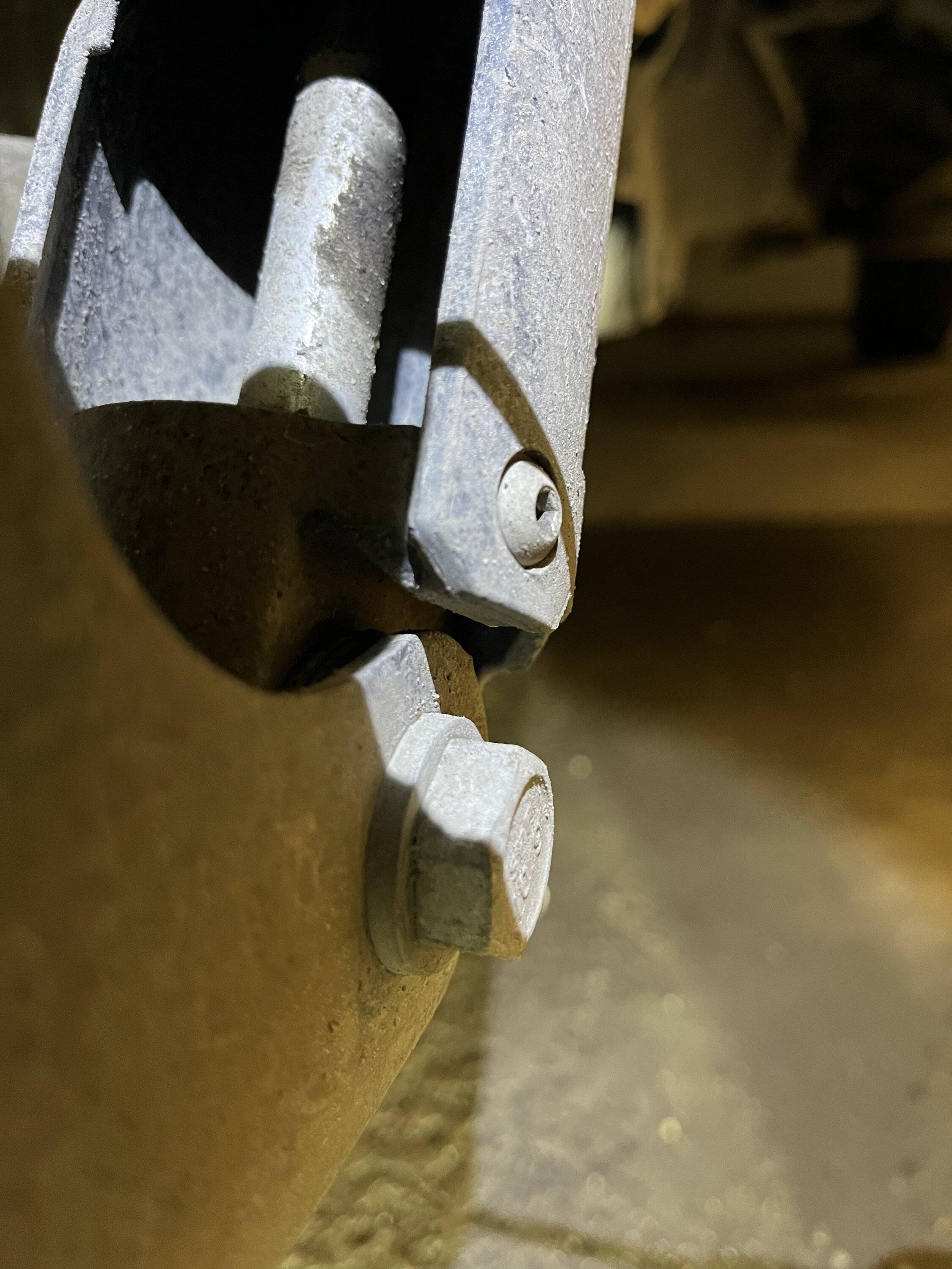

I have a left rear making lots of noise and now right front leaking. Shittiest shocks ever.

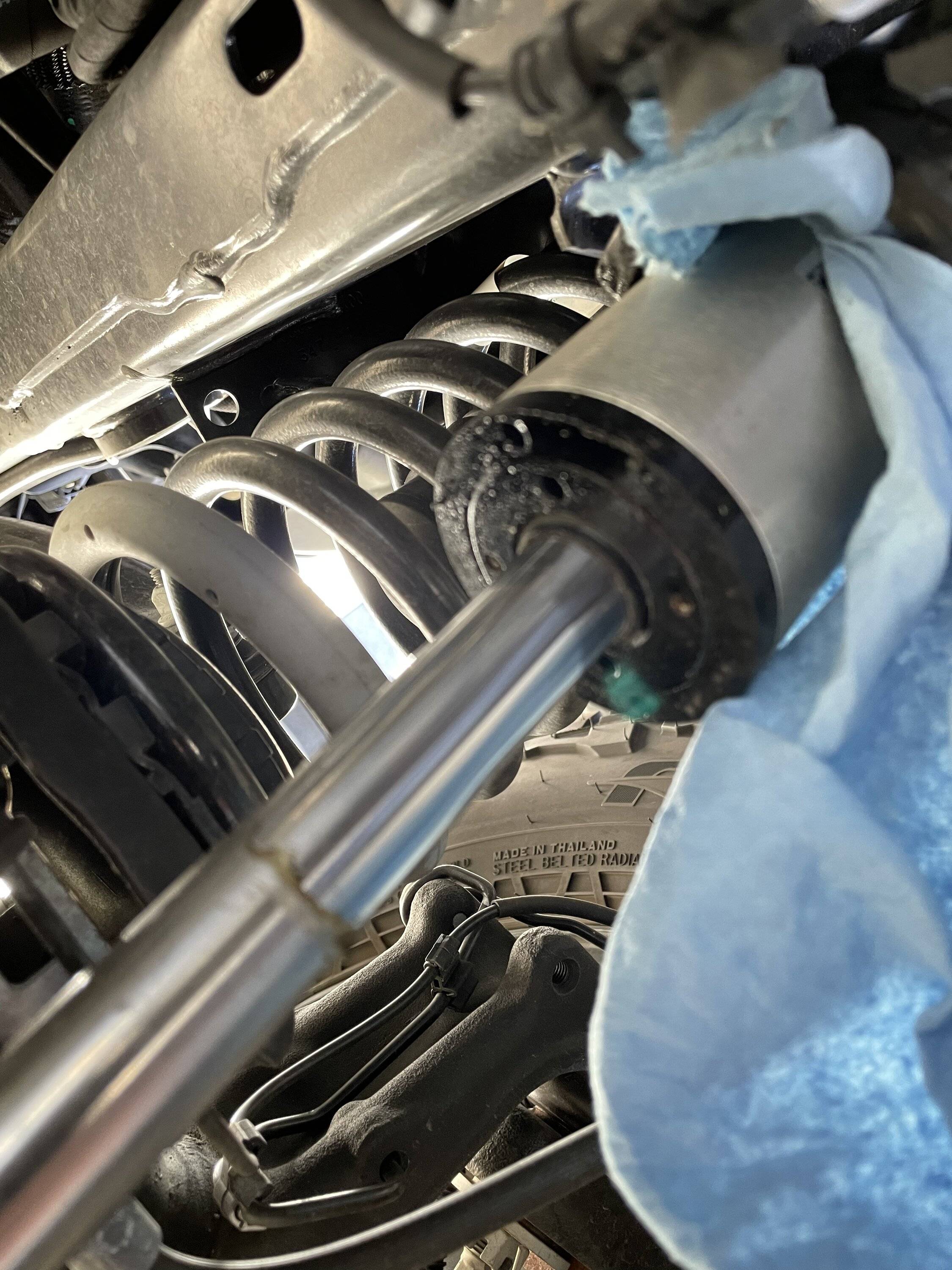

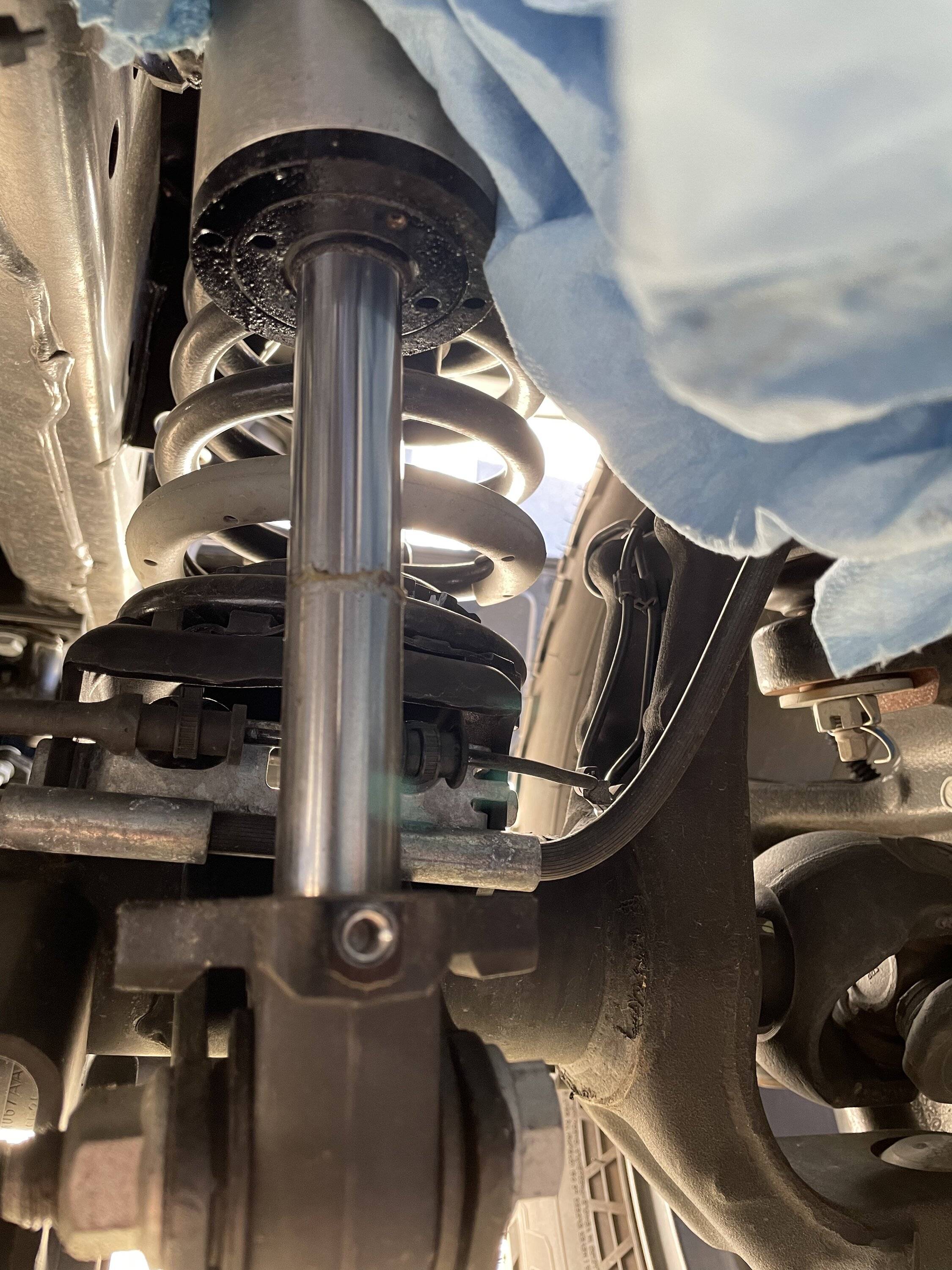

Yeah the symptom was different in the front, was getting Stiction on start from dead stop after breaking. At first thought it was transmission hahaā€¦

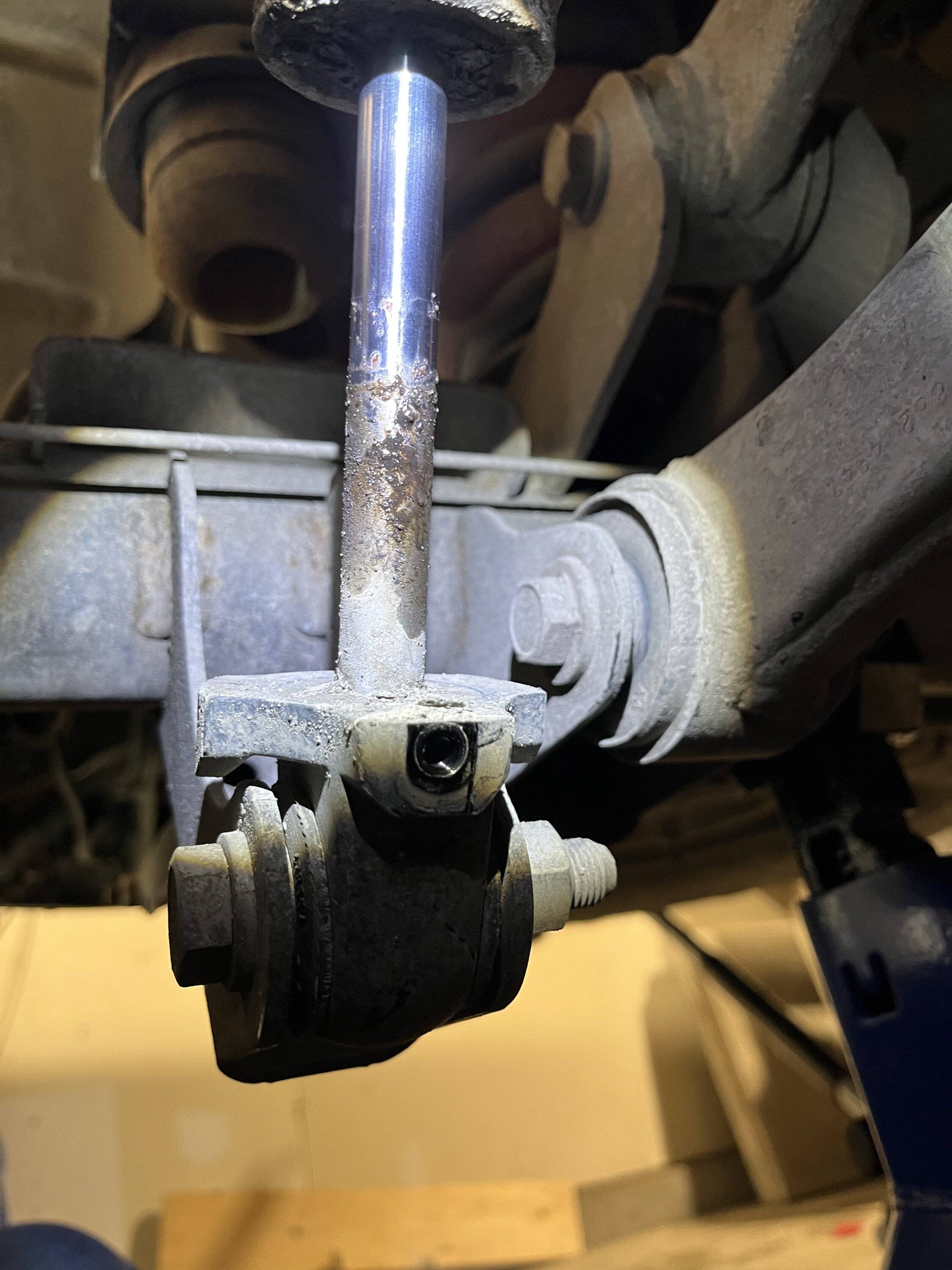

Unfortunately, if it doesnā€™t produce a leak that drips on the floor, itā€™s good enough and hasnā€™t failed. Just went through that with the dealership with my fox shocks on the 21 JTR at about 48k+ kms.
Same goes for your front axel U joints throwing grease, ā€¦FCA approved.
Forget ā€˜em, look for better upgrades.

Thanks for the input , yeah it did leak onto the mounting bolt so one could argue it dropped below as well.., Iā€™ll wait for the 10,000 mile oil change and see. I cleaned it today to see what happens between now and then.

Makes me wonder if that 'dripping on driveway' comment that seems so common is a factory 'spec' to determine if something is warrantieable. Kinda garbage IMO because a leak is a leak - and its quite different and easy to discern compared to seepage.
I got asked the same question about my transfer case leak - "is it dripping on your driveway". Well my driveway is grass so.....who knows. But it's clearly leaking on the transfer. They just shrugged.

Yeah was reading today about weepage vs leakageā€¦ maybe mine only weeped but considering some dropped on the lower mounting bolt Iā€™m not so sure. The bounce test is still ok on the shock. I cleaned it and will monitor between oil changes.

To me it looks like a leak and should be replaced. Your symptoms and a visual inspection should be sufficient for dealer to replace.
