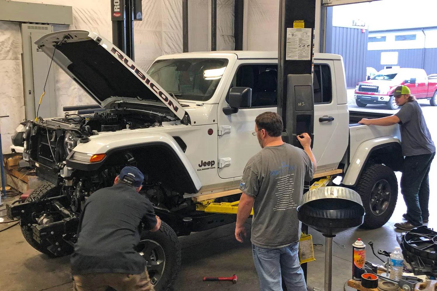

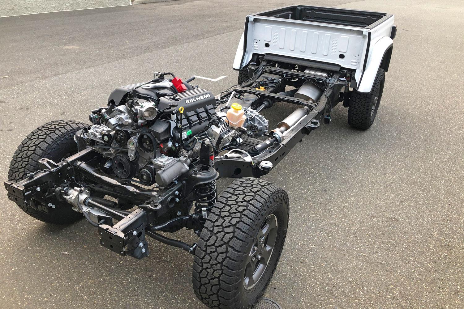

One more Hemi going into a Gladiator, this time around it's a 6.4 Hemi.
485hp+ and 475 ft-lbs of torque, the 6.4 Hemi will make a Gladiator move fast.

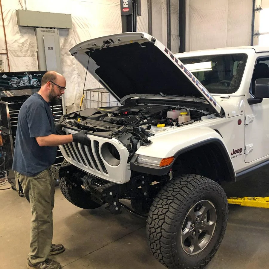

Any build has to start somewhere and we're going to start with the grille.

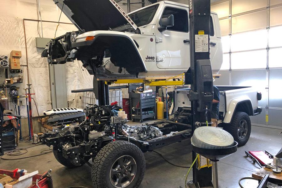

Then start tearing it all down until you can pull the cab off.

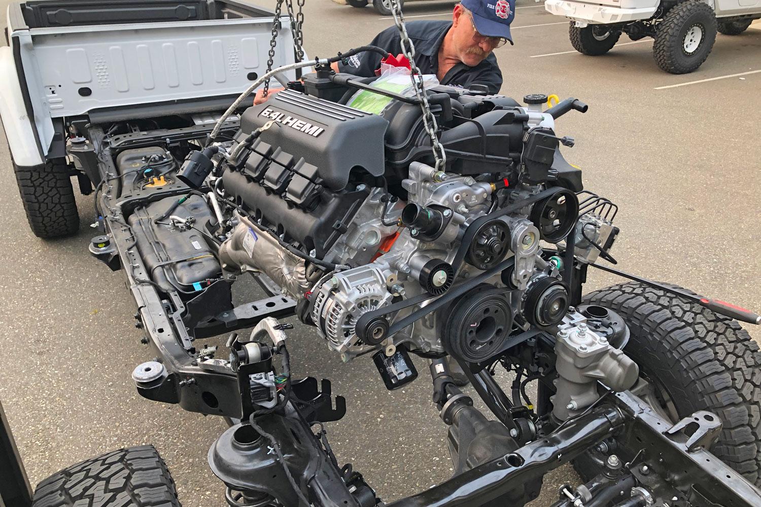

Then it's time to start disconnecting everything on the not-so-old engine to get it ready to pull.

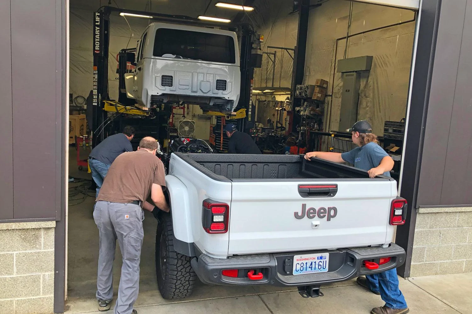

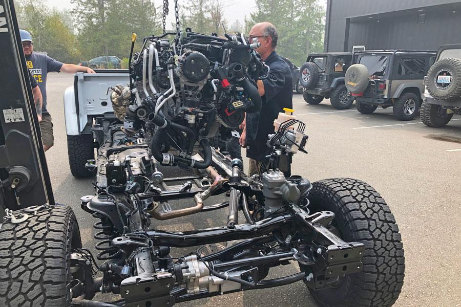

Roll the chassis out the door, grab the forklift and pull the stocker 3.6 out. All the while trying not to breathe in the smoke hanging in the air.

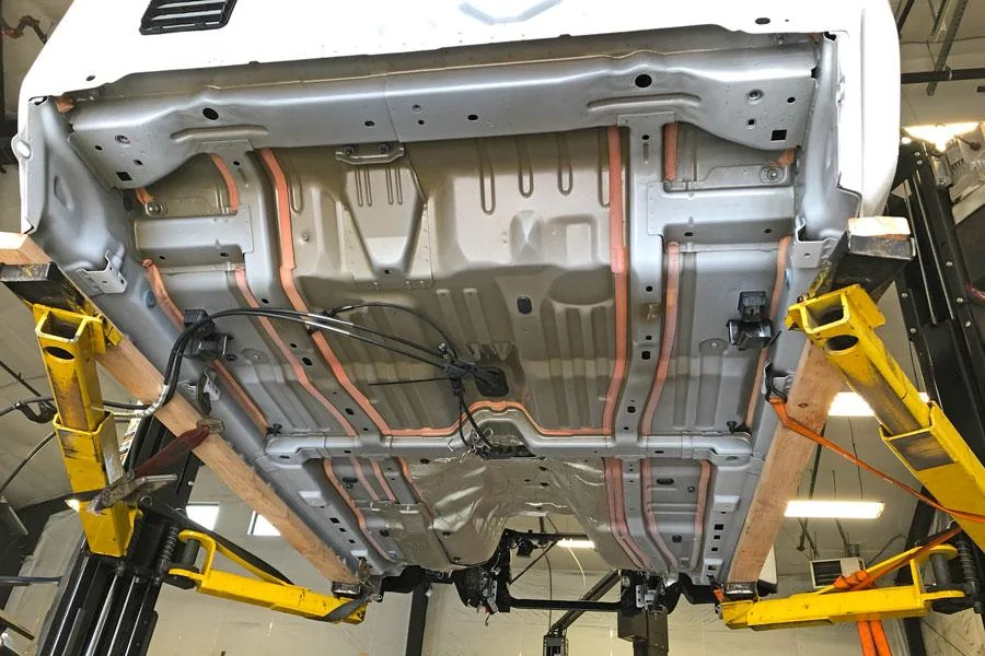

Every wonder what the underside of a new cab looks like? This Gladiator had less that 1600 miles on it.

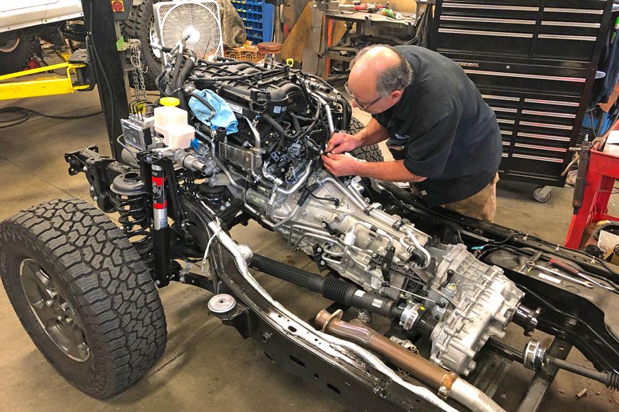

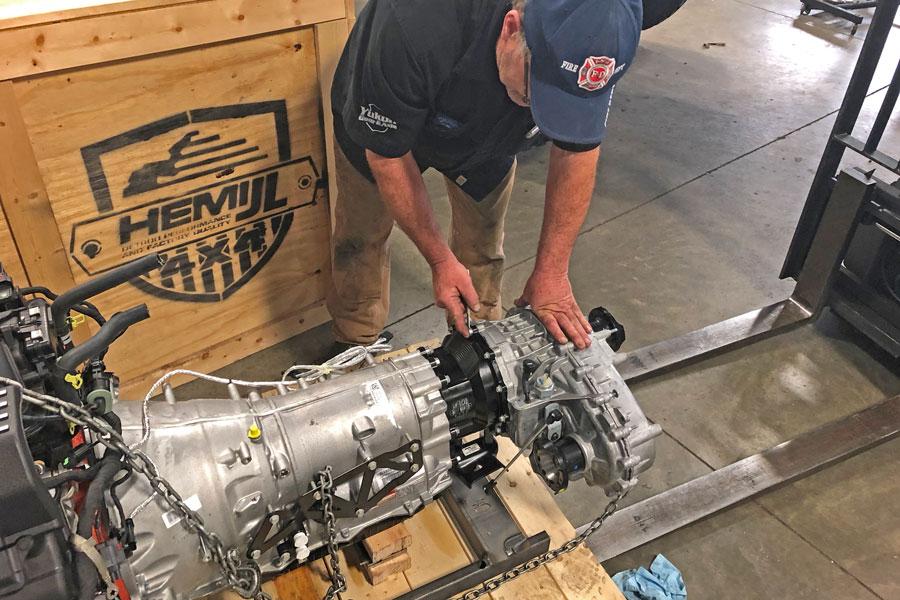

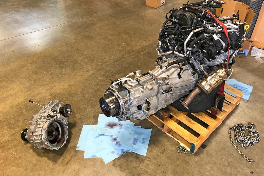

Next up is to pull the stock Rubicon transfer case off the back of the old 8 speed trans.
Then bolt it to the new 8 speed behind the Hemi.

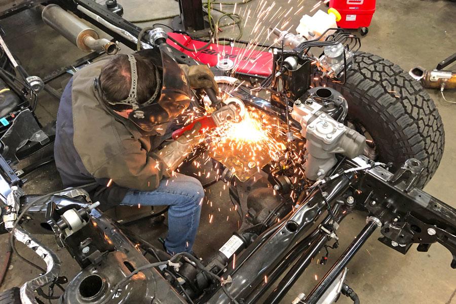

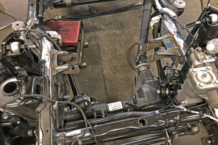

While that is happening, head mechanic Jeremy has cut the OE engine mounts off the frame and is sanding the frame down smooth.
Then I stepped away for 30 seconds and he had the new Hemi mounts welded in!

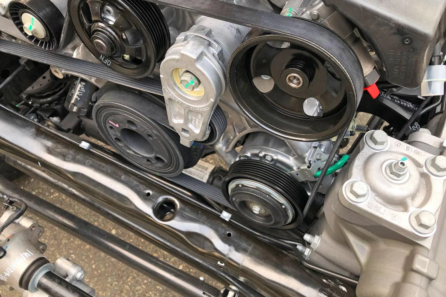

With the new mounts welded in and painted, it's time to drop the 6.4 Hemi into the chassis.
The Hemi is definitely a tight fit. About a half inch between the pulleys and the front crossmember and PS box.
Time to step back and enjoy the view.
Then push it back in the shop and get to work reassembling everything.

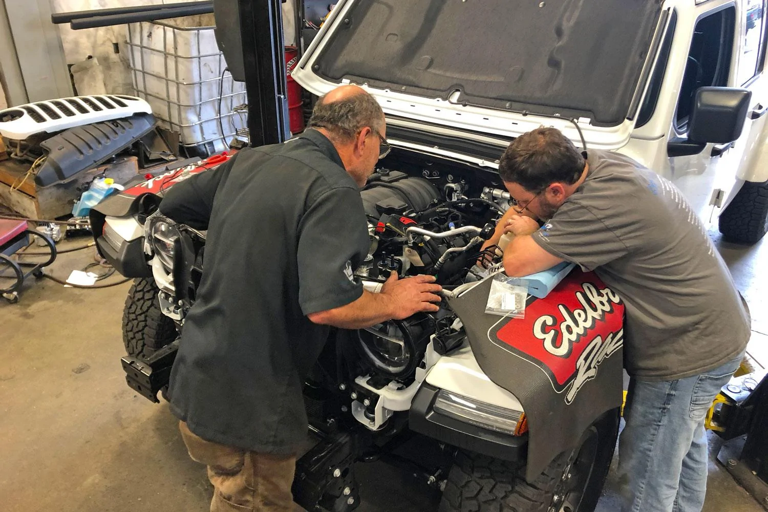

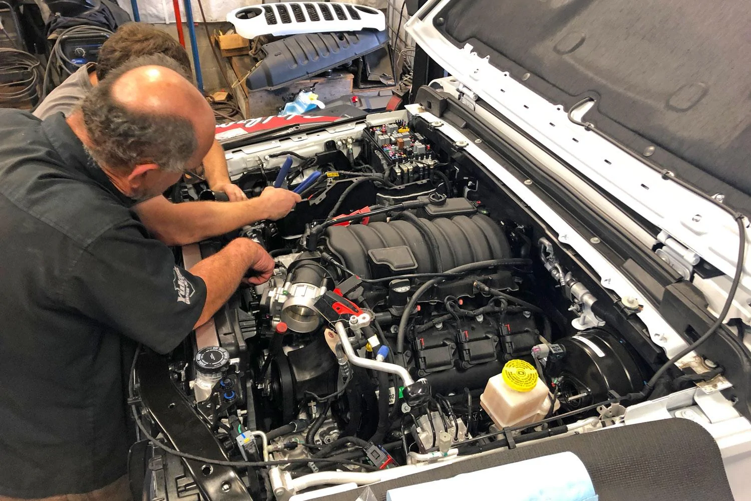

Let's update status on this 6.4 Hemi build....
So we sent off the ECU to be re-flashed with the AMW4x4 500hp tune and all the other cool stuff they do to make this run like it was OE stock. While the ECU was going back and forth, the mechanics worked on getting everything hooked up and ready to run.
Starting out by hooking up all the components and accessories that needs to be done with the cab off.
Then the cab can be lowered back into place and bolted down.
Then it is hours of hooking everything back up....
Then a few more hours getting the new radiator in place and getting hoses etc. hooked back up.

Once the re-flashed ECU shows back up and installed, the 6.4 Hemi Gladiator is ready to start....
And on first crank, it fired right up and runs beautifully.
Still lots of stuff left to do on the build. Will update soon.
