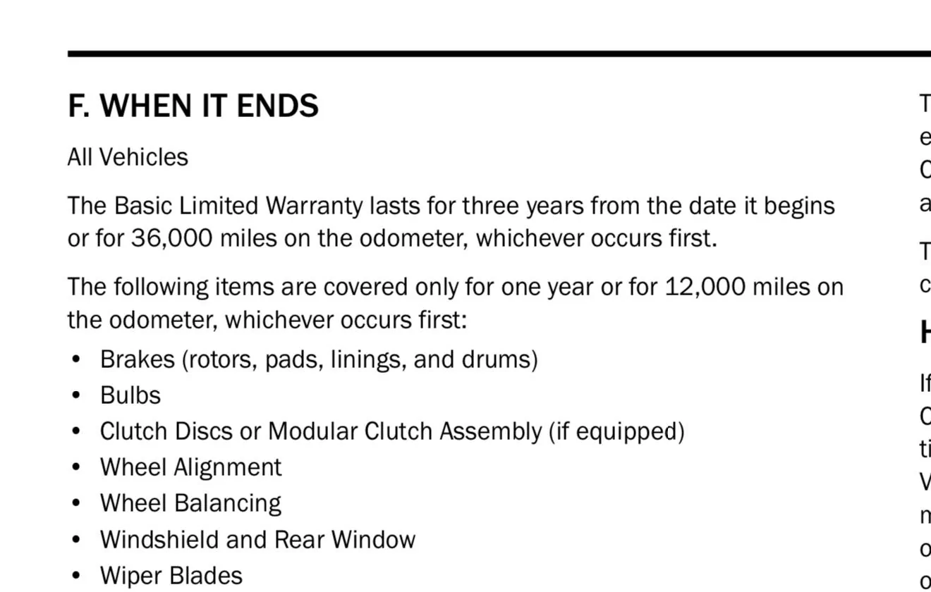

Good luck. You're past the 12 month, 12k mile warranty on it. Hopefully your dealer fights for you or just eats the cost.
Oh dang, there’s a separate warranty for windows? That’s nuts. Here’s hoping.

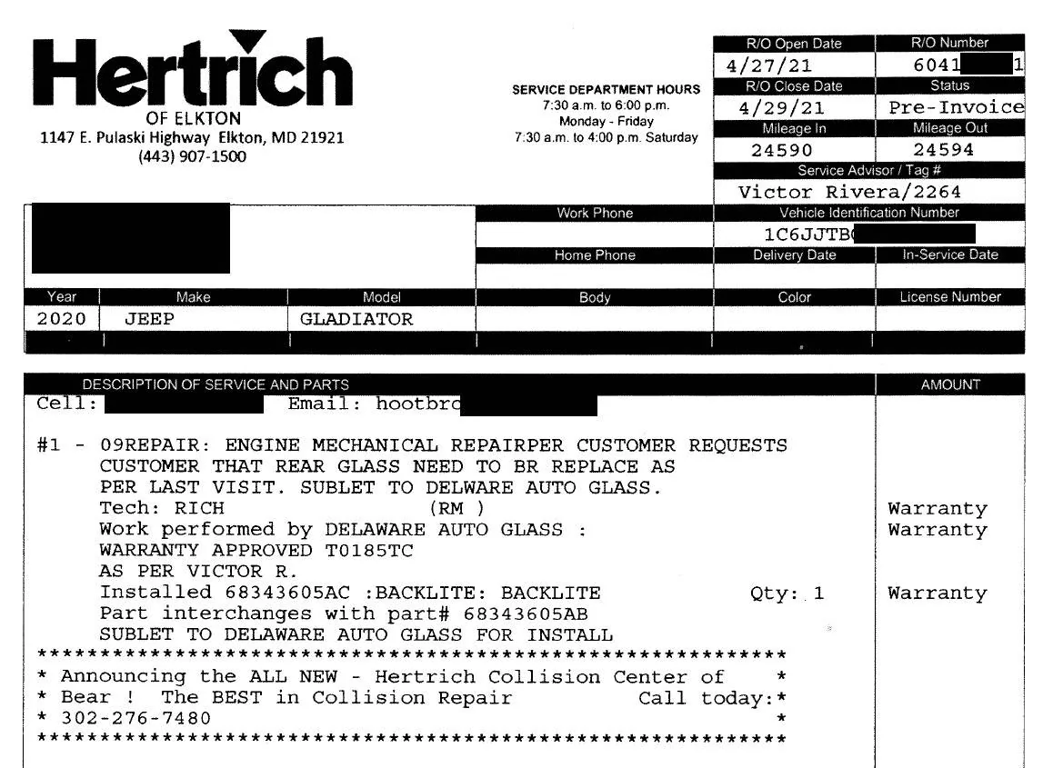

I would still take it in. Plenty of people had it covered under the 3/36K warranty because it was usually the frame cracking and not the actual window itself. My 2020 Rubicon had 24K miles on it when I took it in. They can get it approved by Stellantis if they word it right.
Dealers that are using the 12/12K language are being dicks because glass is scary and they do not want to deal with it.

Yeah, I called this AM and had them confirm for me-falls under the 12/12 warranty. Since this is the dealer I trust I’m just going to leave it at that and do the tubing fix. There is another dealership in town but I wouldn’t take anything to them unless I was planning on getting rid of it 🤣
