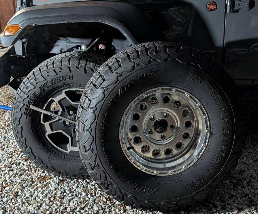

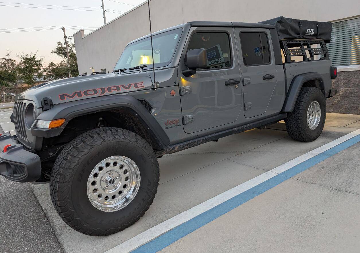

Original plan was gray fifteen52 analogs with 35s (Already bought the wheels).
Found a set of K02s on some raceline wheels with tpms on marketplace with no miles and recent datecode cheaper than I could find 35s.
Unfortunately for my wallet I surprisingly like the raceline wheels so I may have to punt the analogs.
First impressions on this mornings commute is a much smoother rider over typical rough roads and speed tables. I was expecting a more significant power drop too especially with the manuals gearing but so far Im realy pleased.. That may change on the expressway and in heavy traffic of course.
I do suspect the TPMS may not be compatible as it was showing about 4lbs light and after about 30 min I did get an error. I may need to swap in the stocks sensors.
Heading to MOAB for white rim (from FL) in march and contemplating the AEV spacer lift. A bit worried about stuffing tires into the inner fenders but I may take that risk for some better mileage as thats going to be some significant highway miles there and back.
Hell I might even wash the new wheels and maybe the truck this weekend :).

I lived with that tire on my 6mt for almost a full year before I got 4.88s. It was fine around town but you really find yourself in "the wrong gear" a lot and have to downshift more frequently just for mild acceleration. Its not ideal but it is workable. I really am enjoying the 4.88s now.

If nothing else, throw in a 3/4 inch spacer out back to compensate for the weight of your RTT. I did the same for when I pull my trailer. It will give the rear tire a little more breathing room too. And don’t disconnect the sway bar. My 35’s barely touch with it disconnected.
Daystar-KJ09192 .75" REAR Lift Kit for 2020 Jeep Gladiator JT
https://a.co/d/bnpgJdI
It looks like these work with mojave too, I'll pick up a set for now thanks!
