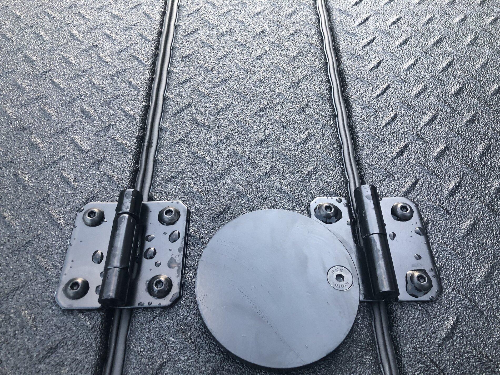

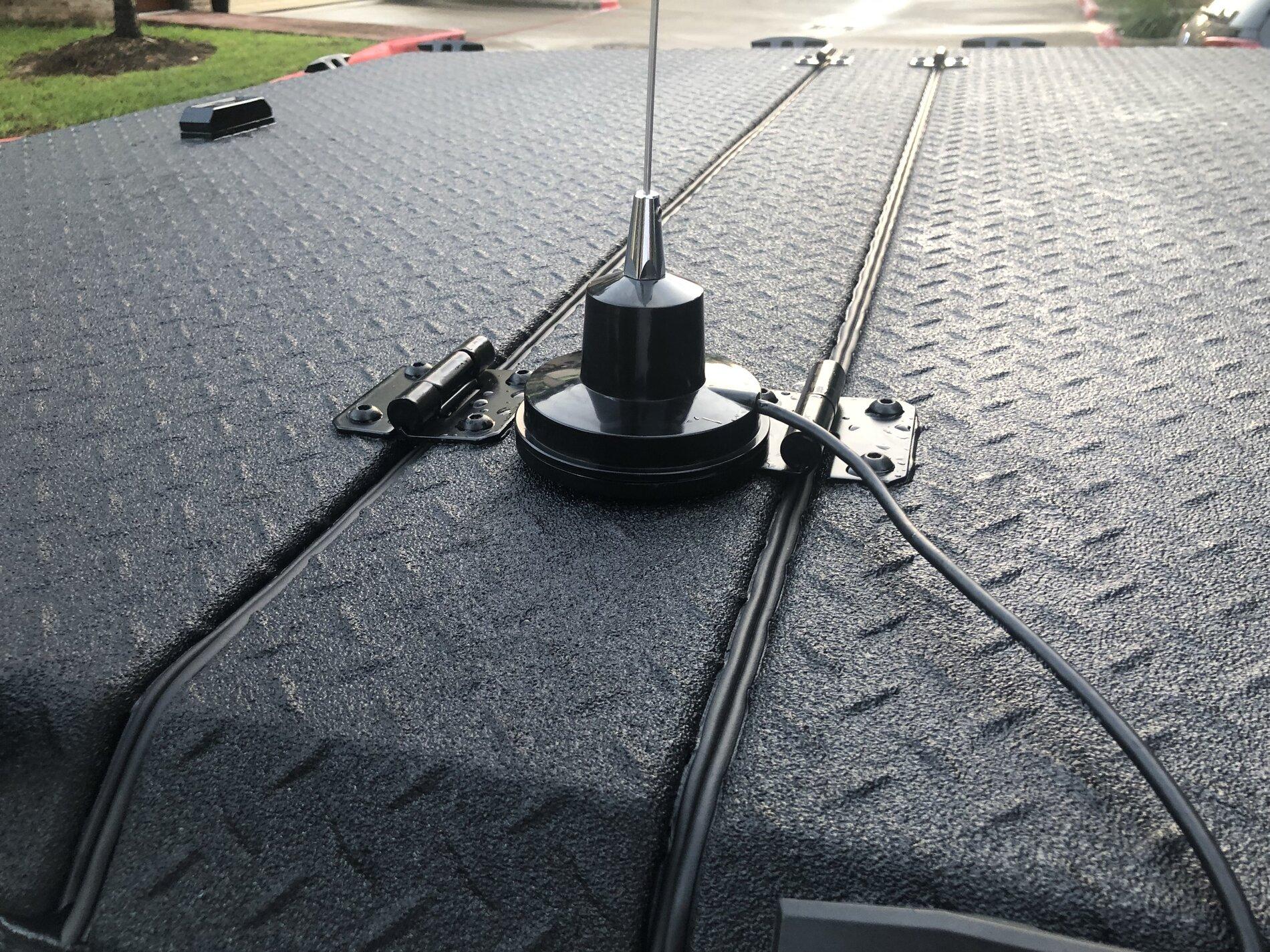

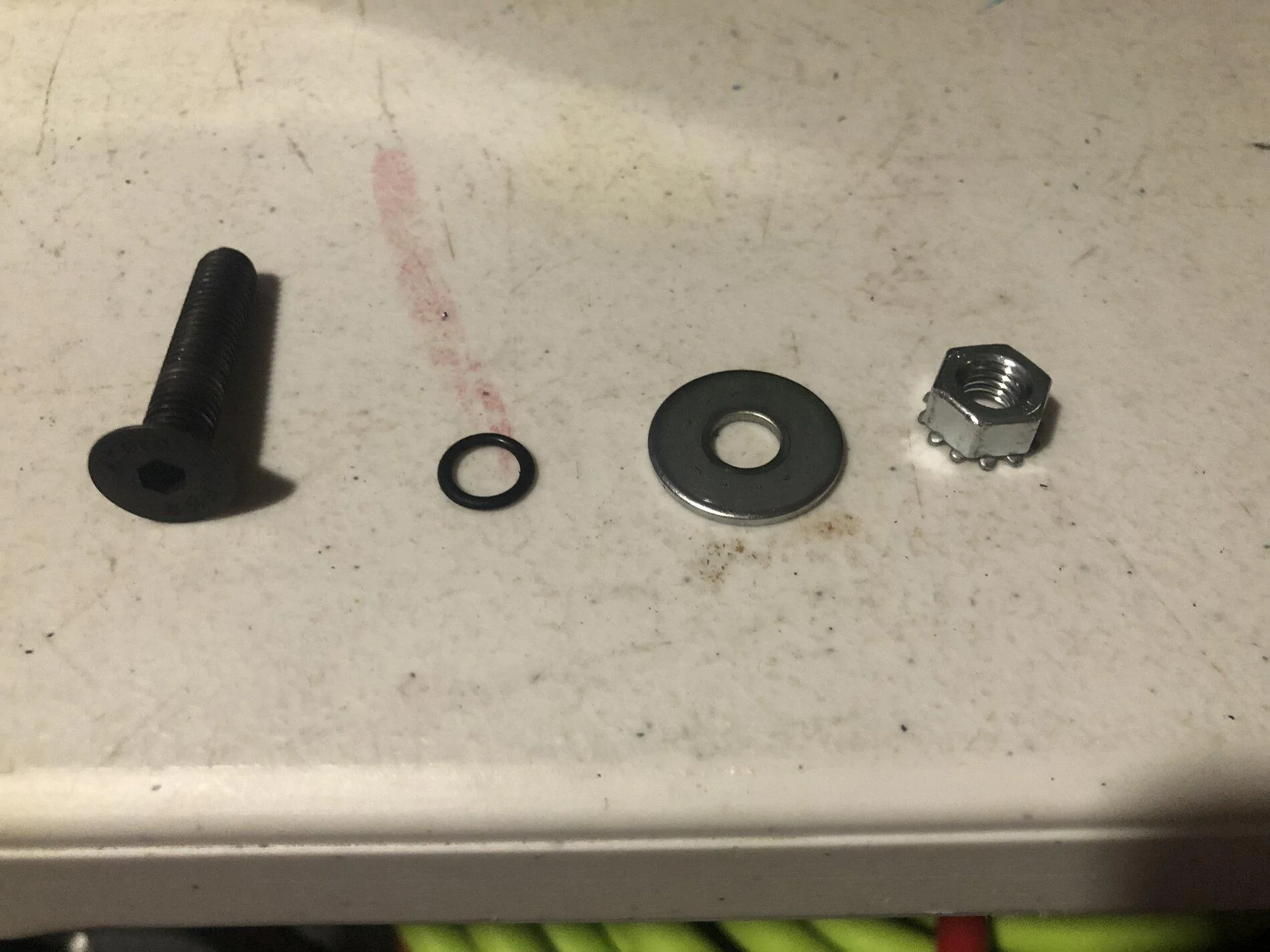

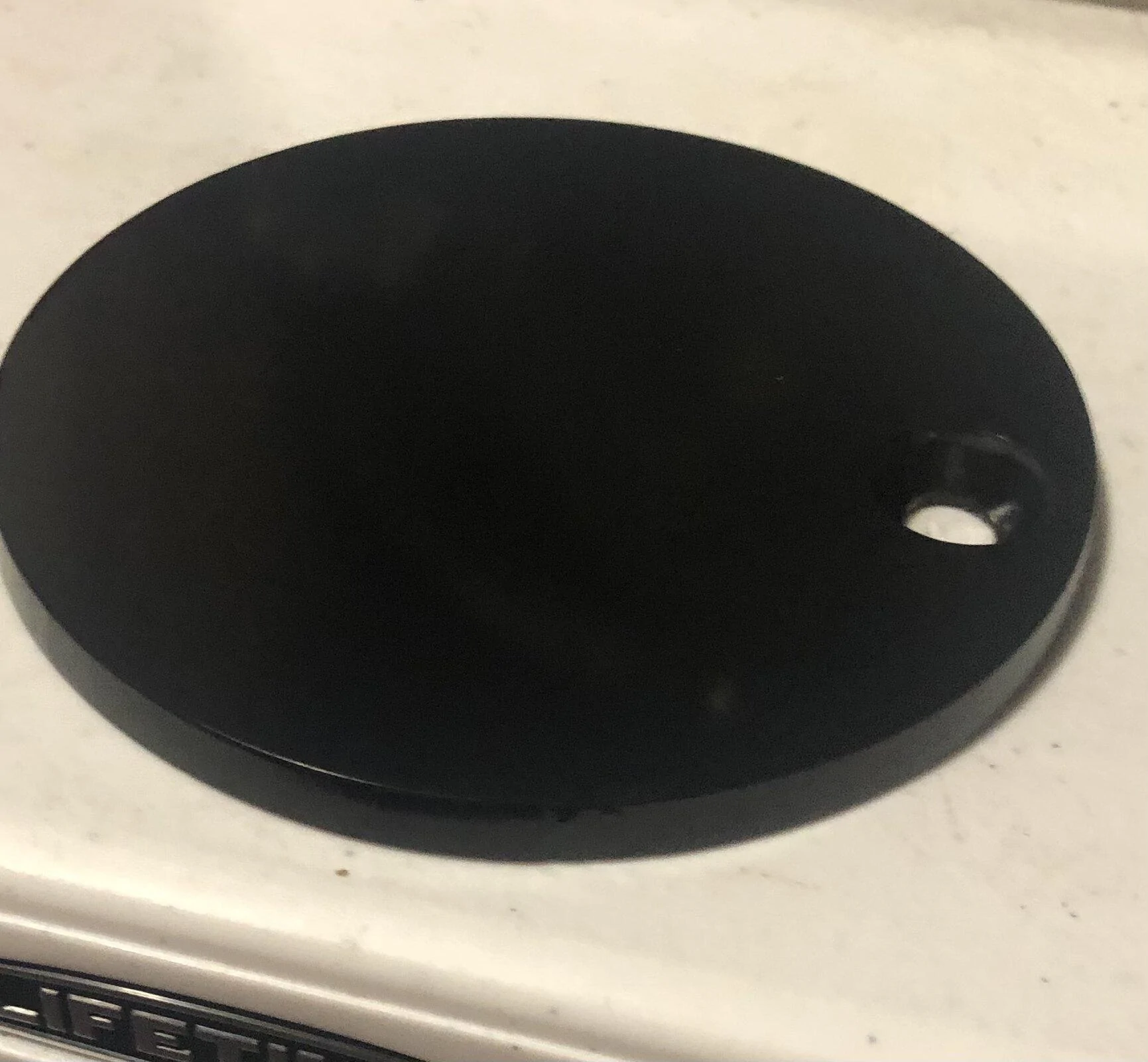

Just wanted to share my approach to mounting a magnetic cb antenna on a diamondback hd on an aluminum body f150. Used sanded 1/4” hot rolled 4” diameter steel plate with drilled counter sink hole a black Allen head bolt a rubber gasket a fender washer and a locking nut inserted in one of the existing latch bolts. Painted with two coats of rust oleum black paint. Hopefully pictures provide details if others want to repeat.
