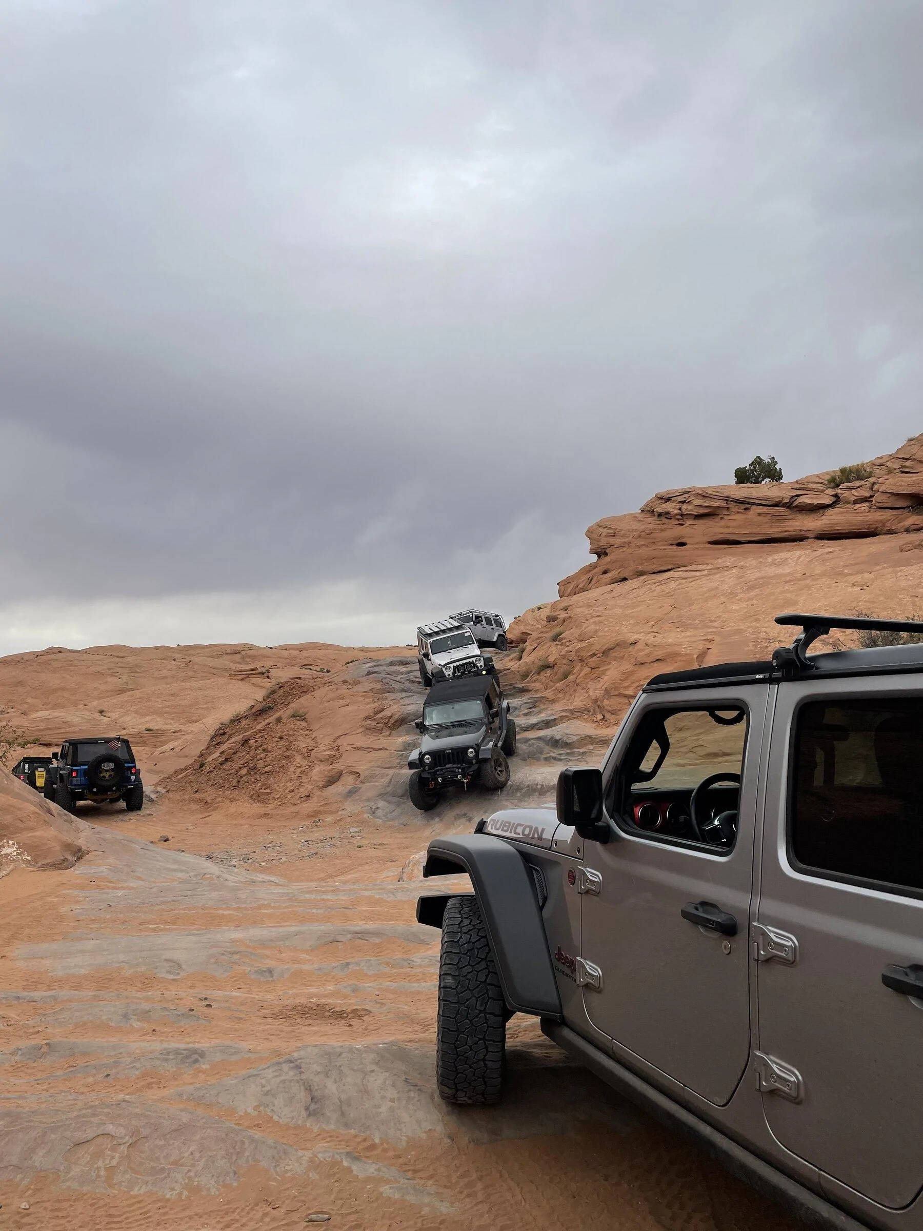

Yes. I installed JK mopar strap style handles in the front, but used mopar JT handles for the back row. They stay on, are low profile, so fit under the sunrider frame, and stay tight. They’re also cheaper than many options. This was the only picture I could find, obviously not taken for this reason.
Jeep Gladiator Any Grab Handles that are easy to install with a Besttop Sunrider top? 14837676-2DC1-40D6-8C50-43580E3E90BF

Thanks, they look good... I will check them out. Looks like you have a roof rack on your gladiator that doesn't interfere with the sunrider as well???

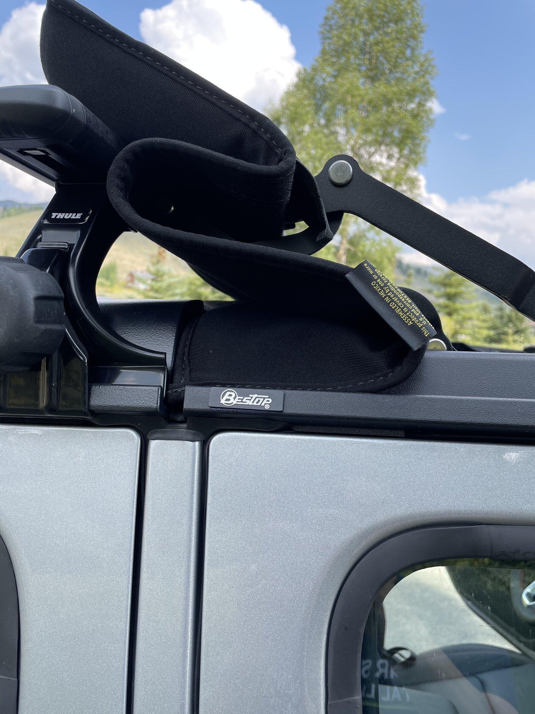

I do. Thule bars with rain gutter feet. I put them as far forward on the main hard top, so that it doesn’t interfere with removing freedom panels or installing the sunrider. I go back to freedom panels in the winter. The sunrider hinges back and gently rests on the front of the cross bar. No issues at all. I open the sunrider almost every day between spring and winter. The front of the thule feet are flush with the front of the main hard top’s rain gutters. I’ll look for a picture with it open.

Jeep Gladiator Any Grab Handles that are easy to install with a Besttop Sunrider top? D5EA4A10-F456-4EA4-91B7-80A29BBC084B
Thule has two or three different feet heights in this style. If I recall, I think I used the middle one, but definitely did not choose the extra high ones. They were way too high.

Thule’s configurations wanted to say I needed the extra high ones. I went to a local Thule dealer and walked out to the JT with the different height feet to verify clearance. If you’d like, I’ll happily dig up the receipt to see which ones I ended up with.
