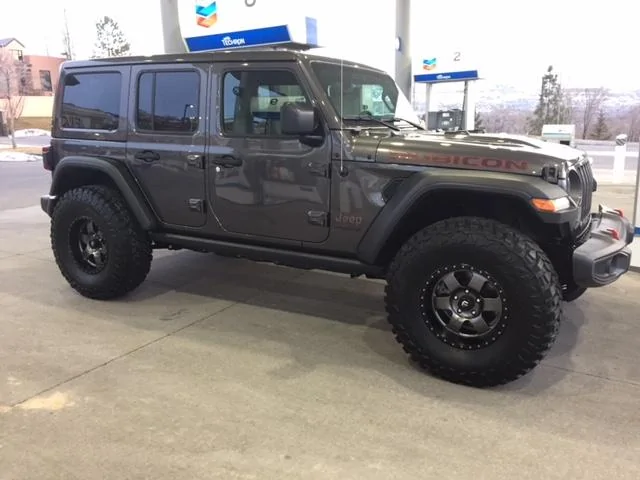

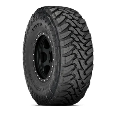

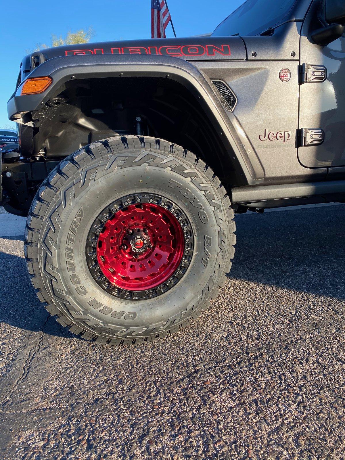

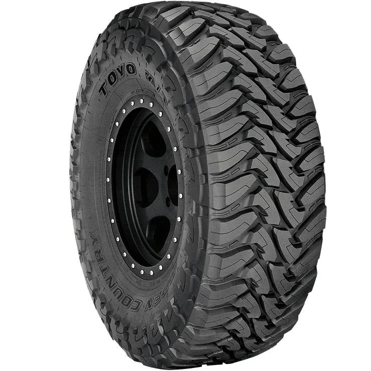

I'm running Toyo Open Country R/T tires - they're D rated and they're great.
37x12.50-17
Great traction, super "quiet" on the pavement especially compared to most M/T tires and other R/T tires. Extremely durable 8-ply side walls which are great for off roading. Plenty of weight/towing capacity (more than needed). The 78 lb. weight has not been any issue at all but I did re-gear (4.88 front and rear).

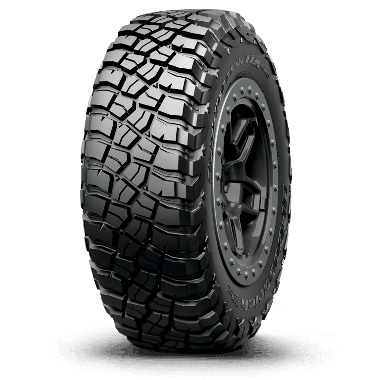

BF Goodrich KM3
Class : Mud Terrain
Options :
LT315/70R17 E Rating (Actual Diameter 34.4) Weight : 65.7 lbs Width : 12.7
35X12.50R17 E Rating (Actual Diameter 34.5) Weight : 74.38 Width : 12.5

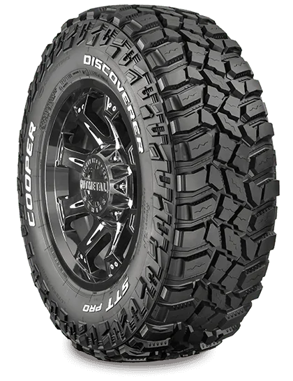

Cooper Discoverer STT Pro
Class : Mud Terrain
Options :
LT315/70R17 E Rated (Actual Diameter: 34.57) WEIGHT : 66 lbs Width : 10"
Options :
37X12.50R17LT D Rated (Actual Diameter: 36.77) WEIGHT : 75 lbs Width : 10.2"
37X13.50R17LT E Rated (Actual Diameter: 36.77) WEIGHT : 84 lbs Width : 10.98"

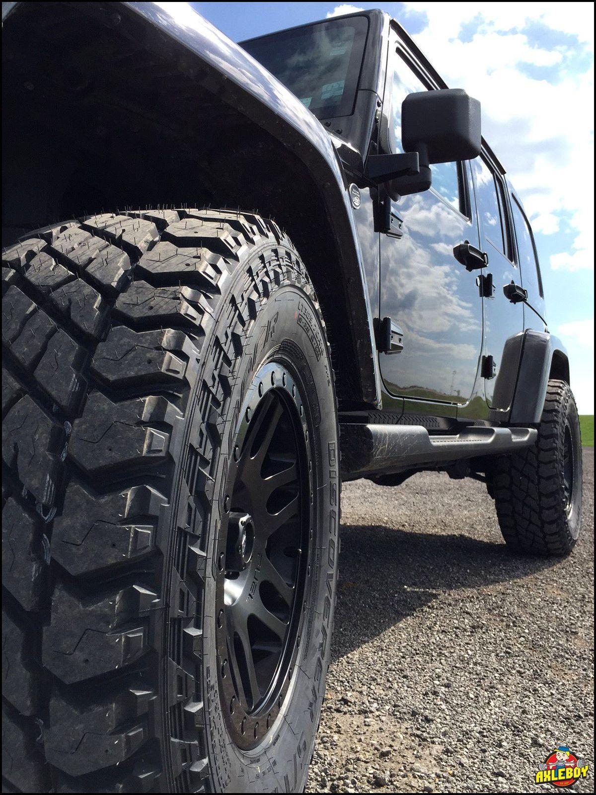

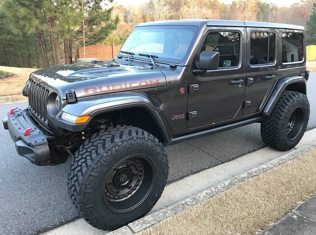

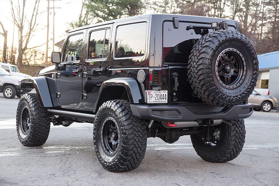

Toyo Open Country M/T
Class : Mud Terrain
Options :
LT315/70R17 E Rating (Actual Diameter: 34.6) WEIGHT : 78 lbs Width : 12.7
35X12.50R17LT E Rating (Actual Diameter: 34.8) WEIGHT : 78 lbs Width : 13.2
Options :
37X12.50R17LT D Rating (Actual Diameter: 36.8) WEIGHT : 84 lbs Width : 12.5
37X13.50R17LT E Rating (Actual Diameter: 37) WEIGHT : 94 lbs Width : 14.6

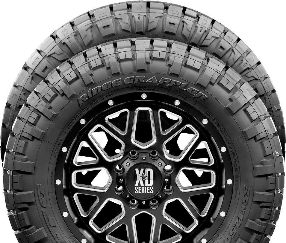

Nitto Ridge Grapplers
Class : Hybrid Light Truck
Options :
LT315/70R17 E Rated (Actual Diameter: 34.41) WEIGHT : 70.83 lbs Width : 12.72" JLU PSI : 30
35x12.50R17LT E Rated (Actual Diameter: 34.76) WEIGHT : 75.45 lbs Width : 12.52" JLU PSI : 31
Options :
37x12.50R17LT D Rated (Actual Diameter: 36.77) WEIGHT : 81.48 lbs Width : 12.52" JLU PSI : 26
37x13.50R17LT E Rated (Actual Diameter: 36.77) WEIGHT : 87.04 lbs Width : 13.58" JLU PSI : <25

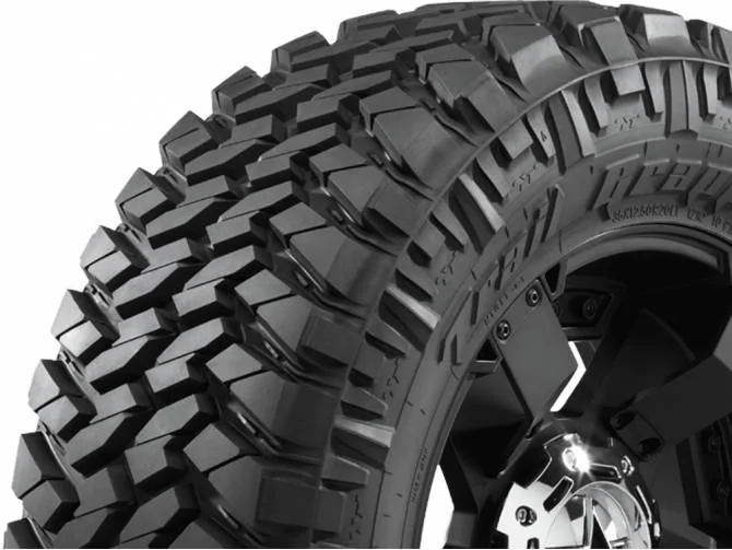

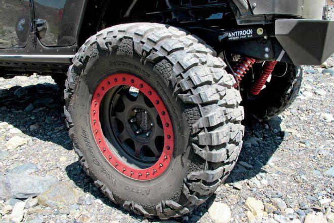

Nitto Mud Grapplers
Class : Mud Terrain Truck
Options :
35x12.50R17LT E (Actual Diameter: 34.76) WEIGHT : 79.05 lbs Width : 13.19"
Options :
37x13.50R17LT E (Actual Diameter: 37.05) WEIGHT : 97 lbs Width : 14.57"

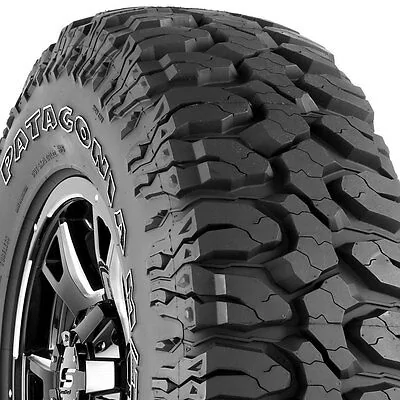

Milestar Patagonia M/T
Class : Mud Terrain
Options :
LT315/70R17 (35X12.50R17LT) D Rating (Actual Diameter: 34.7) WEIGHT : 67.92 lbs Width : 12.7"
Options :
37X12.50R17LT D Rating (Actual Diameter: 36.8) WEIGHT : 71.3 lbs Width : 12.5"

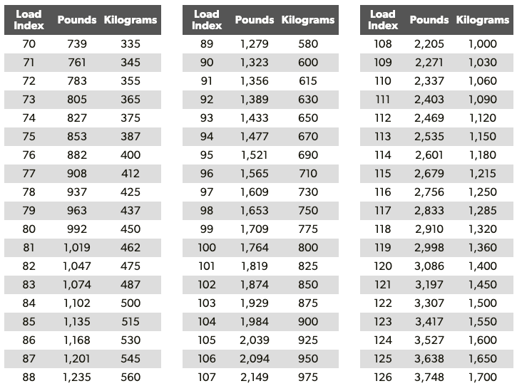

Jeez guys, Google is your friend...and speaking of our friends @Discount Tire provides this starting point:
There's also a load rating index that's relevant - here's that info plus the above chart:
https://www.discounttire.com/learn/load-range-load-index

FYI: Jeep selected Falkenā€™s WILDPEAK A/T AT3W tires for the Gladiator. Size is LT285/70R17 (116/113Q-rating) as standard fitment, while also available will be the LT285/70R17 (116/113Q) WILDPEAK M/T (Mud Terrain).
The Falken tire has a 116 load index = 2,756 lbs.
More info - load range, ply rating and max load (at pressure)...
Jeep Gladiator Any regrets running load range E tires? {filename}
Above load index chart is from TireRack.com
https://www.tirerack.com/tires/tire...6427243784!b!!g!!&gclsrc=aw.ds&&affiliate=HM5
