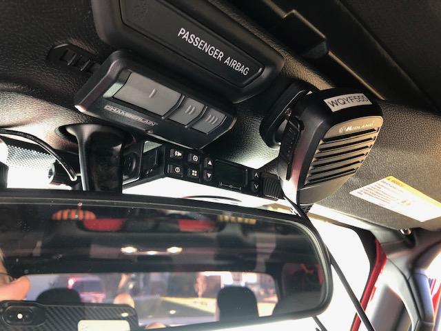

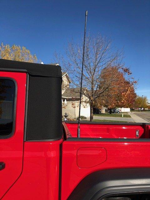

@CarolinaGladiator
Here is my setup, midland handheld that has a mounted setup also. I then got A pillar mounts, mounted a Wilson antenna, because I wanted to run the ground myself and Wilson already has a ground wire, ran the antenna cable through the firewall on the passenger side, added a cb mount to the OH Crap bar and there it is. As noted, you get better range with a mounted antenna. I also added some lights :). Hope this helps
I did not want a full size cb, so this works exceptionally all well for me. Take pictures and have fun!

So tell me about that antenna mount. Is it mounted in the bed or on the top of the bed rail?

And how the wire was run. I think I see it under the top on the drivers side. If I'm wrong that's fine but I recommend a clean run without pinching or damaging weather stripping. But, like I said, I could be wrong.

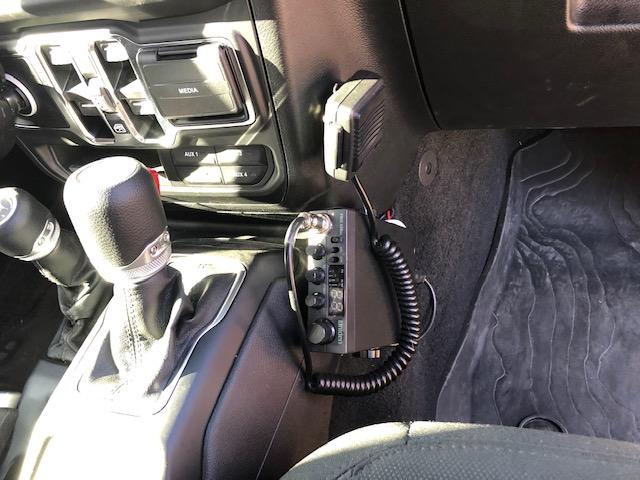

I have a cobra 75 with a mount near the grab handle. The antenna cable is run out of a floor drain plug. The antenna is attached near the hood and front fender.
