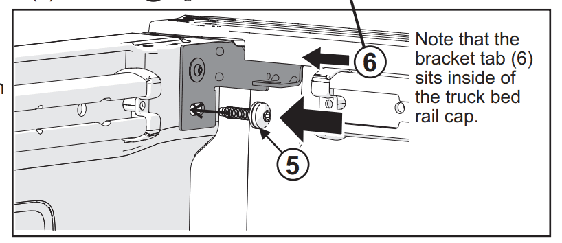

I also think it was a tonneau bracket mounting location. Some owners reported the hole was empty and others indicated it was threaded (do not know if is a nut welded in place, backing plate etc.)
It has been mentioned that you can get a bolt in the hole and (with some difficulty)a nut on the back. Or use a rivnut and thread in whatever you want.

Late to the party, but.
The bottom threaded hole is M8x1.25, the top hole is a guide, they are used by the factory tonneau cover.

DUH, i forget rivnuts exist sometimes. That might be a good option for me. Maybe even drill the hole slightly bigger for a bigger rivnut!
Go rivnut that hole! :facepalm:
