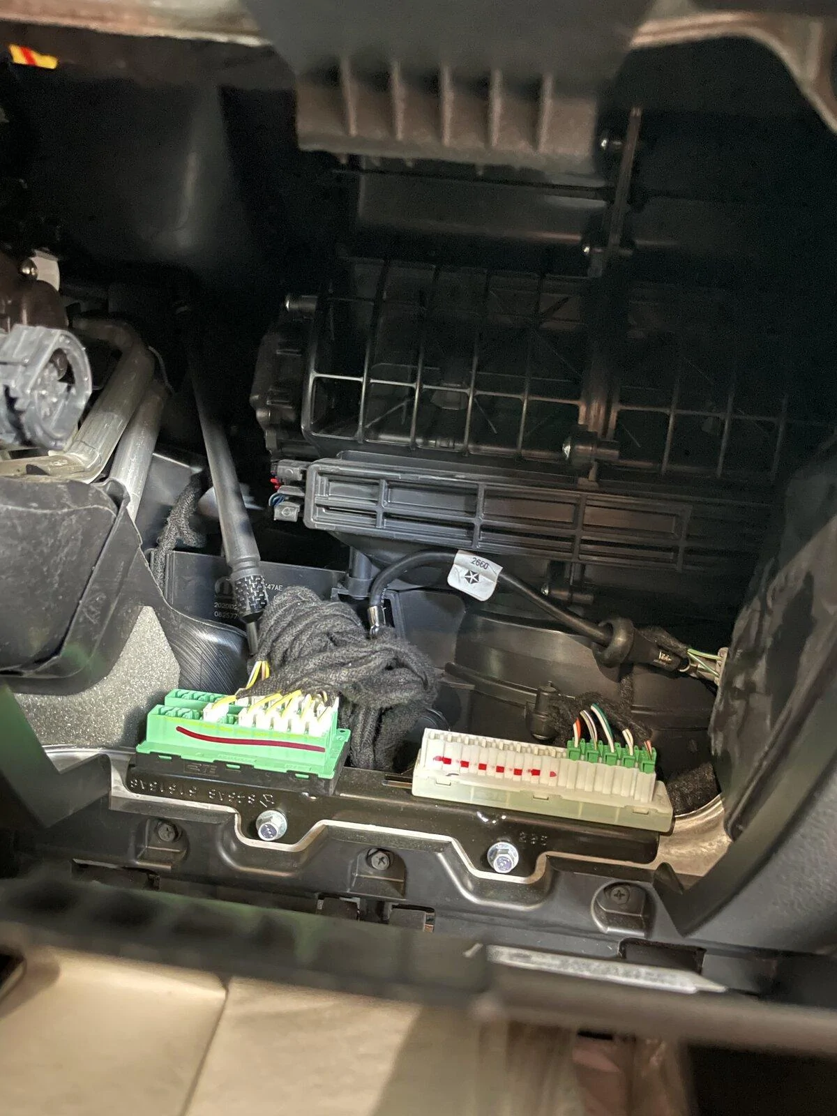

Moved mine under the dash. Still get pretty good reception.

Nice setup... With a good strong signal in a major city you don't even need an antenna.
