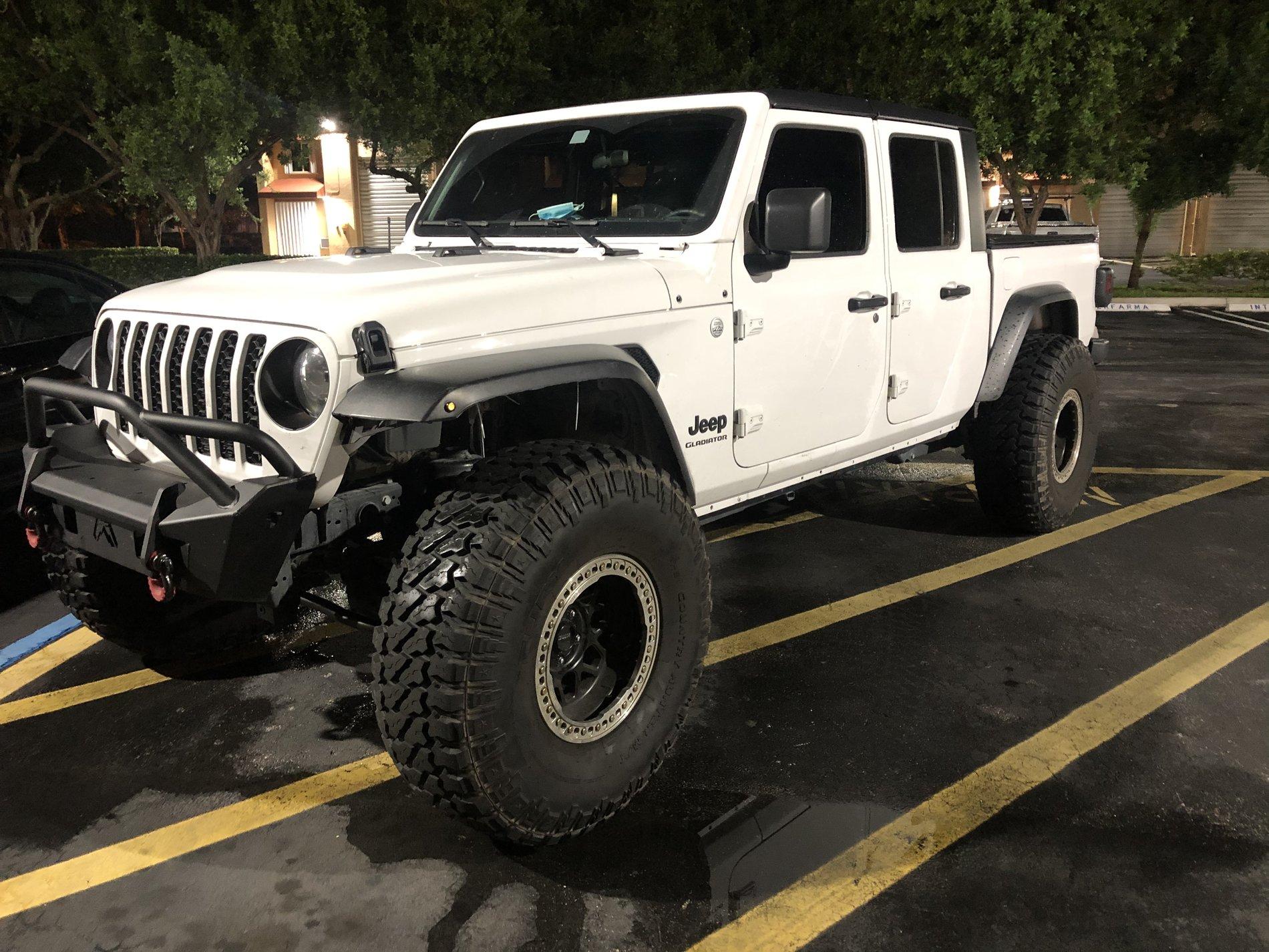

So this is the finished product. Ended up finishing late at night so still haven’t taken some good pictures in the day but real happy with it.
Cut the fender with an air cut-off tool and then sanded down the edges. The bracket provides great support for the fender.
Picture below for reference. If you have any questions feel free to message me any time.

Sweet looking rig! What lift and size tires?

Appreciate it! And its on 3.5in lift and 40x13.5x17

From what Ive heard the AAL lights don't exactly fit on the Sport Fenders, that's why i went with the rugged ridge brakcet but perhaps someone figured something out to make it work by now Lol
And I started on 37's and had no issues on the 3.5 in lift but when you go to 40's you will definitely have to do the fender chop. Rubbed a bunch whether I was turning into a parking space or making a u-turn. And if you have Rubicon rock rails you will have to trim them a bit so that the tire doesnt make contact because the rock rail extends a bit further than the body of the car in the front.
