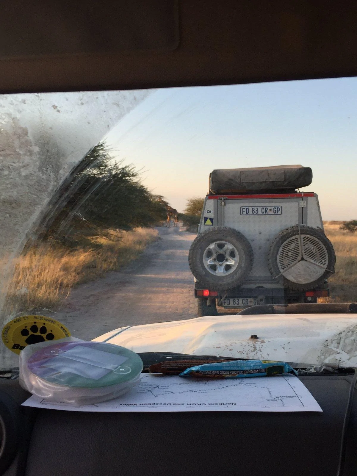

285/75/17 Cooper Discoverers. Great ride. Quiet. Great look.
We had Cooper’s on our Land Cruisers in Africa. We beat the snot out of them and held up remarkably well with our fully loaded rigs..
