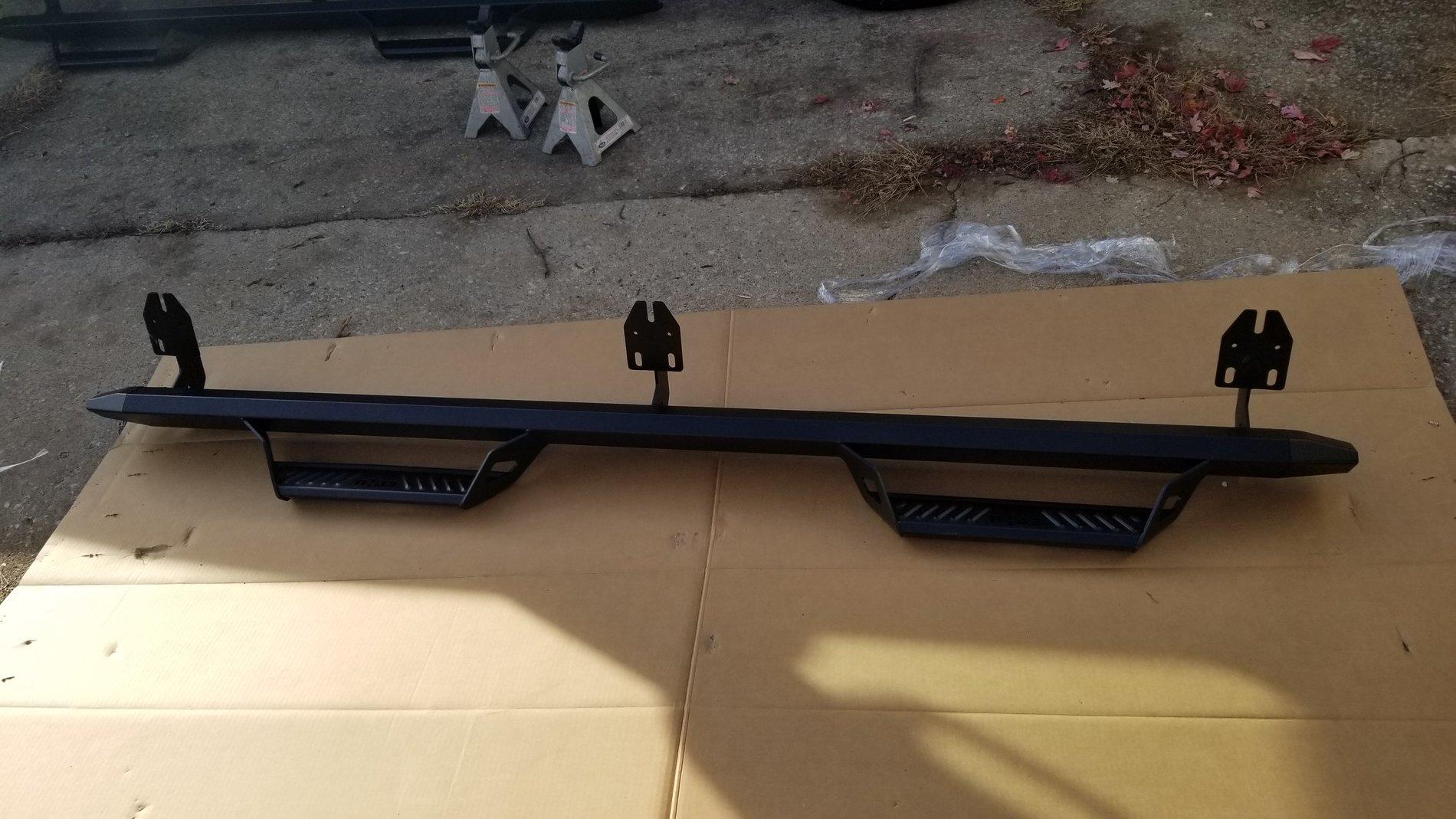

Has anyone else installed their N-FAB Predator Pro nerf bars themself?
I attempted to install mine today. The outside of the box clearly says they are for 2020 Jeep Gladiator:
However, the hardware kit & installation instructions say I've received the kit for 09-15.5 Ram trucks:
Furthermore, the steps look exactly like the ones on the install guide
The instructions said to drill holes for the top bold on each bracket. I though others on the forum have said these install on the JT with no drilling.
I've contacted the vendor who sold them to me, runningboardwarehouse.com...They're going to send me new ones & a shipping label to return these...
Just wondering if this has happened to anyone else???

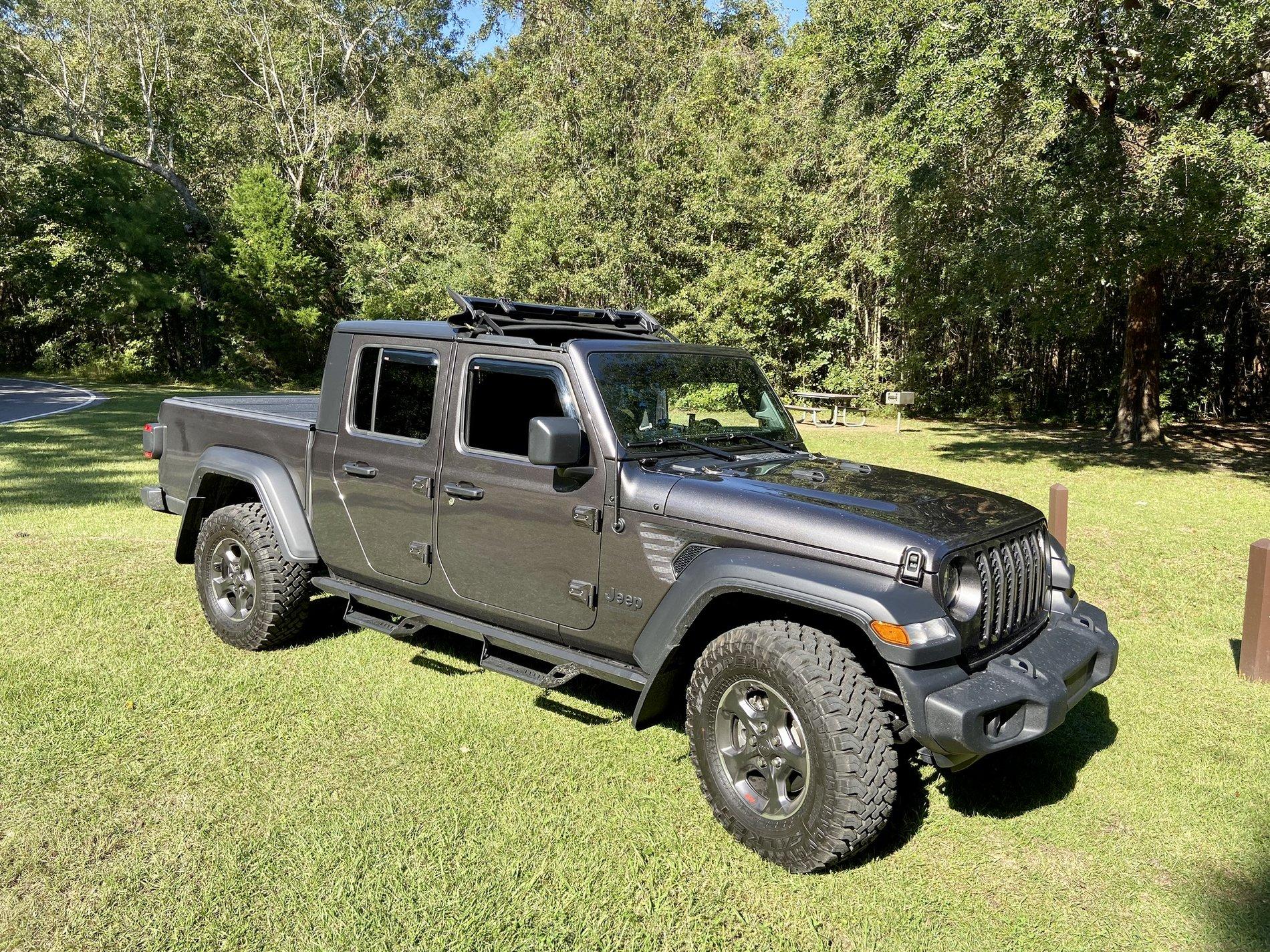

Did yours look like my picture?
Yep, just like yours. I thank they have done some upgrading of the mounting. The instructions that came with mine showed the mounts to be separate and needing to be screwed on to the rail.

One thing, the end to the front is the longer distance before the step. Yours looks laid down backwards. Hope this makes sense.

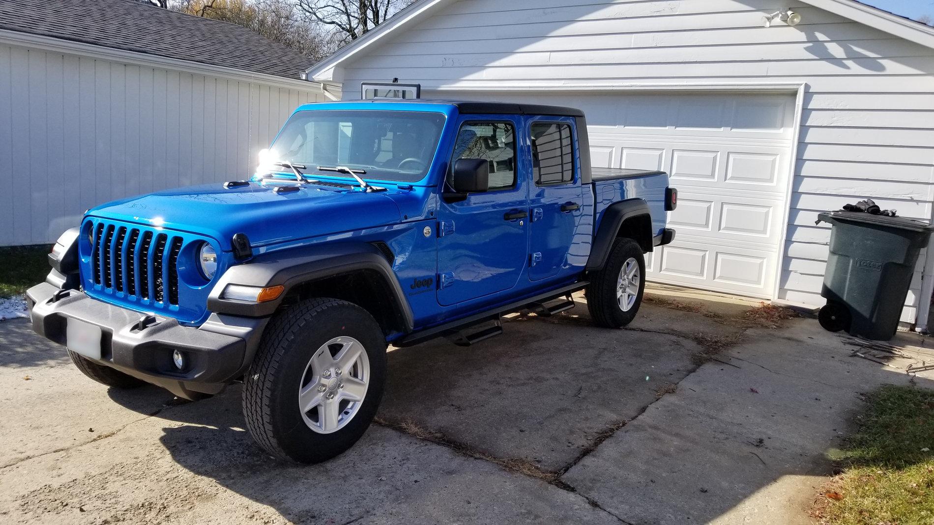

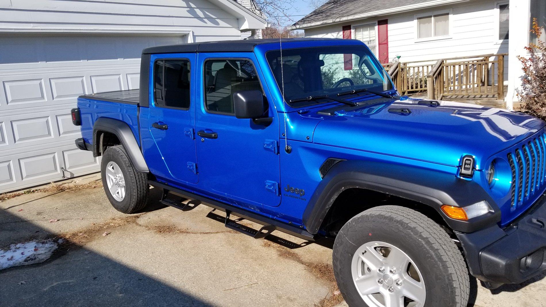

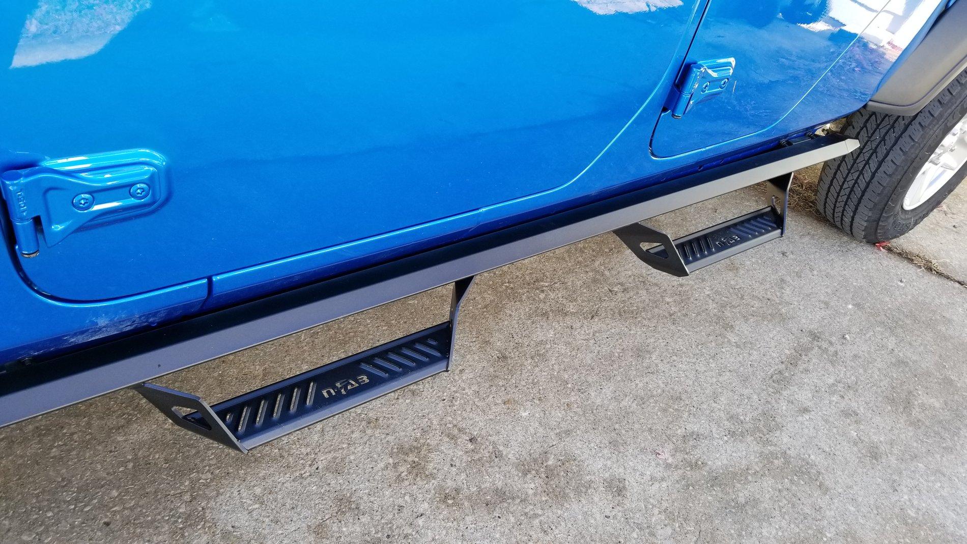

Update: runningboardwarehouse.com (aka Real Truck) has done an outstanding job of fixing this issue. I re-boxed the incorrect ones as best as I could. Fed Ex showed up yesterday (11/13) to get the wrong ones, and the *CORRECT* steps arrived today.
Steps bolted on, no problem!
Looks like they updated the hardware -- the instructions said to put the clip nuts on the rails before installing on vehicle -- hardware included were normal nuts (that were kind of a PITA to get started given the space between the step & truck)...

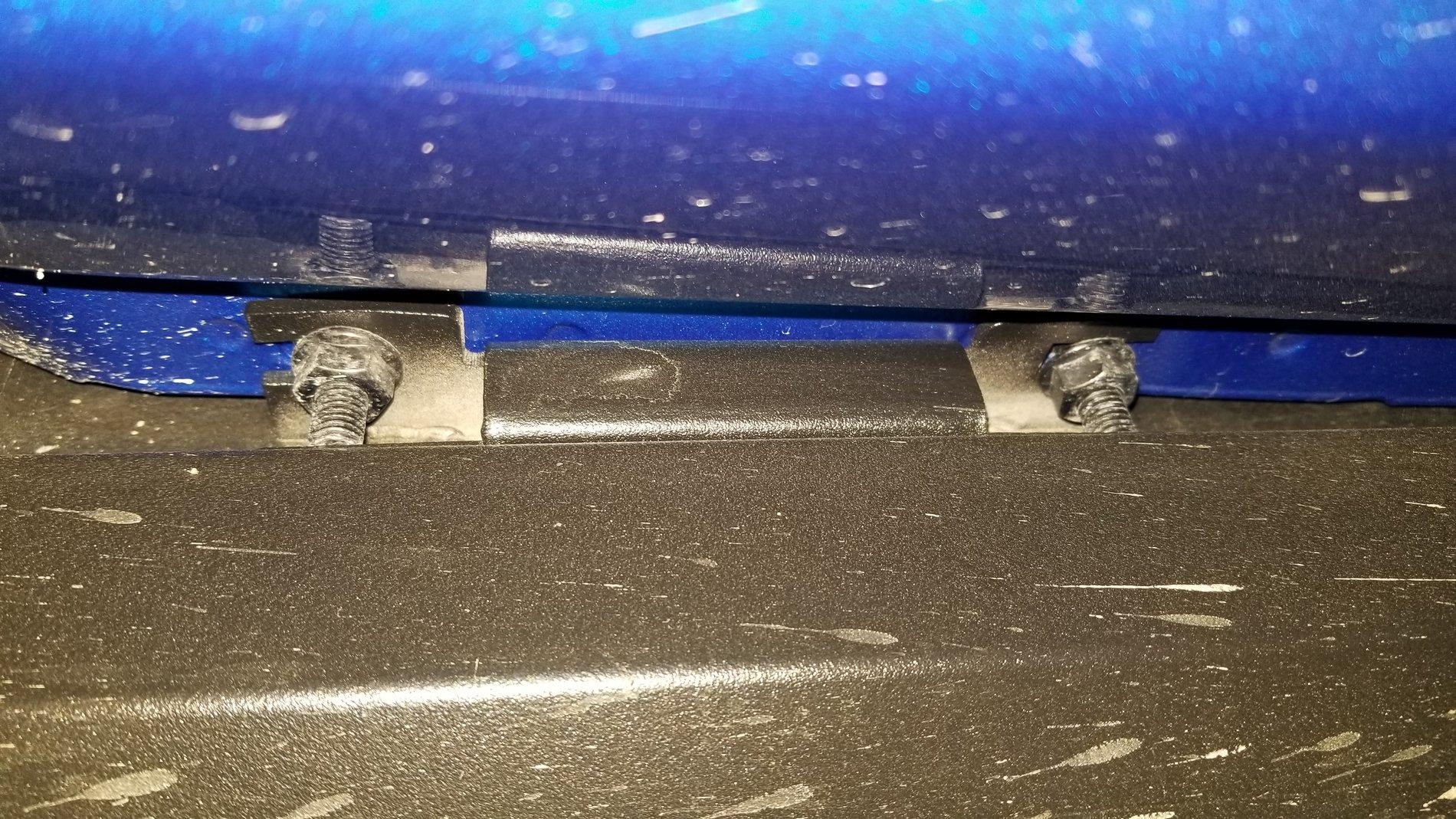

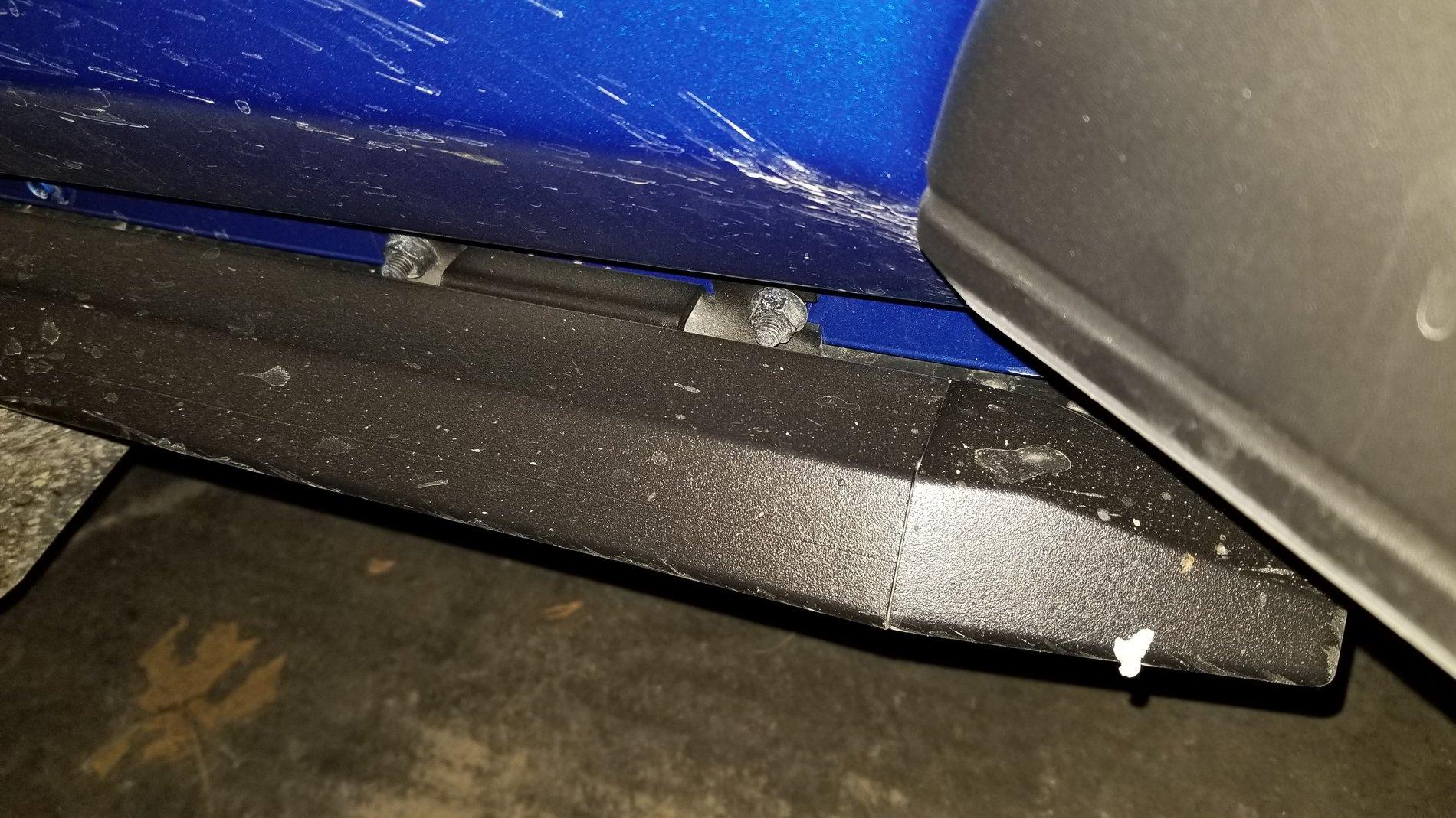

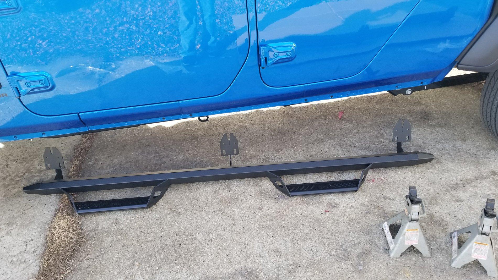

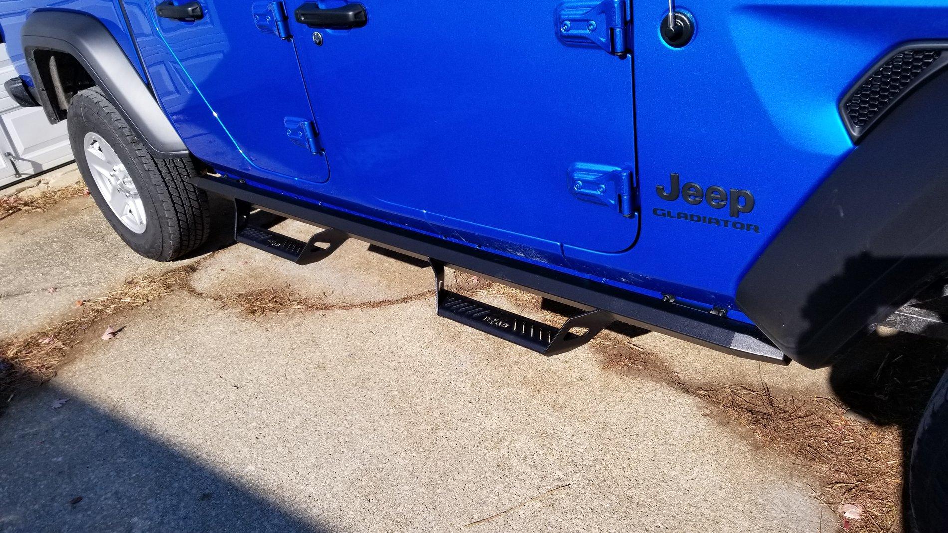

They are just nuts -- no clips. As I said before, it was a pain getting them started since there isn't much space down in there to hold the nut & turn it, etc...
Here's the rear:
Here's the front:
Not sure if I assembled it correctly -- not enough space to put the bolts/nuts the other way. Assembly instructions still showed the clip on nuts.
Here's the rear:
Here's the front:
Thank You. Mine were different than yours and did not have nuts that’s why I wanted to see how you put them on since mine would fasten the way they said to use them. I had to reverse them.
