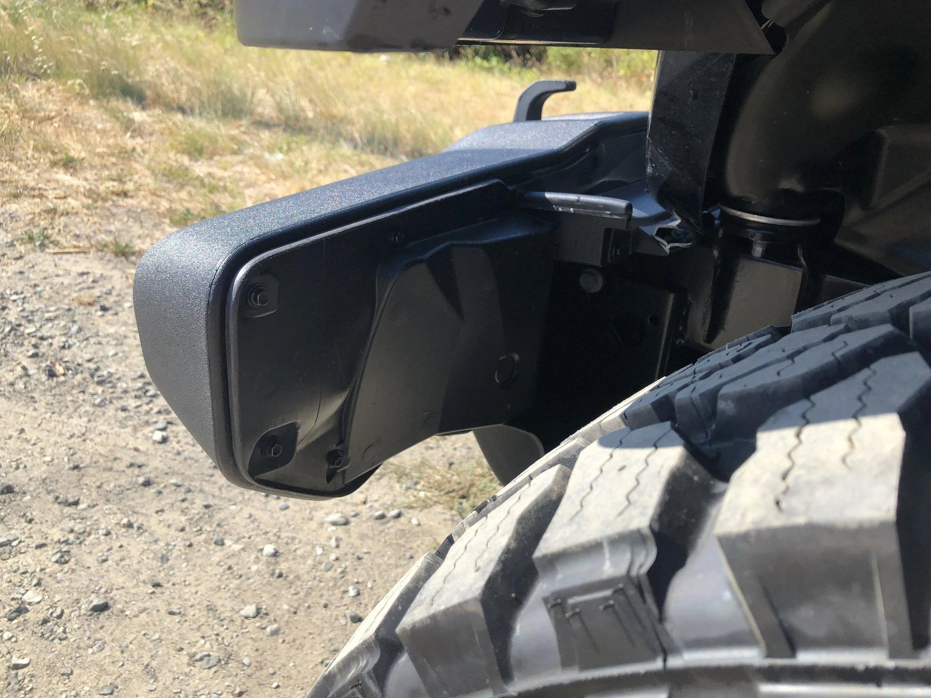

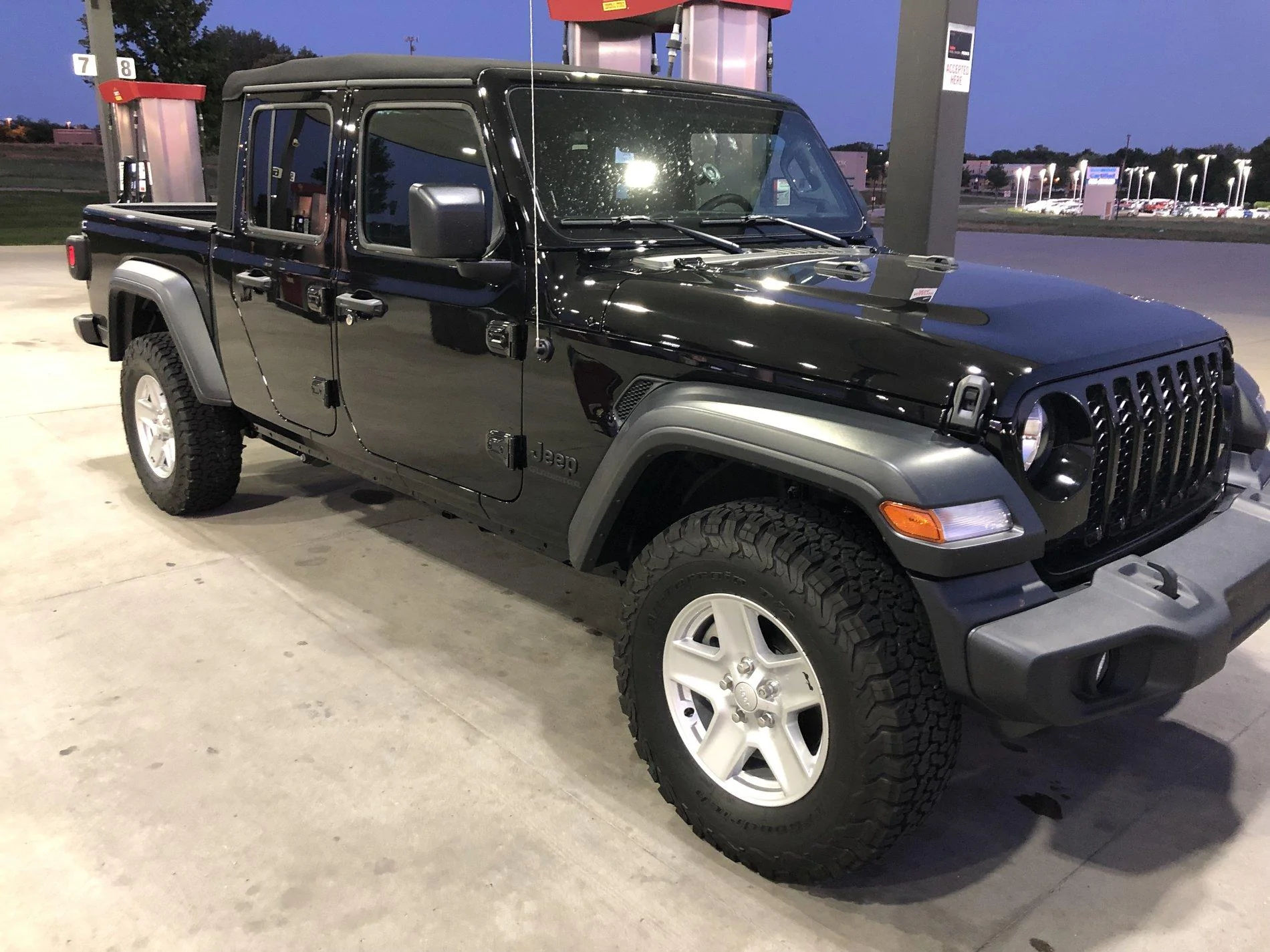

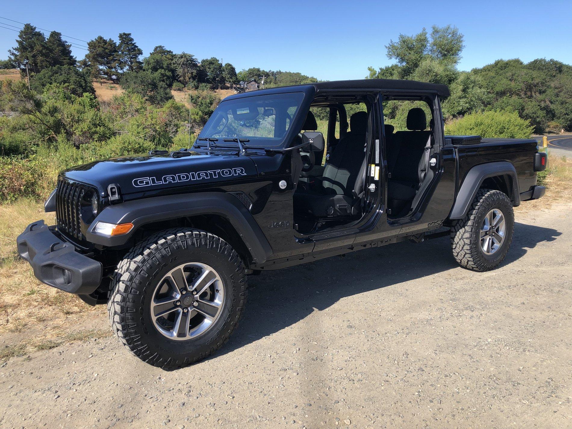

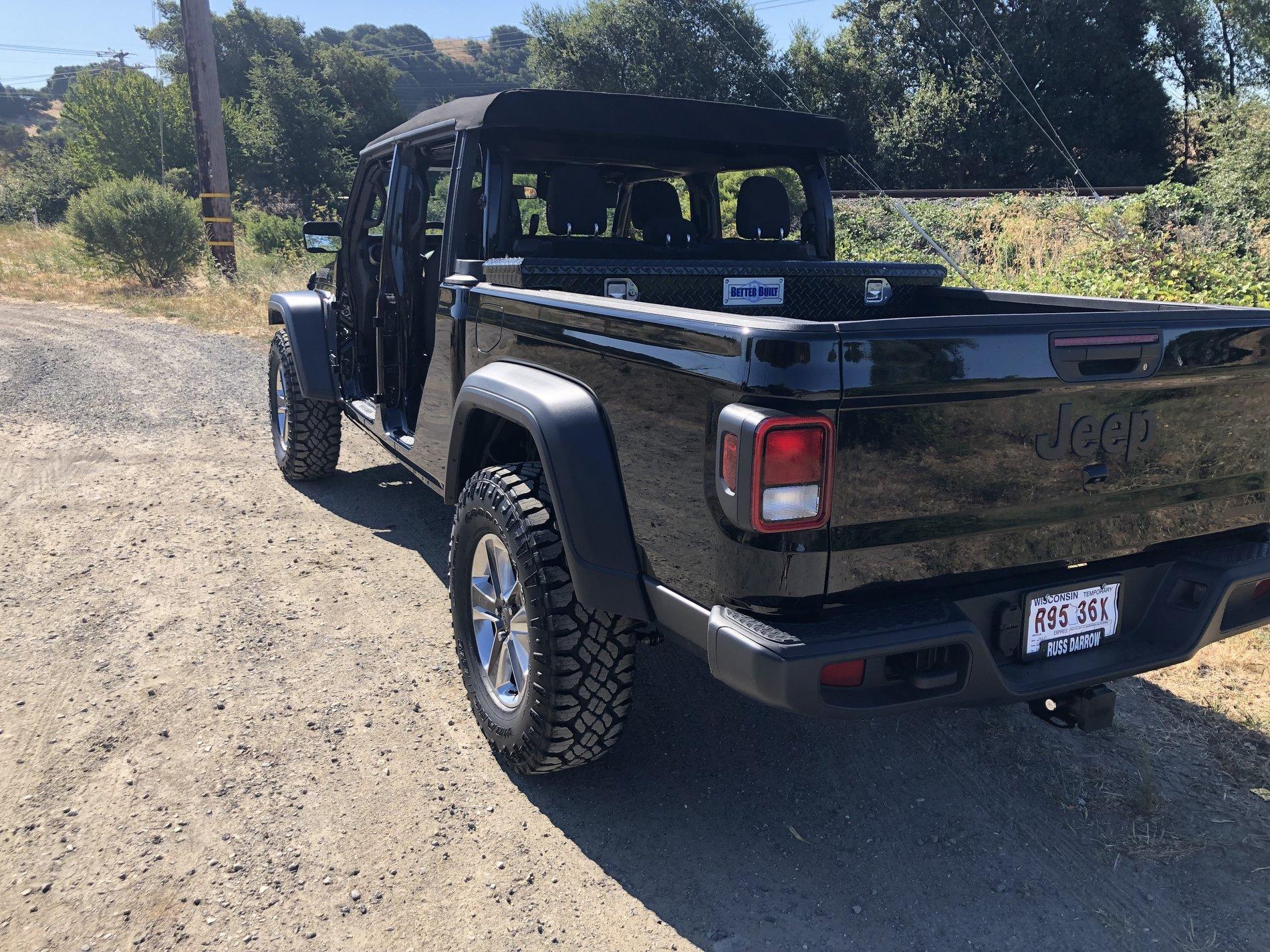

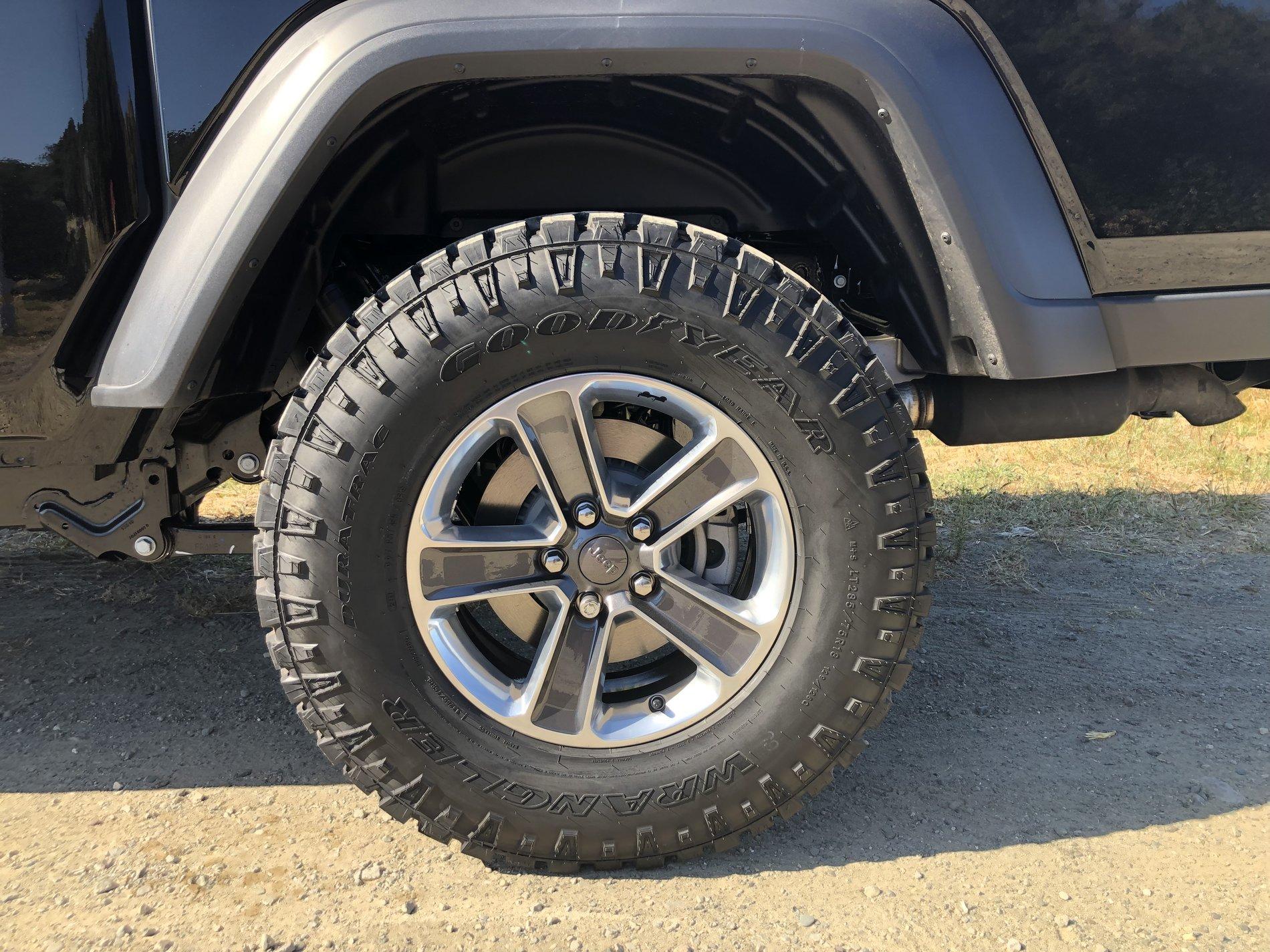

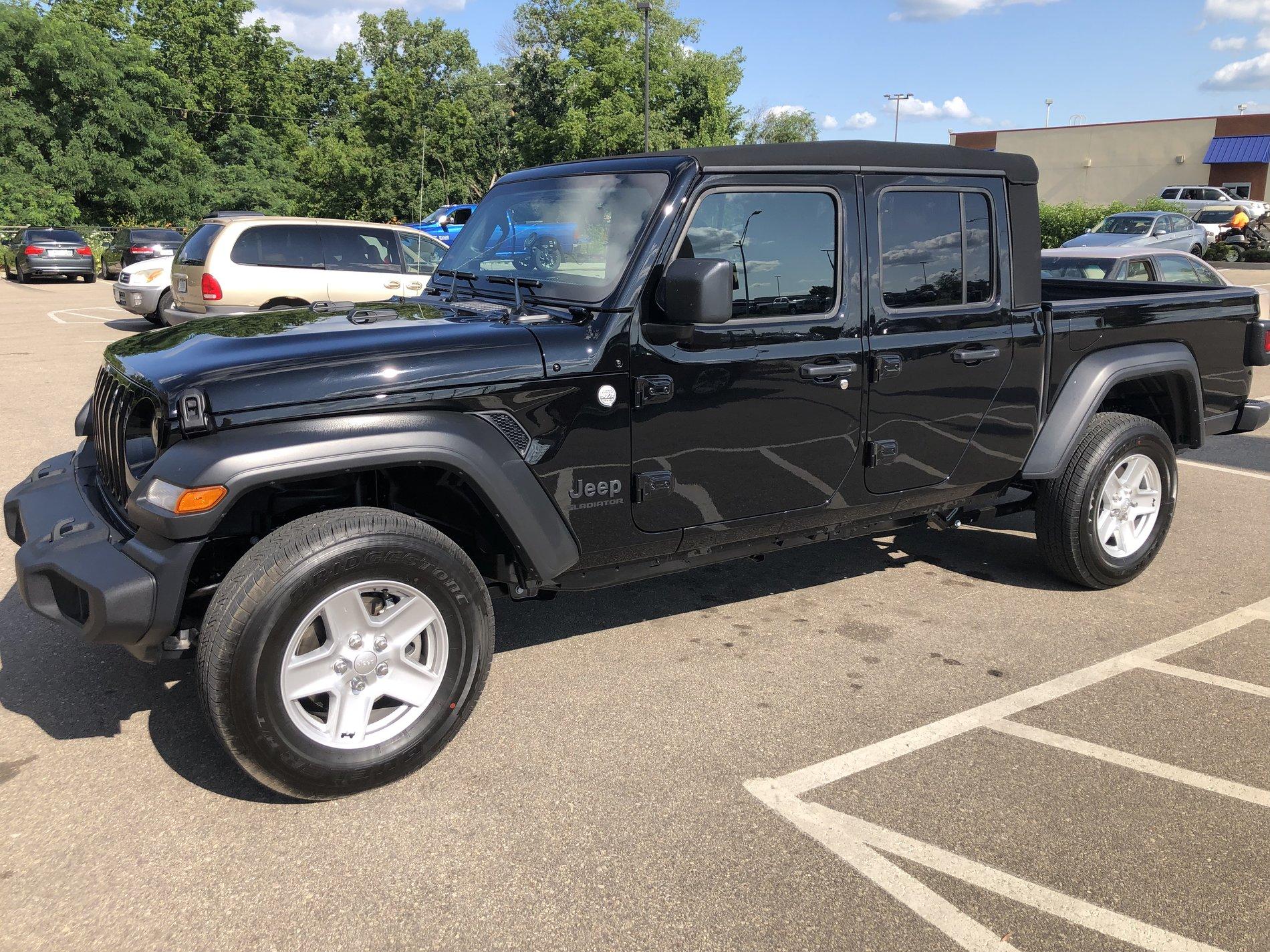

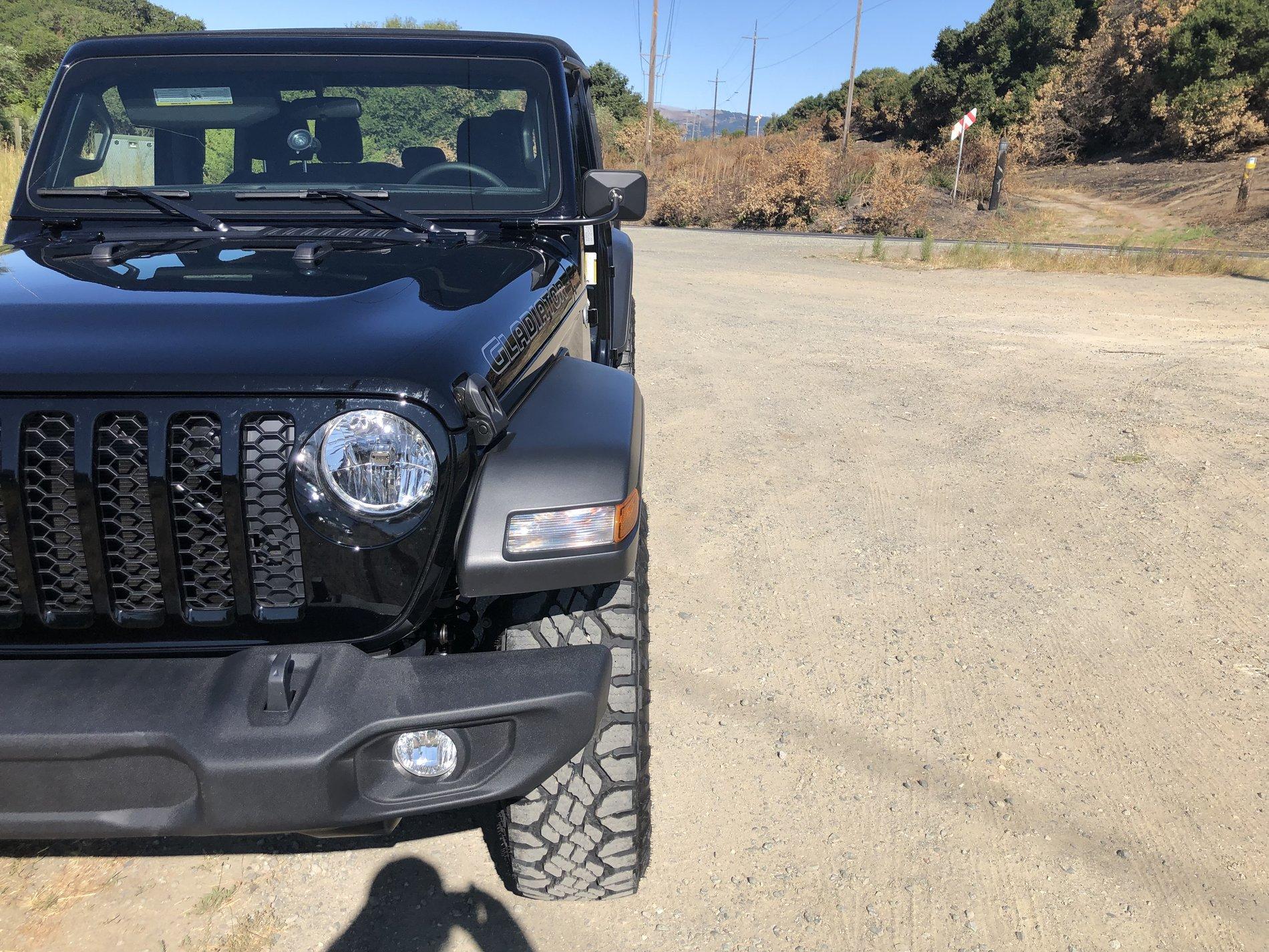

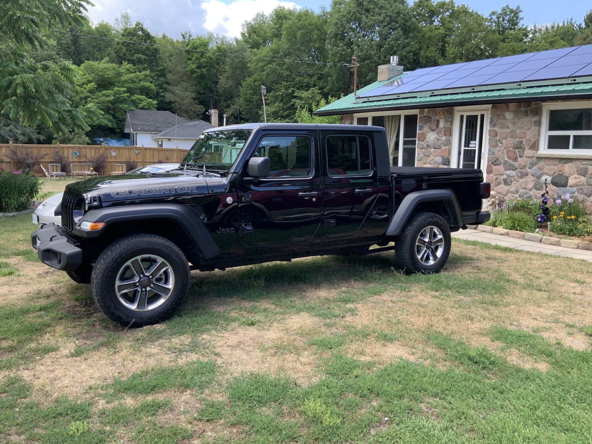

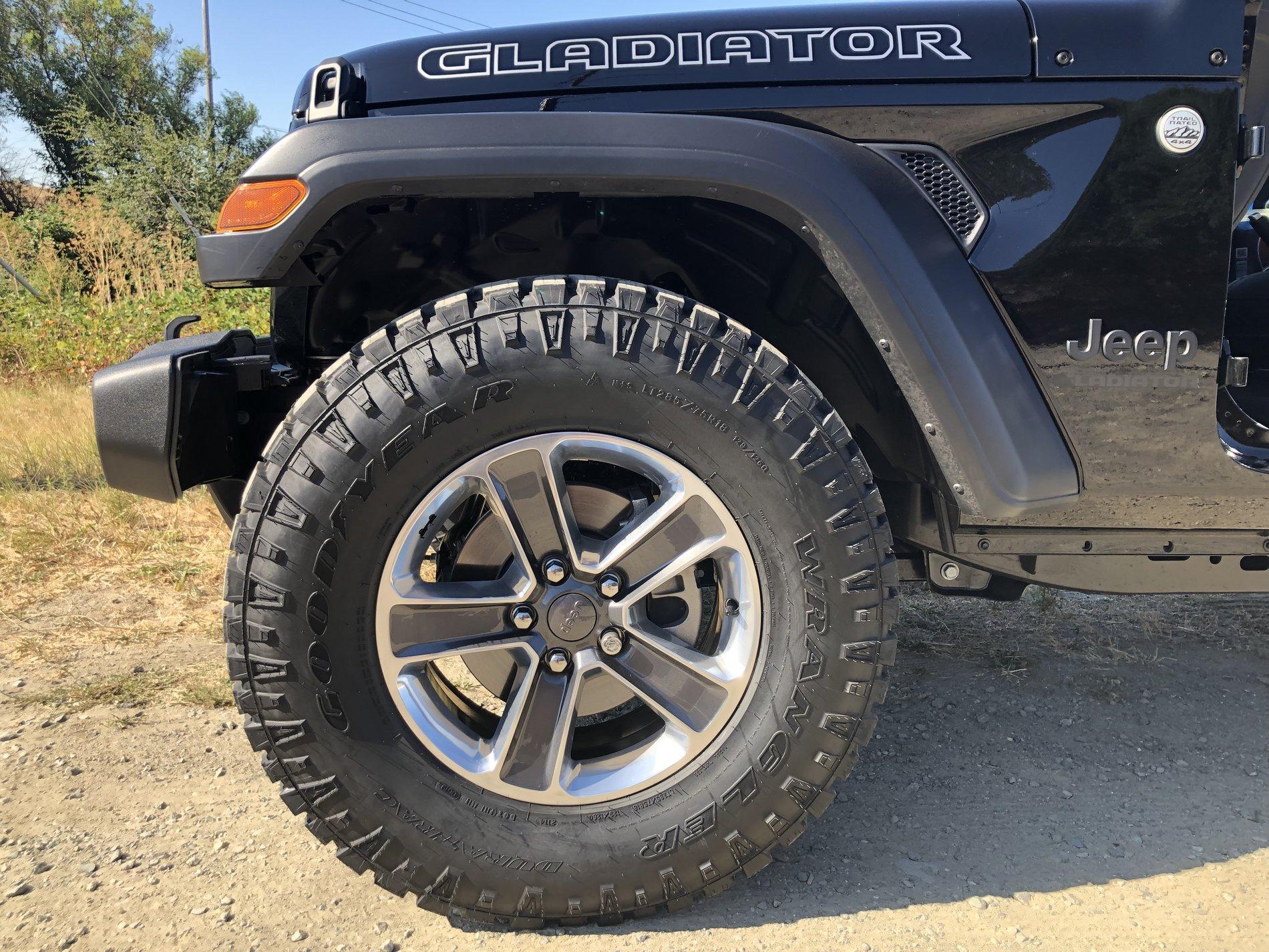

I have a Sport S, it came with the 245/75 r17. I initially upgraded to some 285/70 r17 (33”) BFGoodrich KO’s and liked the look but wanted to go bigger but not wider. I decided on 285/75 R18 (35”) Goodyear Wrangler Duratrac. Found some used 2019 Sahara 18” wheels cheap and had the new tires mounted. I really like the look of the large narrower tires. There is absolutely no rubbing although I did have to trim the plastic bumper to fender filler (real pain, overkill on the screws). I trimmed those and put them back in to cover fog light recess. The new tires are only 11.25” wide and don’t stick out beyond fenders. I have a 6 speed manual and actually find it feels better on the 35” verses 33”. But I plan on towing so a regear is in my future though.
I have included pics with factory, 33” and lastly 35”
Thoughts?

That's the size I'm planning on running. Not until I can find a lift of about 3" I like though. Looks great but for off road use disconnected on a Sport S I imagine there would be some pretty good rubbing. Thanks for the pictures! I can't decide between the duratracs or Cooper AT3 XLTs.

That looks fantastic. I am taking delivery of overland hopefully this week and have Cooper AT3 in exact same size; I may put on a level which I have also but not completely sure yet. Either way- it looks very good in my opinion; perfect size.

Why 18” rims? Can you get a “C” rated tire or even a “D” rated tire?
You’ll hate “E” rated tires. Way to harsh with a light truck.

It was one of the only ways to get the height with narrow footprint. I actually had same Goodyear Wrangler Duratrac size 315/70 r17’s on my JKU and liked the ride. And as a matter of fact these feel better on the Gladiator.

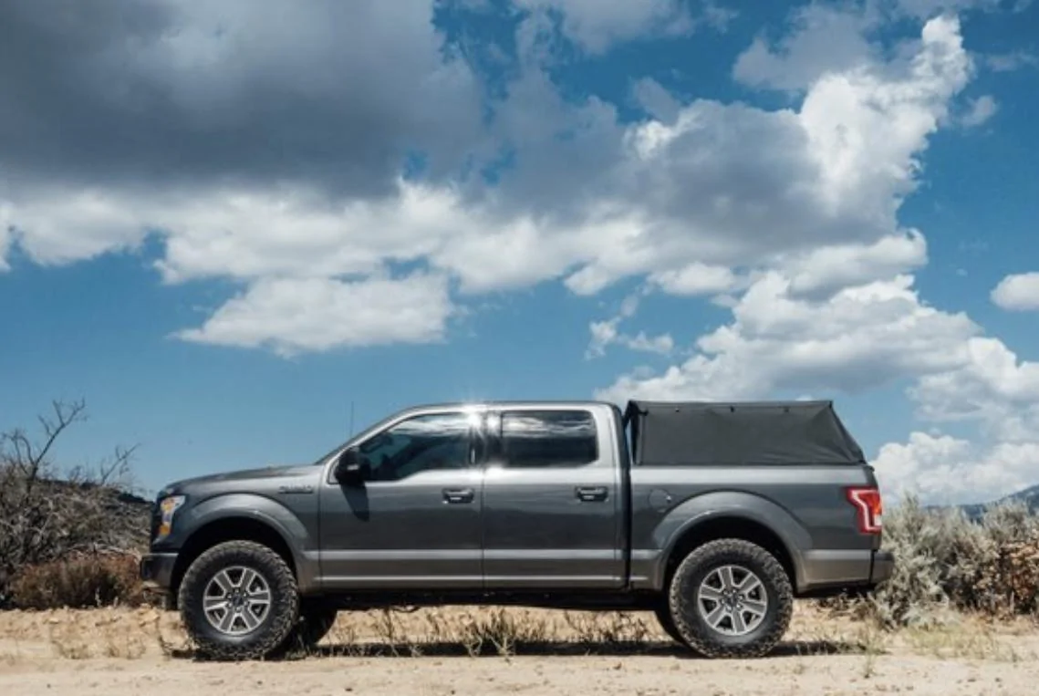

I think the 75 ratio is perfect for a vehicle that sees off-road and off-road duty.
Here’s a pic of my last F-150 with 285/75R18s

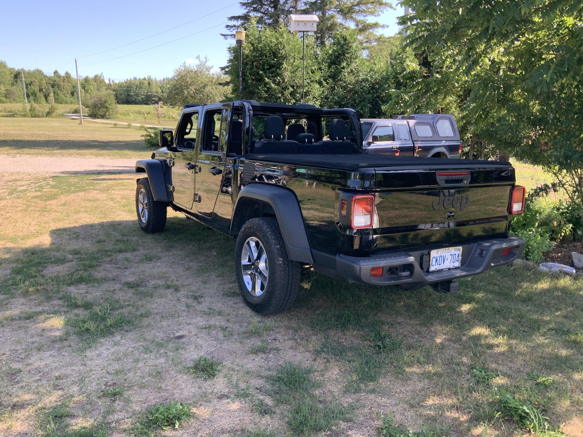

Very nice, picked up same rims stock tires new, 35s look great
