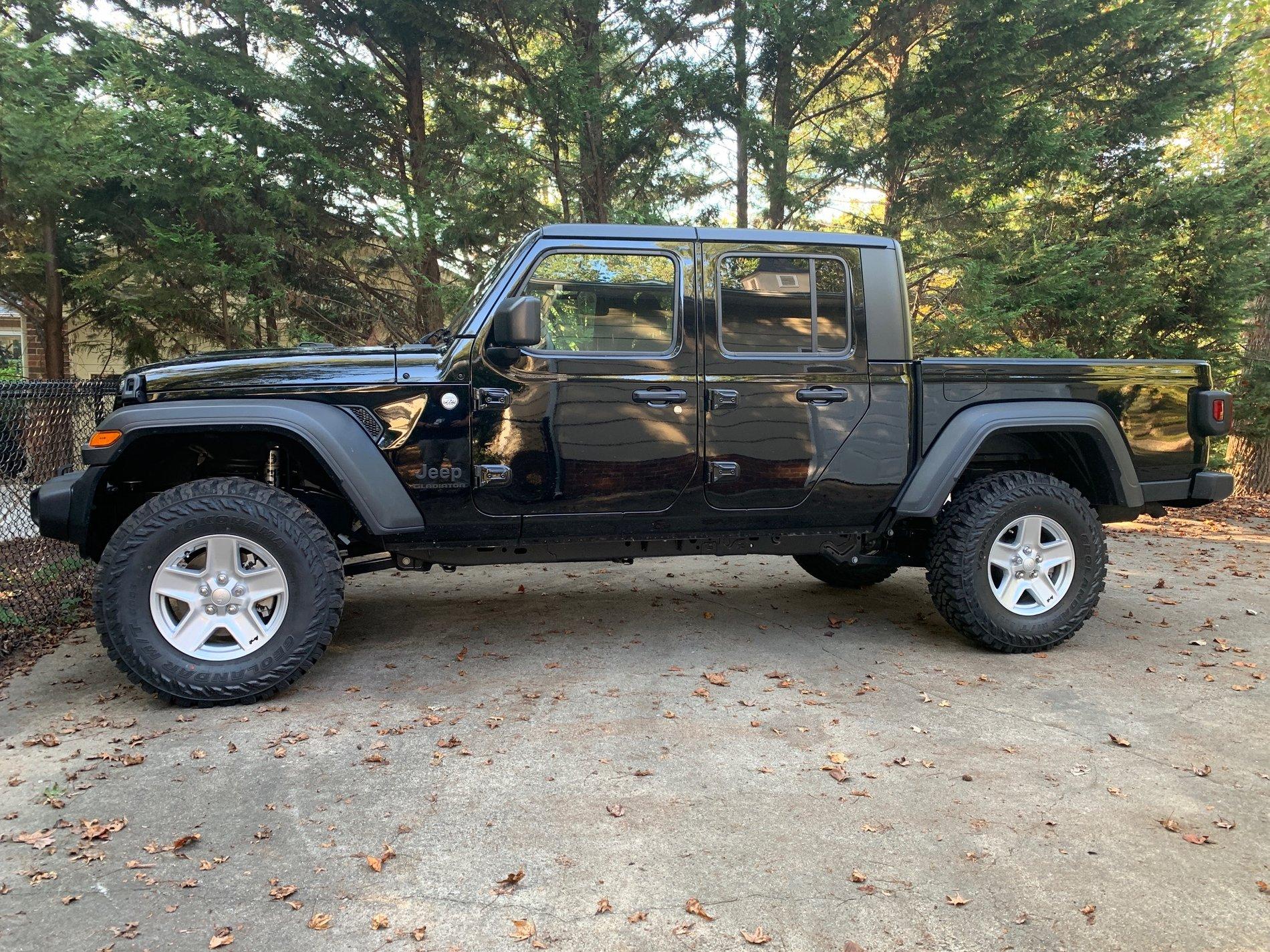

If you're keeping stock wheels, do a 285/75-17. Mine are a 34.1" tall tire when new (35's are roughly 34.5-34.75) but are narrow enough for stock wheel width. I have the Mopar lift which netted me 2.5" of lift. I think it looks good.
When these tires are done I plan on doing Rubicon fenders and 37's with new wheels.

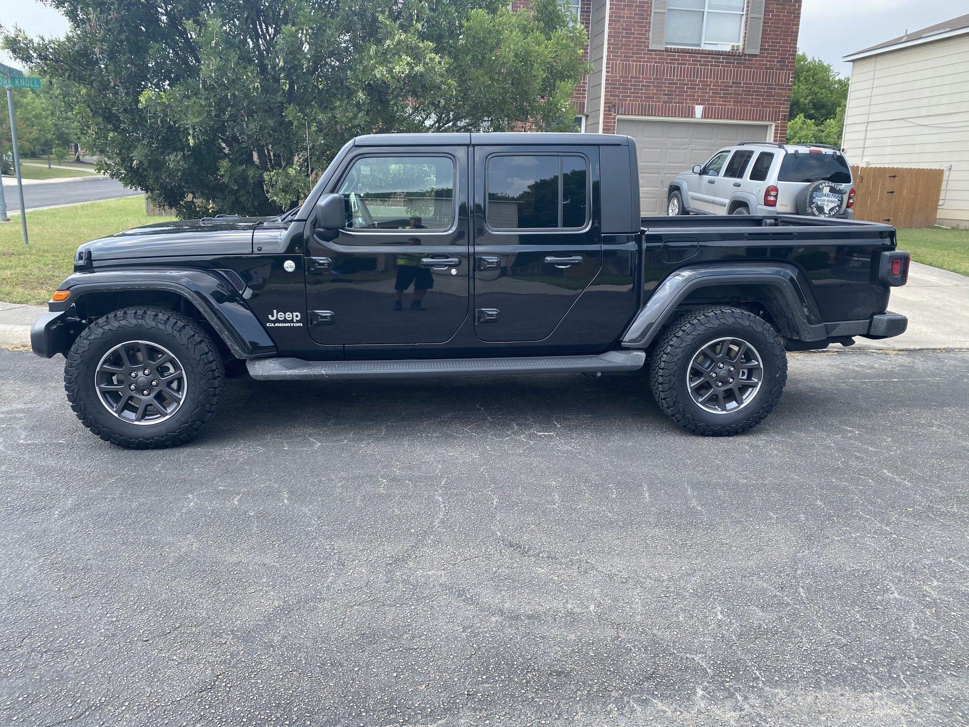

Jeep Gladiator Anyone got pictures or thoughts on 2.5” lift with 33” tires? IMG_2181.JPG
That looks good.
I currently have 275/70 on my 18” stock wheels. They come out to like 33.2x11.2.

That looks good.
You have an Overland? They may look a little small, but not terrible.

Yea an Overland. I’d be happy for awhile if it comes close too looking like yours.
Should be really close. Just go for it!
