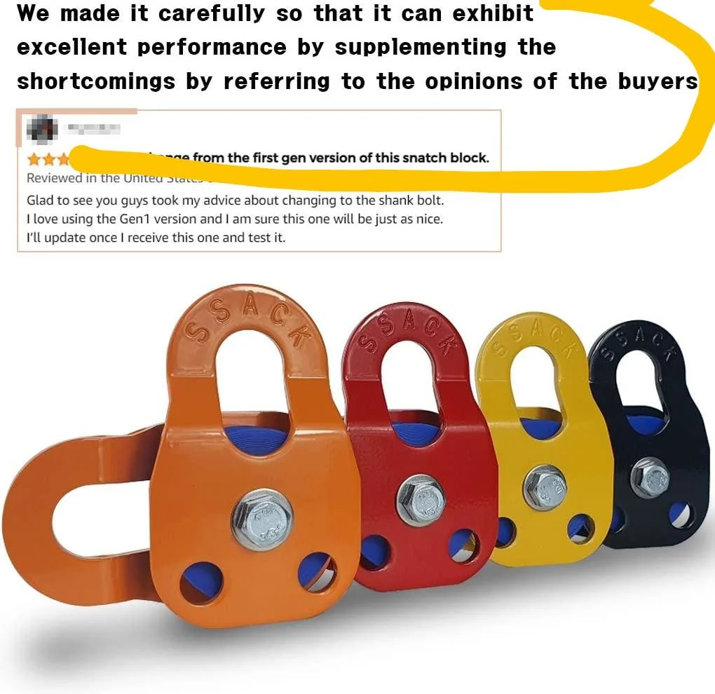

Reading the description of the snatch block doesn't give me a warm fuzzy. Sounds like they had some issues in the past, but they have addressed them to a point.
  • The Roller is Made of new Material,so it"s Strength is very good,it is safe using ananti-loosening Nut,and a high-strength Bolt with heat treatment is used.
  • Now this model provides better quality snatch blocks than the previous model. The surface of the previous model was rough, but the current model is smooth by painting with a very good surface treatment. And replaced with high-strength shank bolts, a little more Provides improved performance.

Jeep Gladiator anyone have any experience with these snatch blocks? 611izSrhN8L._AC_SL1500_~2
As long as it doesn't break and hit you in the ssack you will be fine, but that dialog isn't a confidence builder
