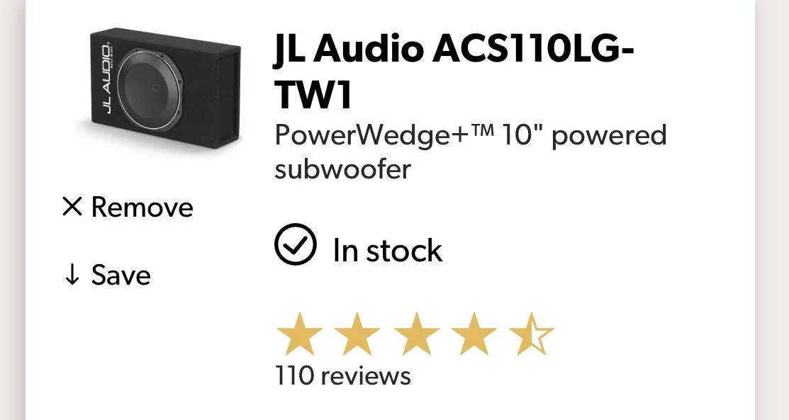

I was thinking about ordering this. I’m not sure if it’ll fit under my seat though

I’m not sure about figment with the storage but I think it should def fit without storage.
Here’s the dimensions 18.5"W x 11.125"H x 5"D
I looked them up and that’s why I said it should have no problem without storage. I removed mine so I don’t know the dimensions inside storage. I know the bottom of my box is 13 wide so 11.125 would be almost couple inches in from edge of seat
