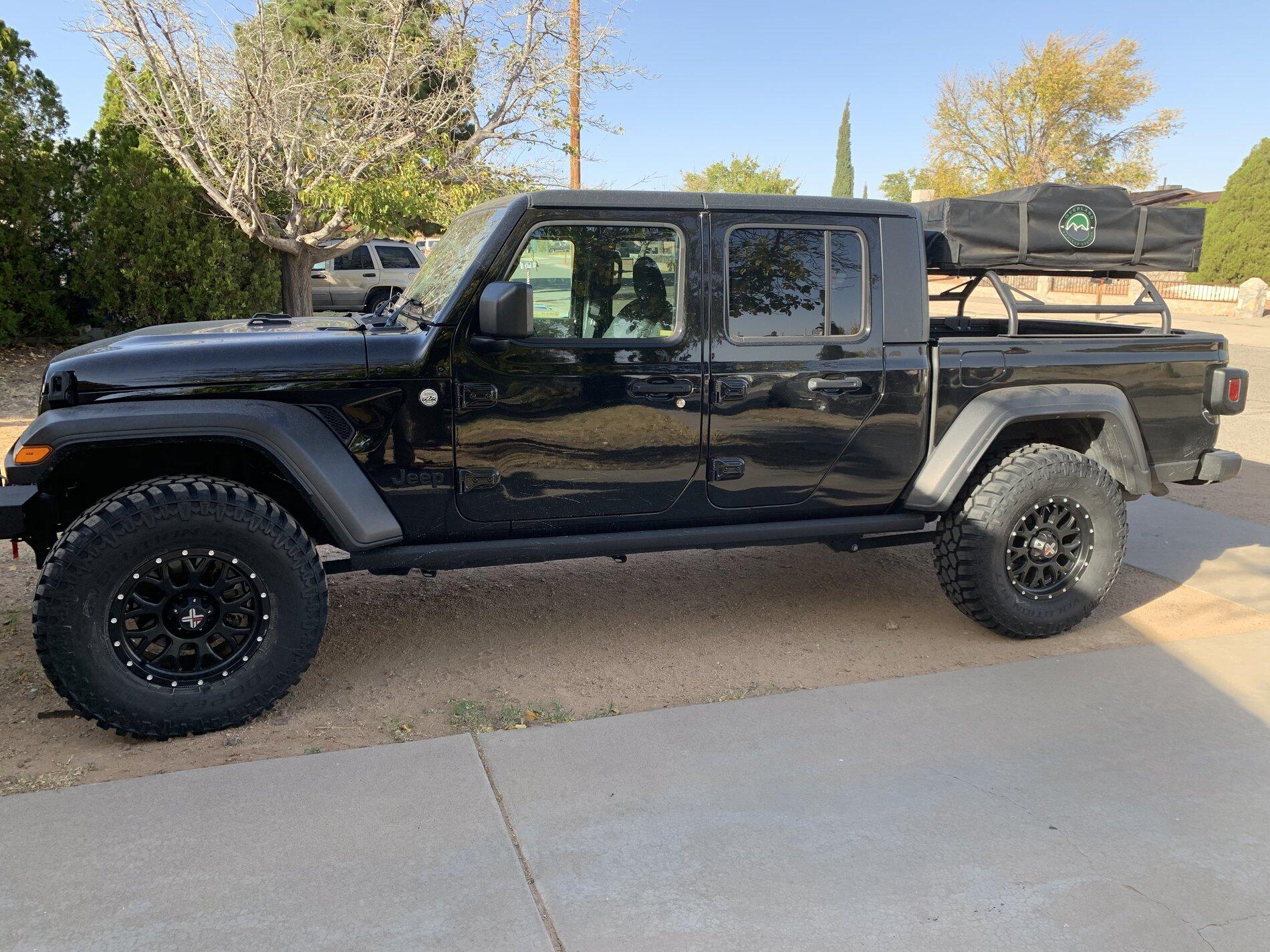

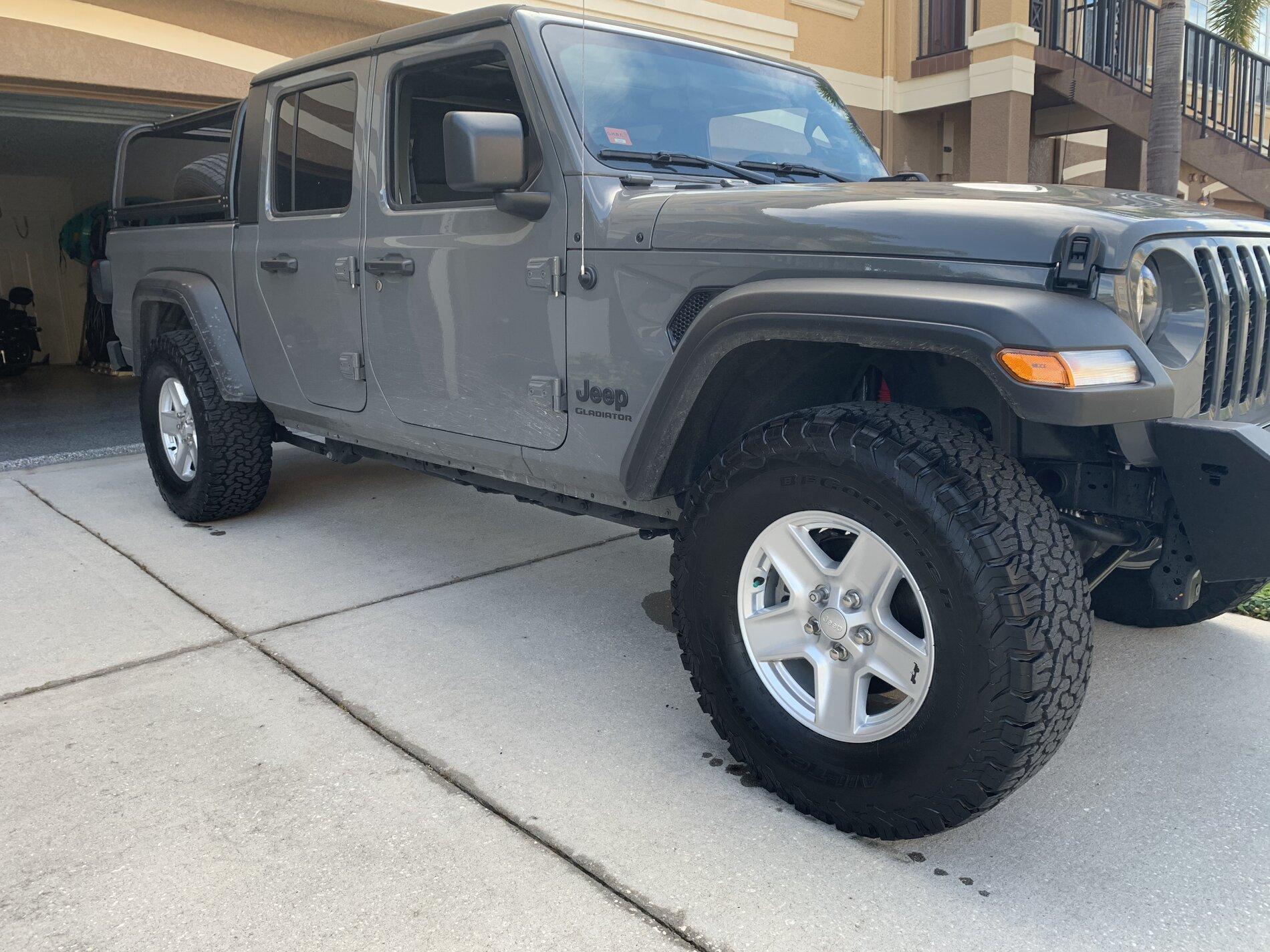

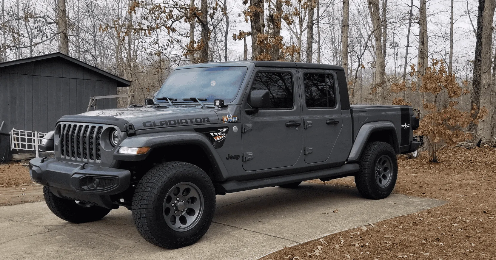

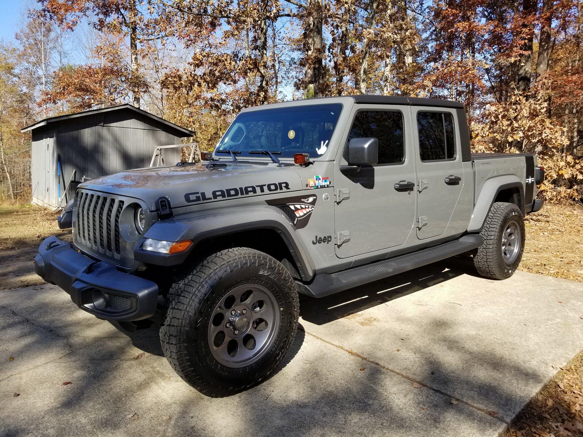

1.5” TeraFlex in the front. Nothing in the rear. Here is a better picture
Jeep Gladiator Anyone have pictures of their 1.5" Spacer Lift in the front ONLY? B03BB0DA-A673-42DA-AD40-EB134759A129
Looks great! Do you happen to have any measurements from tire/ground to fender? Did you install them yourself?

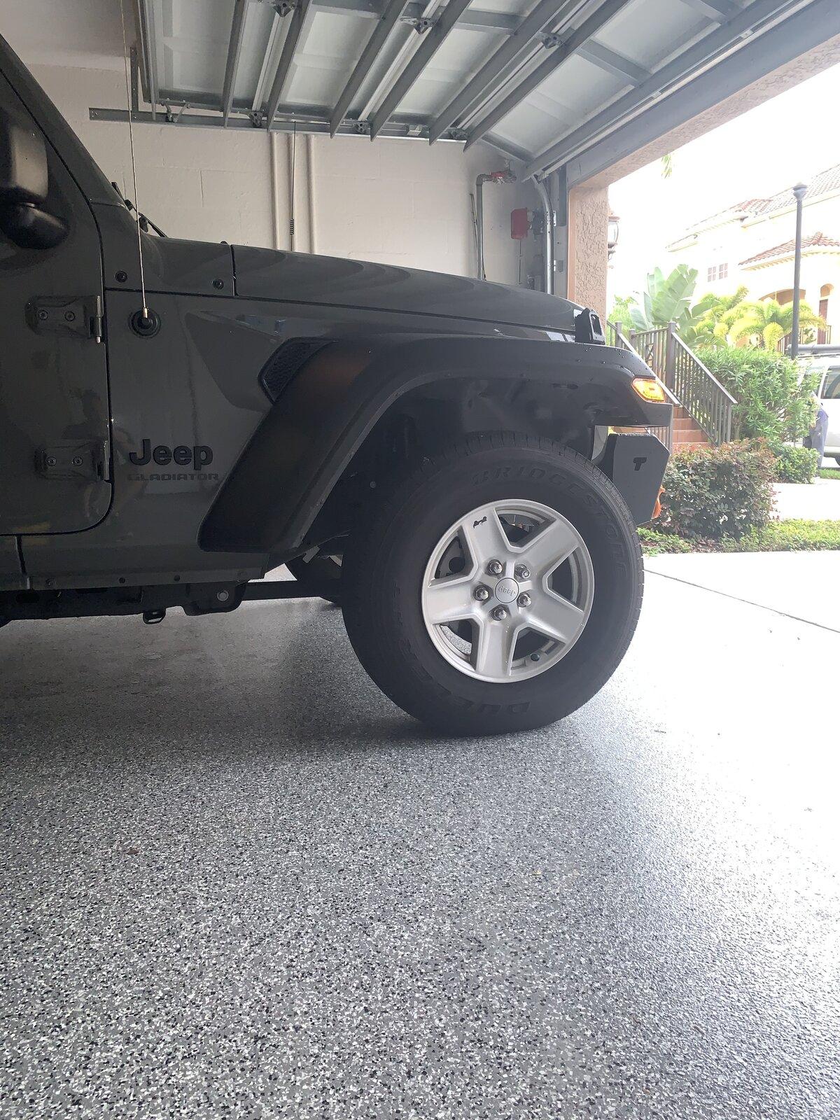

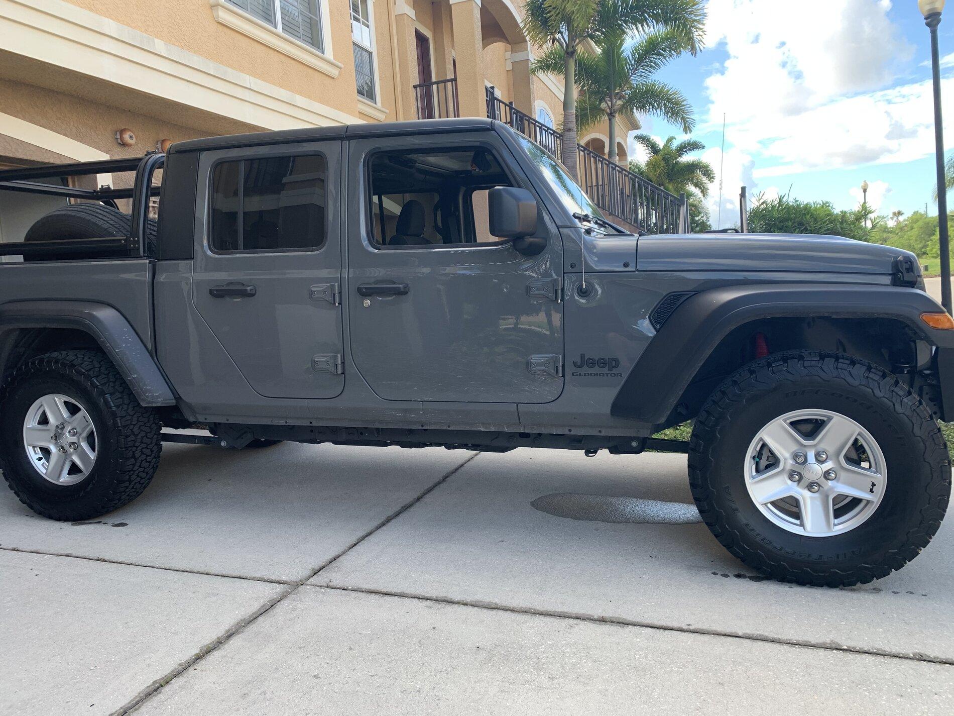

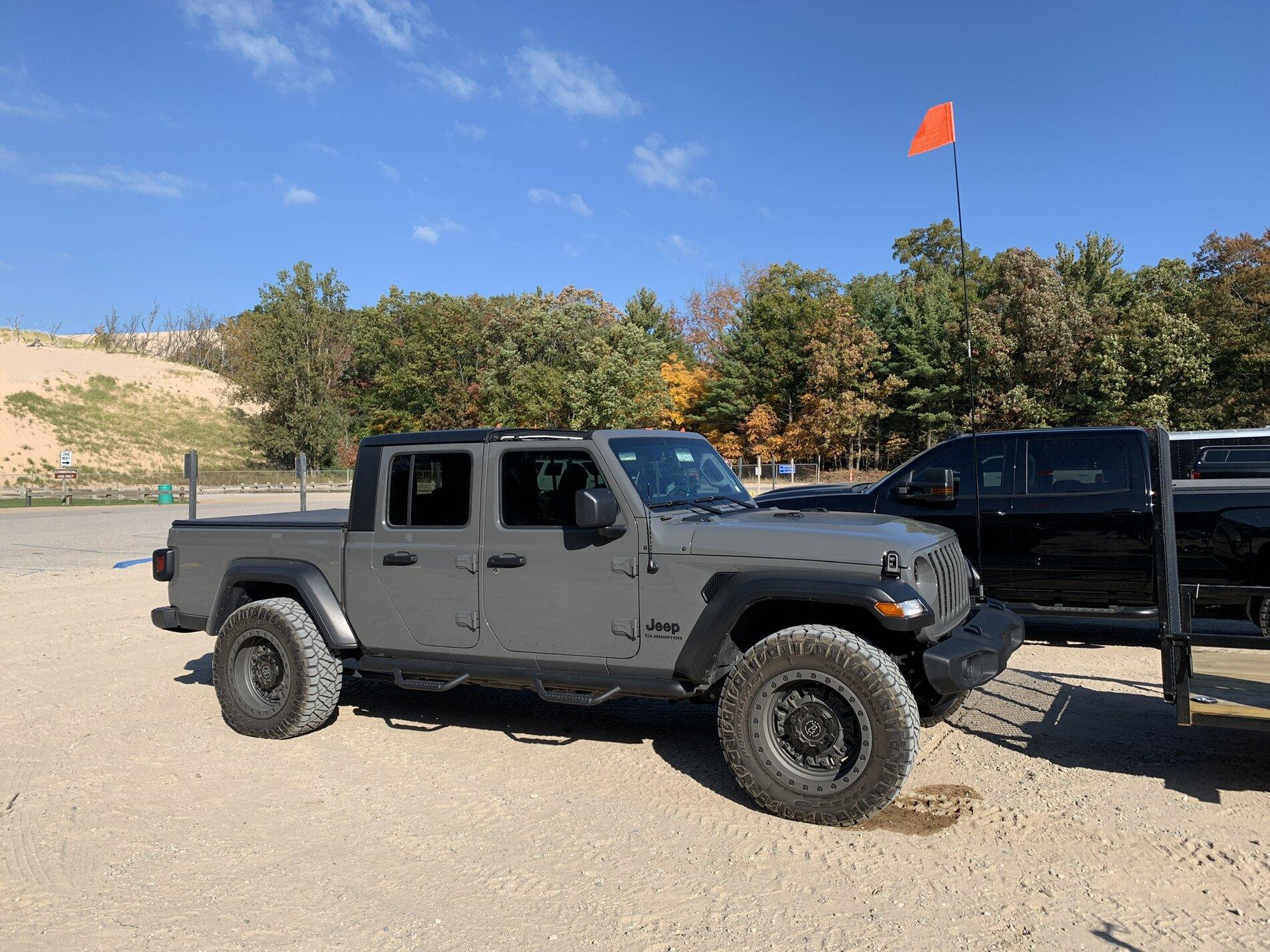

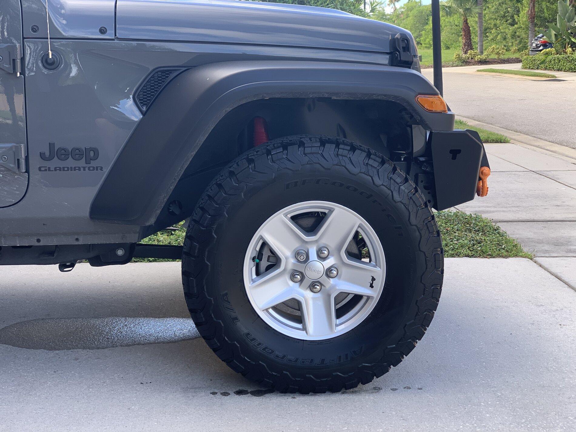

Same Rancho leveling kit on mine. Nothing in the back. First pic is with stock tires. The last 3 are with 315/70/17 BFG KO2s takeoffs from a Raptor.
Deleted member 24880
Approx. 39” from to fender and 5” from tire to fender.

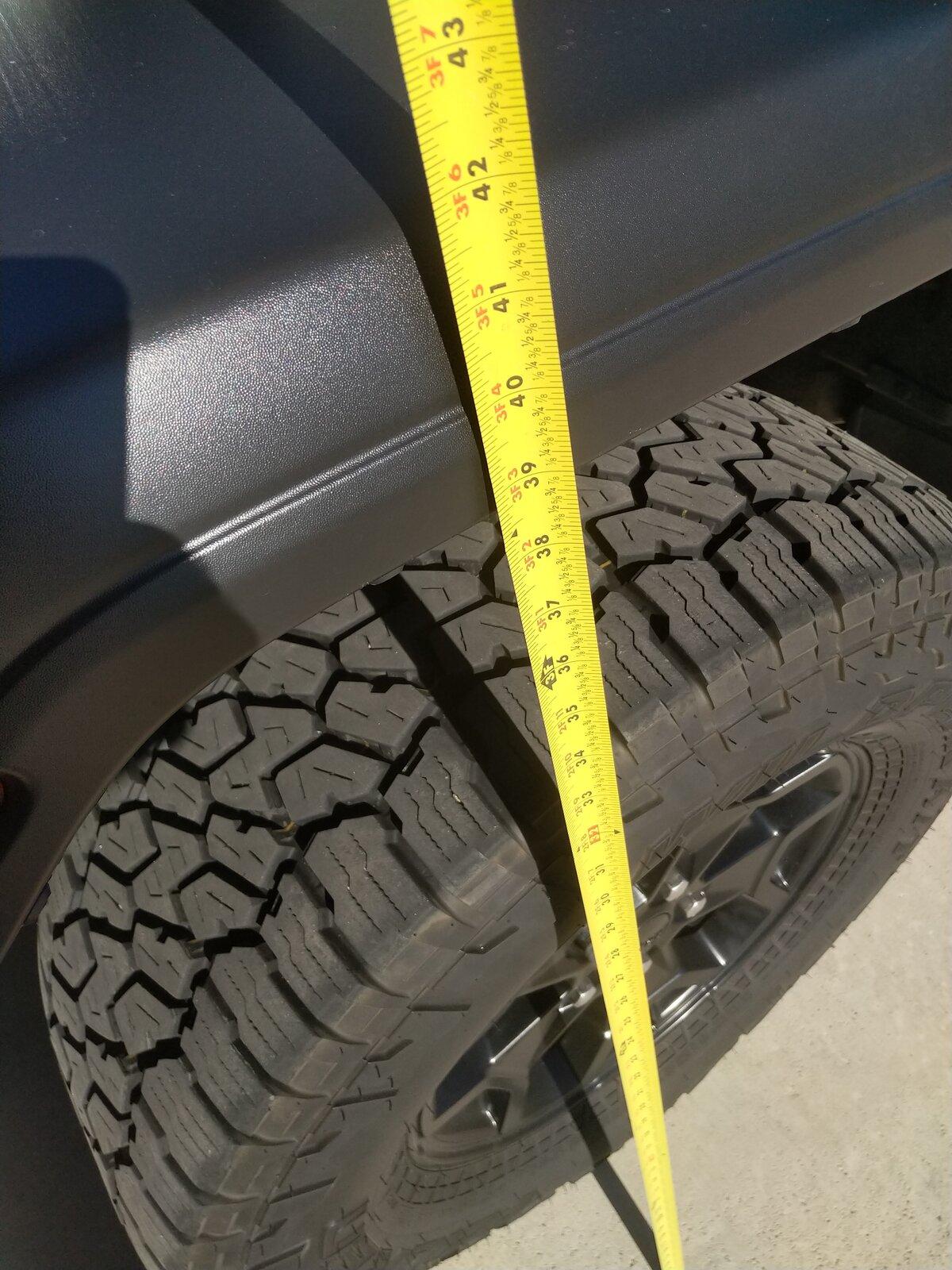

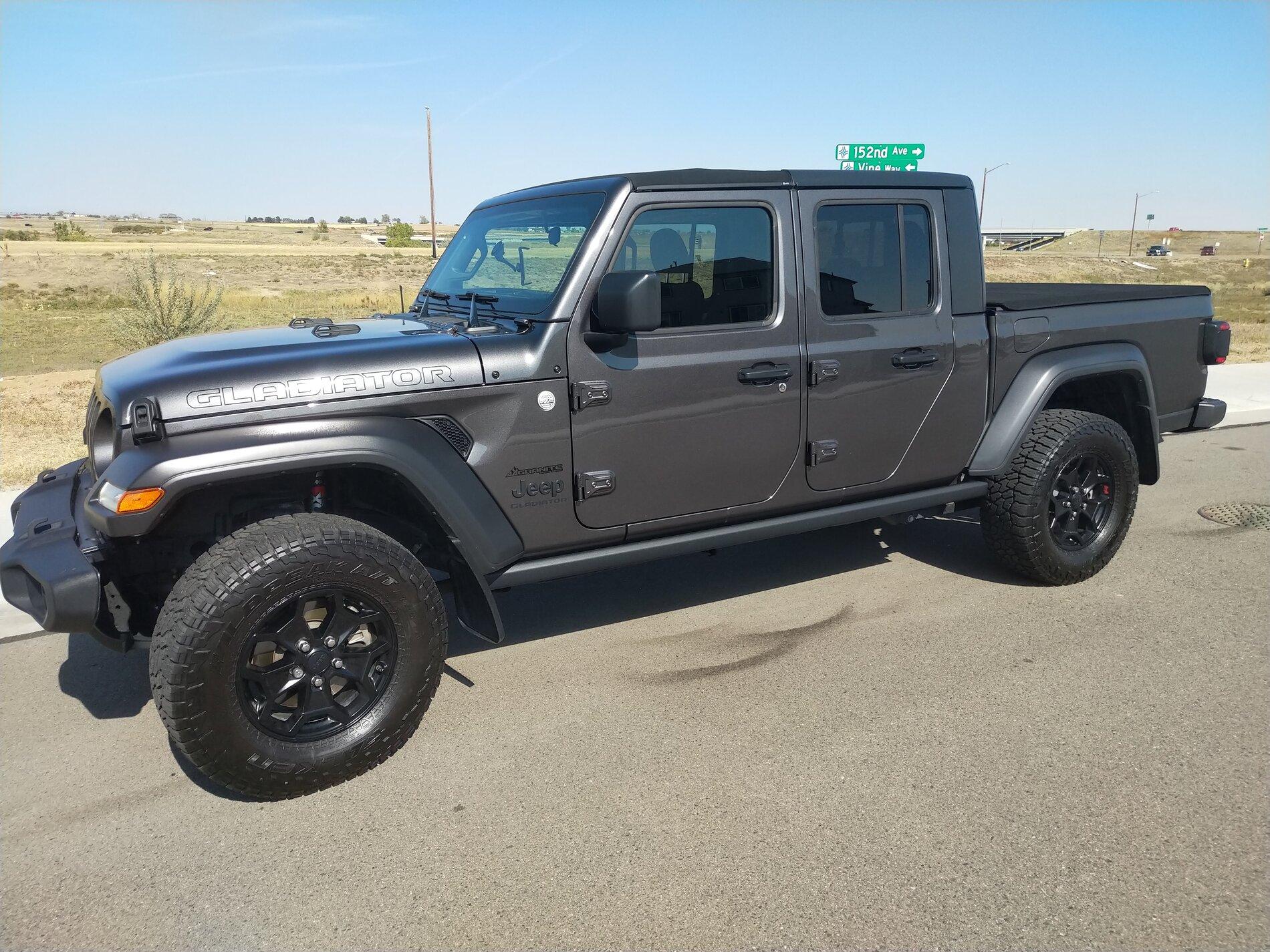

Running a 1" Teraflex spacer in front, nothing in back with Rubicon takeoff springs/shocks front and back. Fender measurements for the front.
Edit: looking to put a 3/4" Daystar kit in back and add the 1/2" second spacer on the front for future 35's. The axle can shift, but nothing a floor jack can't help with, jacking up to get the track bar back in line.

Looking good. I'm assuming the rubi springs gave you a little lift as well? Is that why you only needed the 1" puck to level it out? Or did you want to keep a little rake?
Mightytalldude
Rob aka MTD
Mar 25, 2019
759
1,571
Thornton, CO
GCM Sport S, 6spd manual, subtle mods.
Retail Management Hell
A little lift, maybe 1/2 to 1". I wanted to keep a little rake, so originally did the 1", but plan to do a 3/4 Daystar in back and then add the 1/2 second spacer in front to keep the rake. 35's will be in the future sometime.
