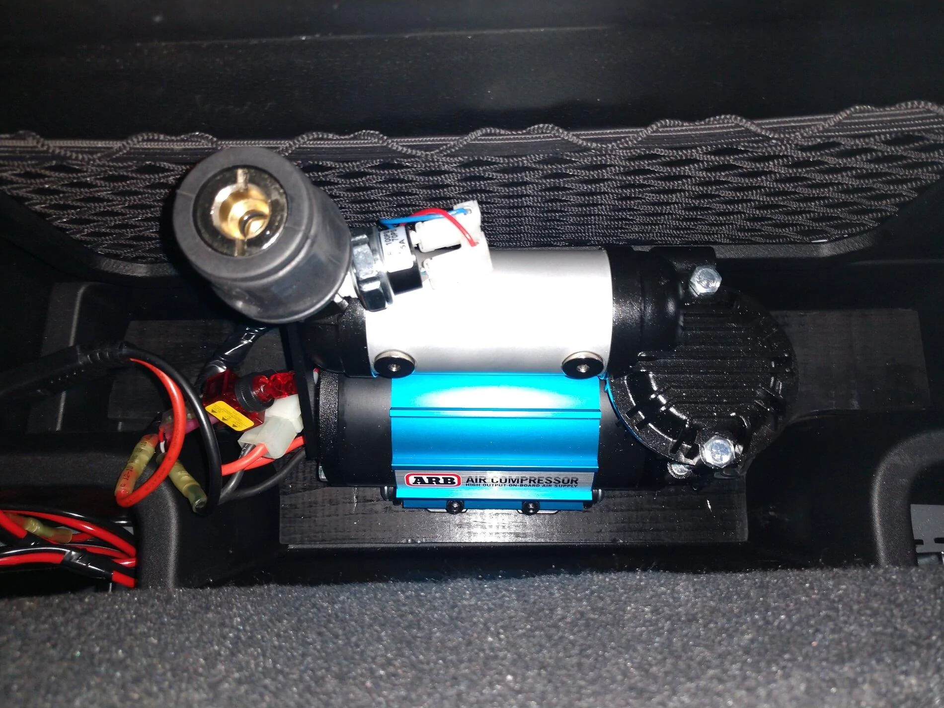

I have the single ARB behind the seat. I just cut a pine board the shape of the plastic mat and screwed the compressor to that. The whole assembly just drops into the opening. I've used it since last fall with no issues. The air chuck is mounted to the compressor so I need to fold the seat forward to use it. The compressor gets hot but there is plenty of air circulation so nothing around it gets hot.
The advantage is that I can unplug the wiring from the Jeep and remove the whole unit and attach another harness with alligator clips so I can run it off a battery on another vehicle if needed.

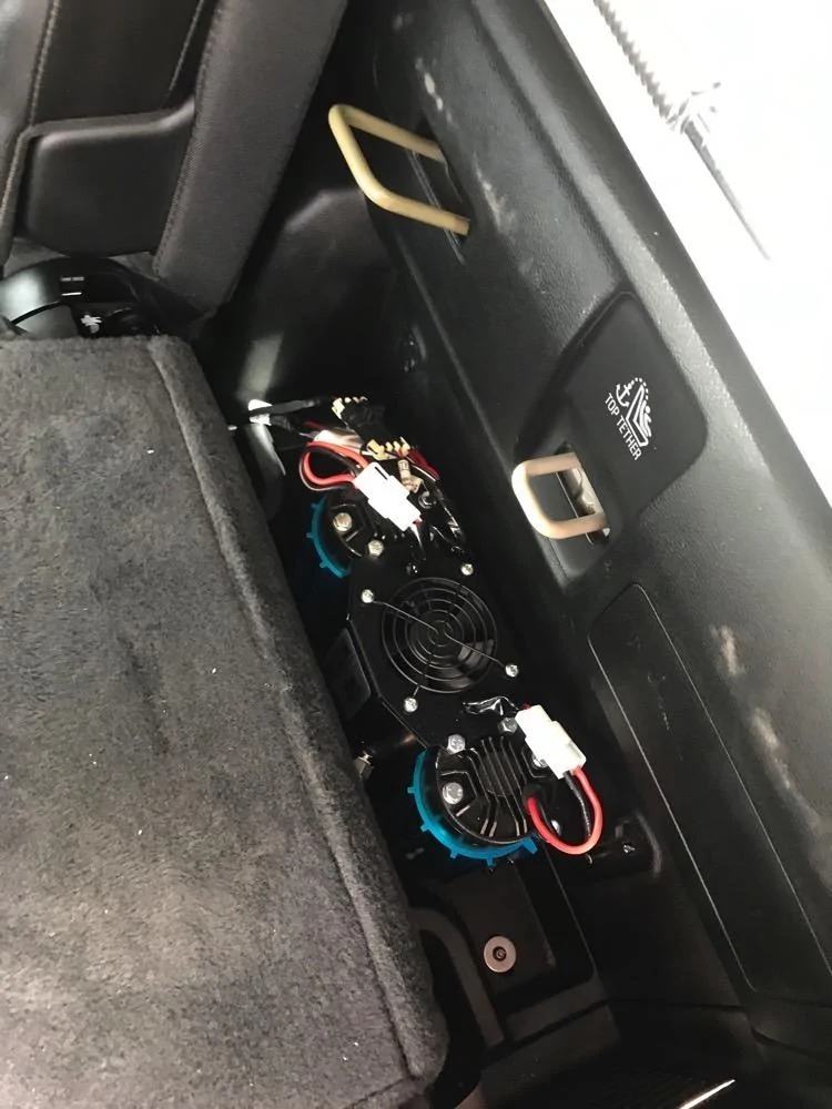

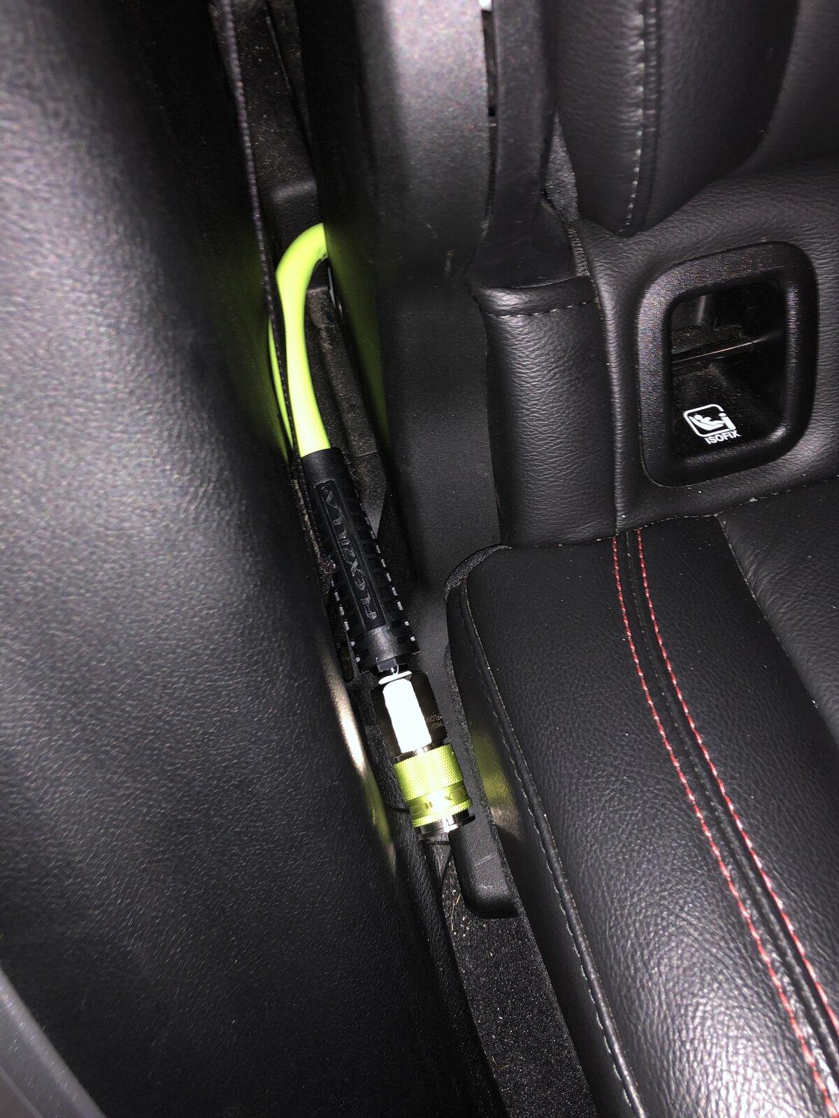

I also installed the 813 bracket behind the seat. Easy install. Ran the wiring under the carpet. Power through my Aux 4 switch. Ran air lines to each side of the rear seats. Works perfectly. I do leave the seat down when using the compressor. It only takes a few minutes to air up and I am on the road again. So no heat from the engine compartment. And no space taken up in the bed. Definitely recommend this set up.
Jeep Gladiator Anyone install 813 Fabrication compressor mount? 34798A06-2BD4-4608-A4FA-014A59B28296
So you didn't have to connect it to the battery also? I've been reading people having to connect to both the battery and and aux switch.

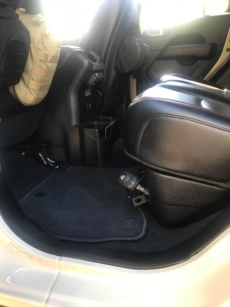

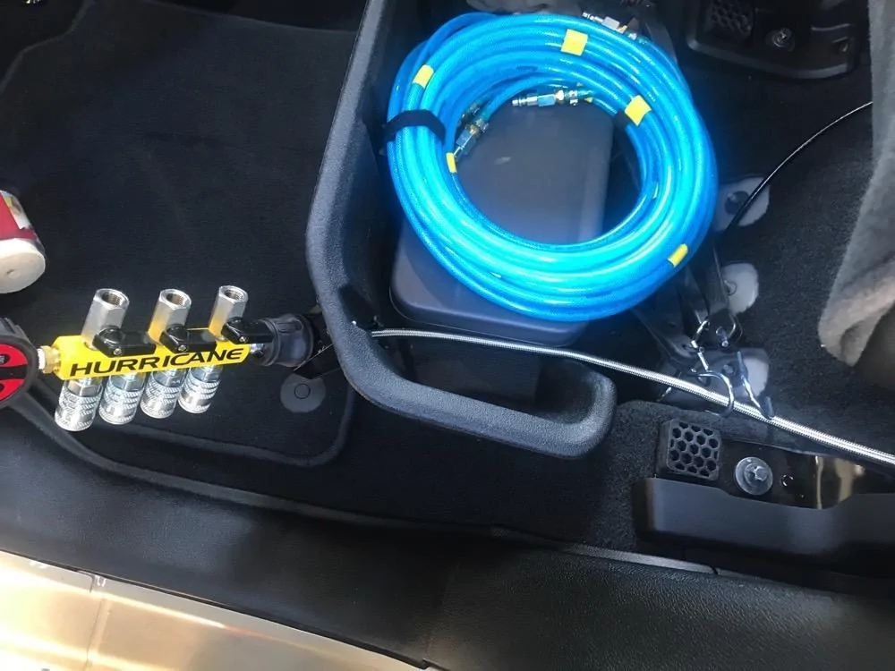

i have used the 813 Fab bracket for my ARB twin compressor. As others have said, it was a pretty easy/simple install and works great. Also, as others have said, I fold down my rear seat when airing up my 37's just to avoid any heat issues.
Jeep Gladiator Anyone install 813 Fabrication compressor mount? Compressor_1

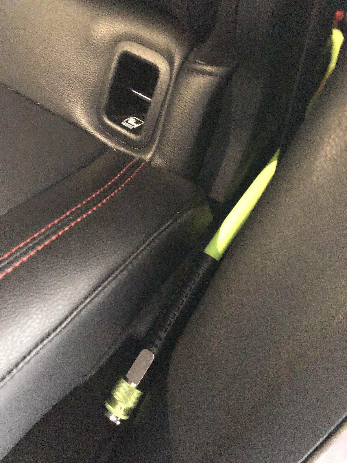

As far as the output line goes, I actually ran an ARB braided steel hose to an ARB coupling kit.
Hose:
https://www.amazon.com/gp/product/B073RS3FTL/ref=ppx_yo_dt_b_asin_title_o04_s00?ie=UTF8&psc=1
Coupling Kit:
https://www.amazon.com/gp/product/B073V82GB3/ref=ppx_yo_dt_b_asin_title_o05_s00?ie=UTF8&psc=1
I mounted the coupling kit bracket to the underseat storage divider and ran my hose through it. I don't really have passengers that ride in the back, so I wasn't worried that the coupling would get in the way. It actually hasn't posed any problem when entering and exiting that seat.
Jeep Gladiator Anyone install 813 Fabrication compressor mount? Compressor_2

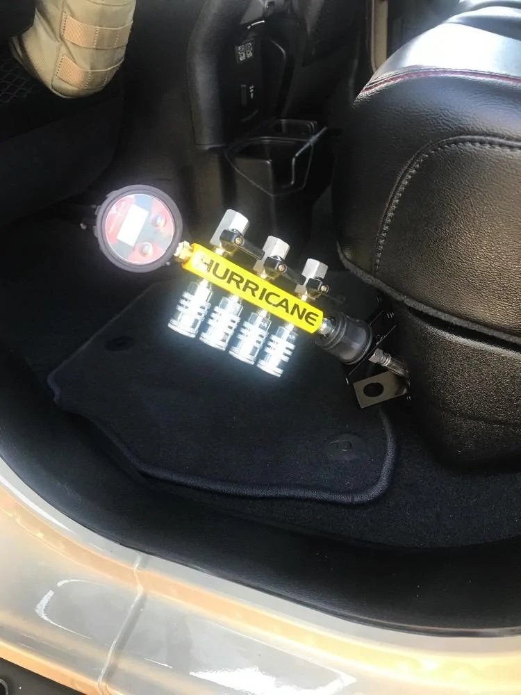

As far as my actual hose set up, I use the JeepNeeds Hurricane and hose system which allows me to air up/down all four tires at the same time and to the same pressure.
JeepNeeds Hurricane:
https://jeepsneeds.com/products/jeepsneeds-hurricane-free-shipping

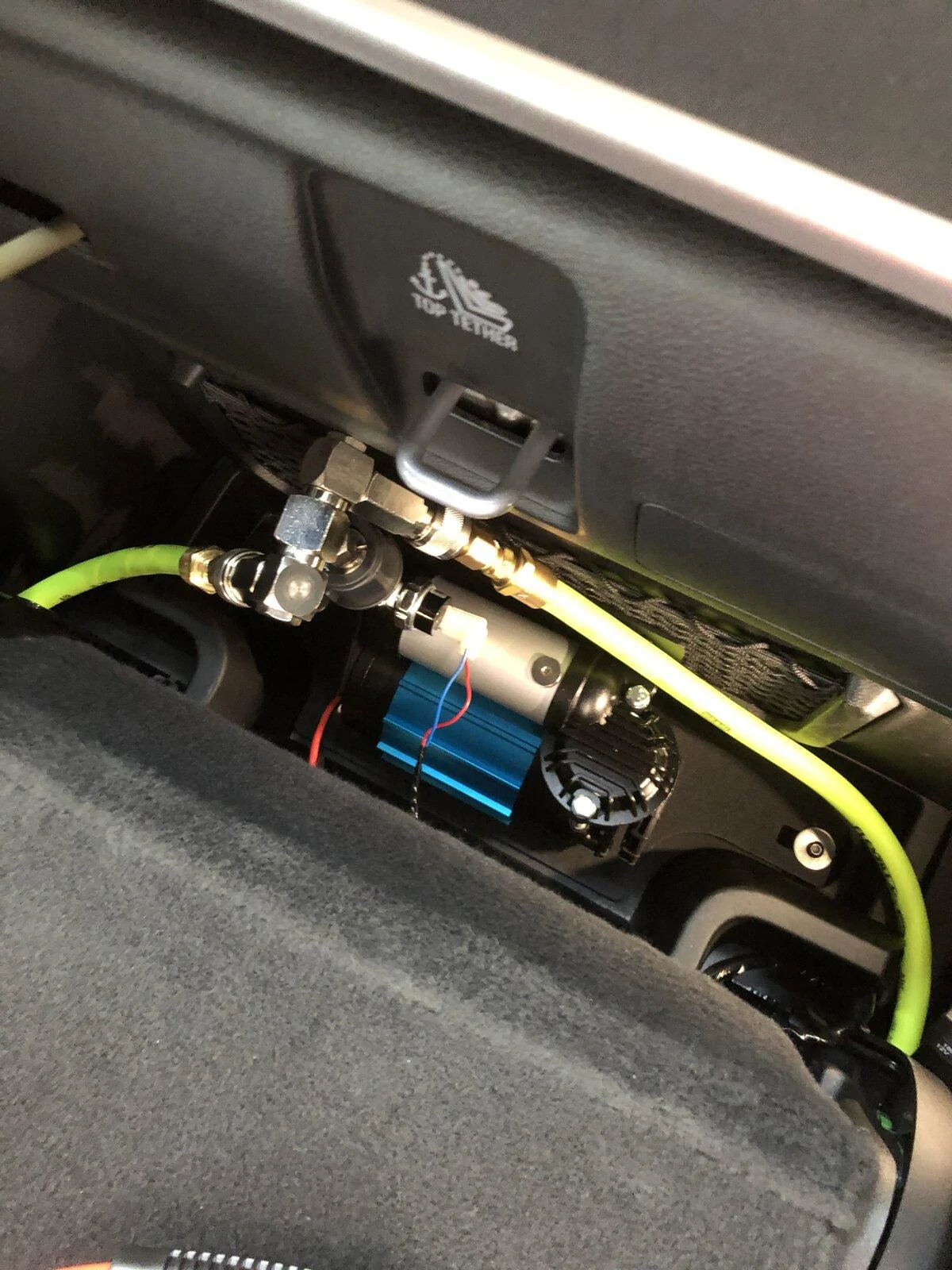

Jeep Gladiator Anyone install 813 Fabrication compressor mount? Compressor_3
Jeep Gladiator Anyone install 813 Fabrication compressor mount? Compressor_4

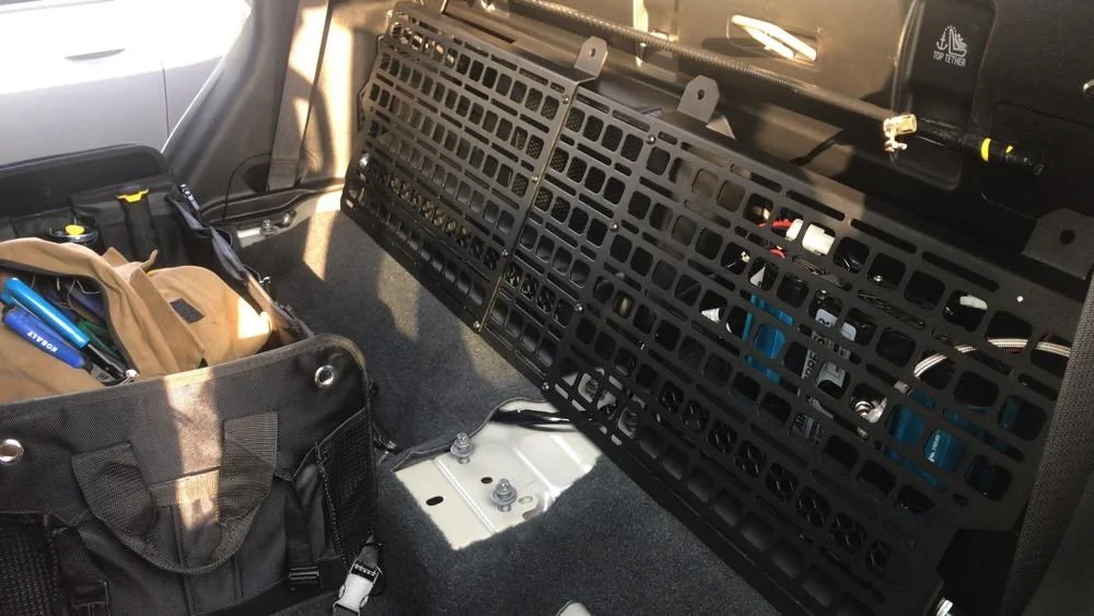

I was really happy with this set up but have now decided to do a rear seat delete. I'll be reconfiguring the hose/coupling mount once the delete is installed but it will be using most of the same hardware.
In the pic below (the delete has not been installed yet but the seats have been removed), you can see that the compressor is still mounted in the same location with the 813 Fab bracket. I have installed a Molle Panel across the back for storage in that unused back wall area but it will still allow heat to be dissipated. Once the rear seat delete gets installed, I will probably run the braided hose under the deck and penetrate it through the side in the door sill area.
Jeep Gladiator Anyone install 813 Fabrication compressor mount? Compressor_5.JPG
As far as the wiring goes, I stripped all of the unnecessary stuff out of the provided ARB harness (I have a Rubicon with lockers and don't need that portion of the ARB harness) and ran it under the carpet to the fascia that runs up the passenger side. I had to add wire to the ARB harness in order to actually reach the battery; I don't remember the exact length but 10 feet should do it. I then used the Aux 3 switch to start/stop the compressor. Here's a good YouTube video that shows how to route your wiring, remove panels, etc.
