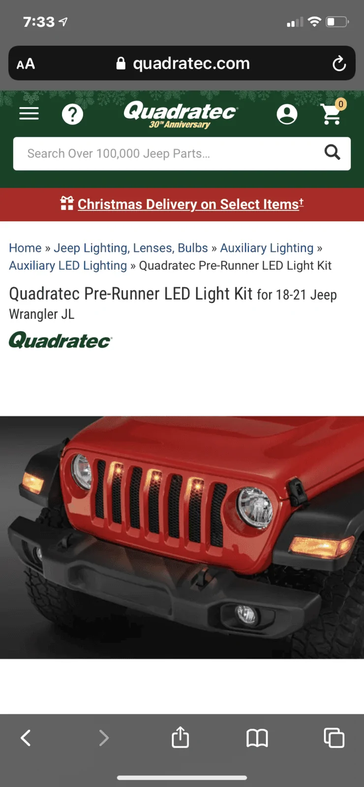

Has anyone installed the quadratec pre-runner lighting that also has the Foreword facing trail cam? Do you have any pics, is there any cutting required, and does the center light affect the camera at night?

There is no cutting required. The middle light would have to be mounted below the camera, so there may be some washout at night like the backup camera gets from the license plate lights. Another option would be to get two kits and mount the lights in the three slots on each side of the camera.

I've been looking, but have not yet bought it. I'm looking at adding a front camera, and would go with two kits if I do. I'm also looking at adding lights behind the grill attached to the support near the horns instead of the lights in the grill. The advantage of the Quadratec kit is the wiring harness and connector is already done and makes it simple to install.
Quadratec has a JT specific kit, which is $10 more than the JL kit. The holes in the JT grill are larger than in the JL.

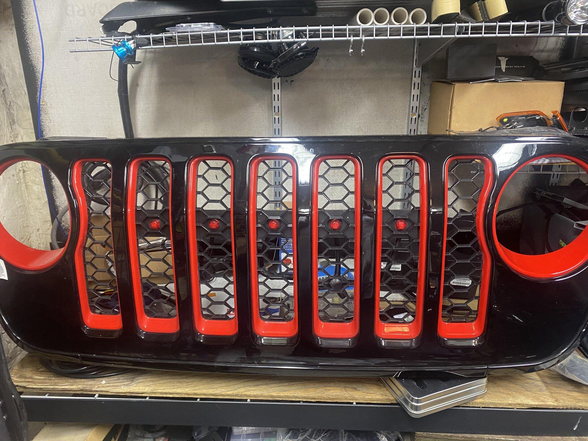

Yes. I used the pre runner harness. Replaced the lights with red ones. I got piece of aluminum flat stock from lowes. no cutting required. In fact this grill is for sale.

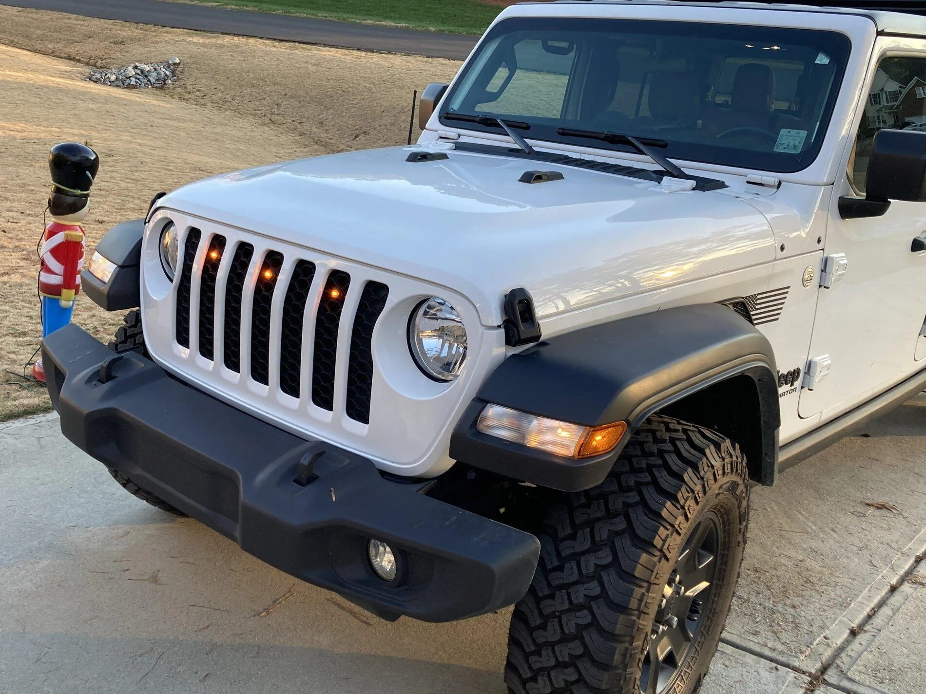

Installed them today. No cutting required. The JT kit adds adaptors to fit the larger grill holes to the JL kit.

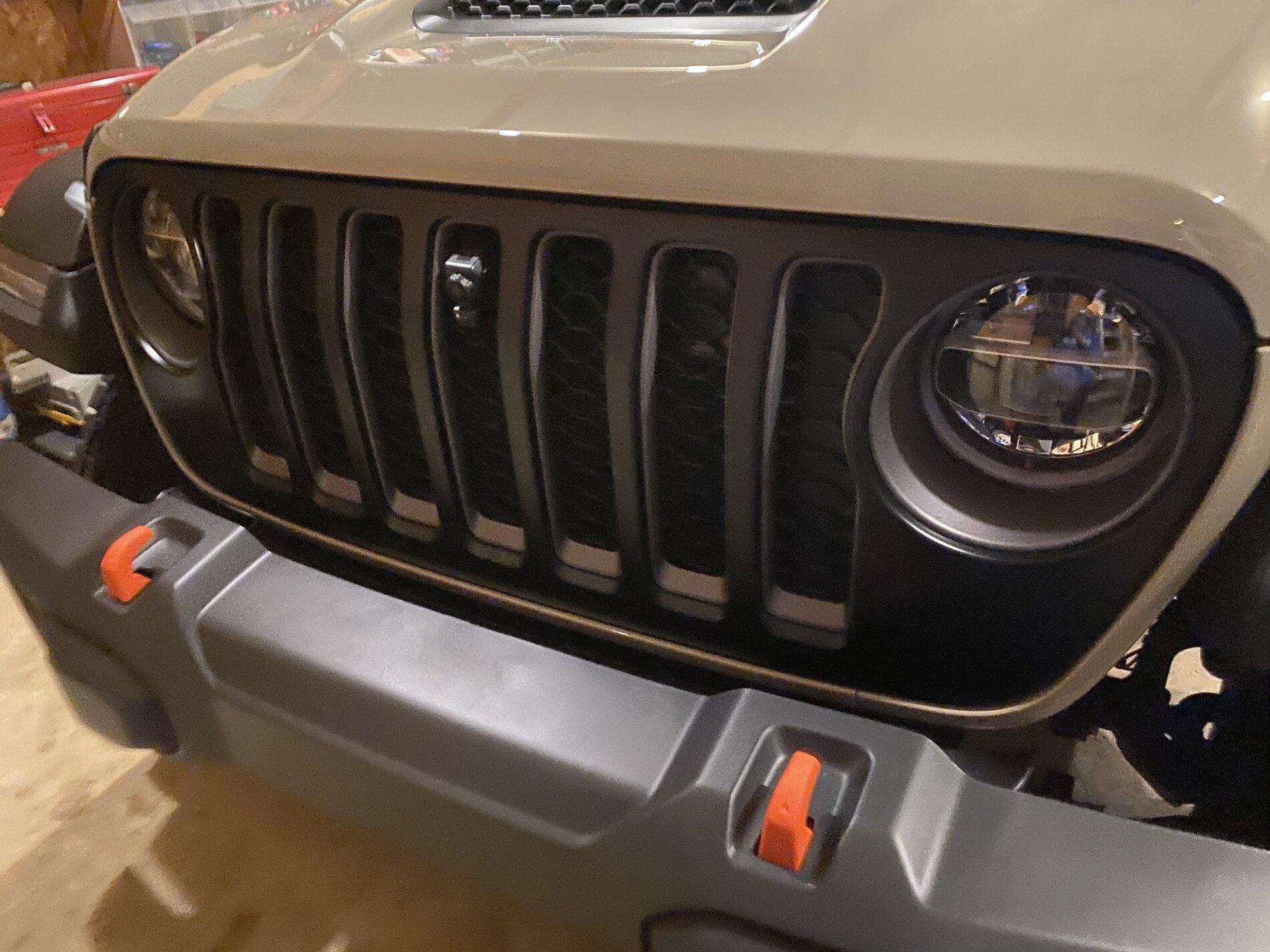

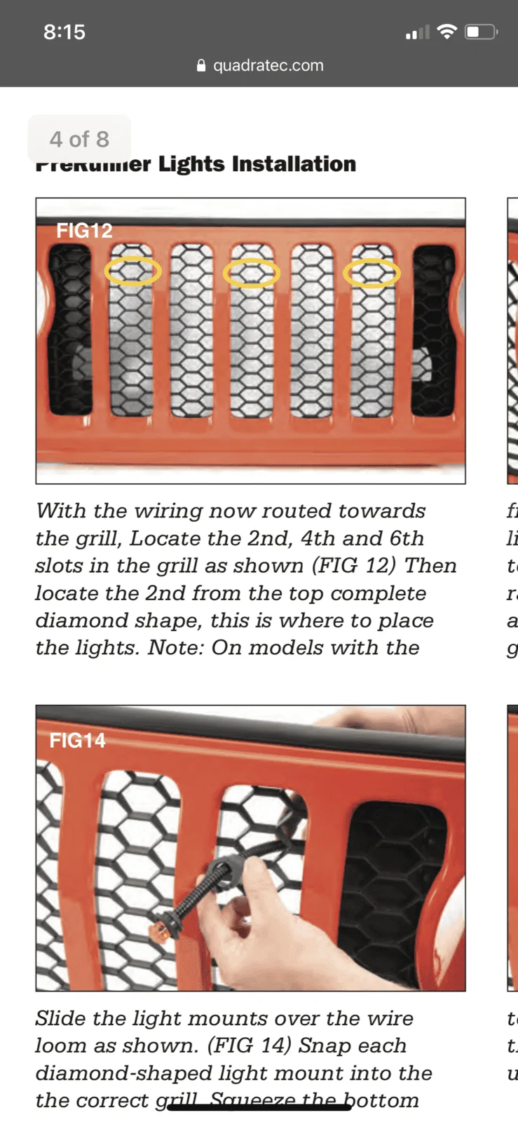

Looking at their directions, if you purchased two kits and did 6, it looks like you may have to cut out some of the black section on the outer two grills.
Wondering how they look lowered right under the camera.
