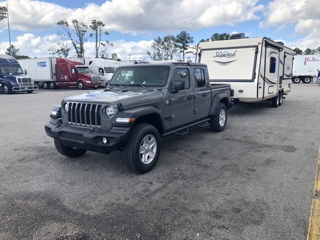

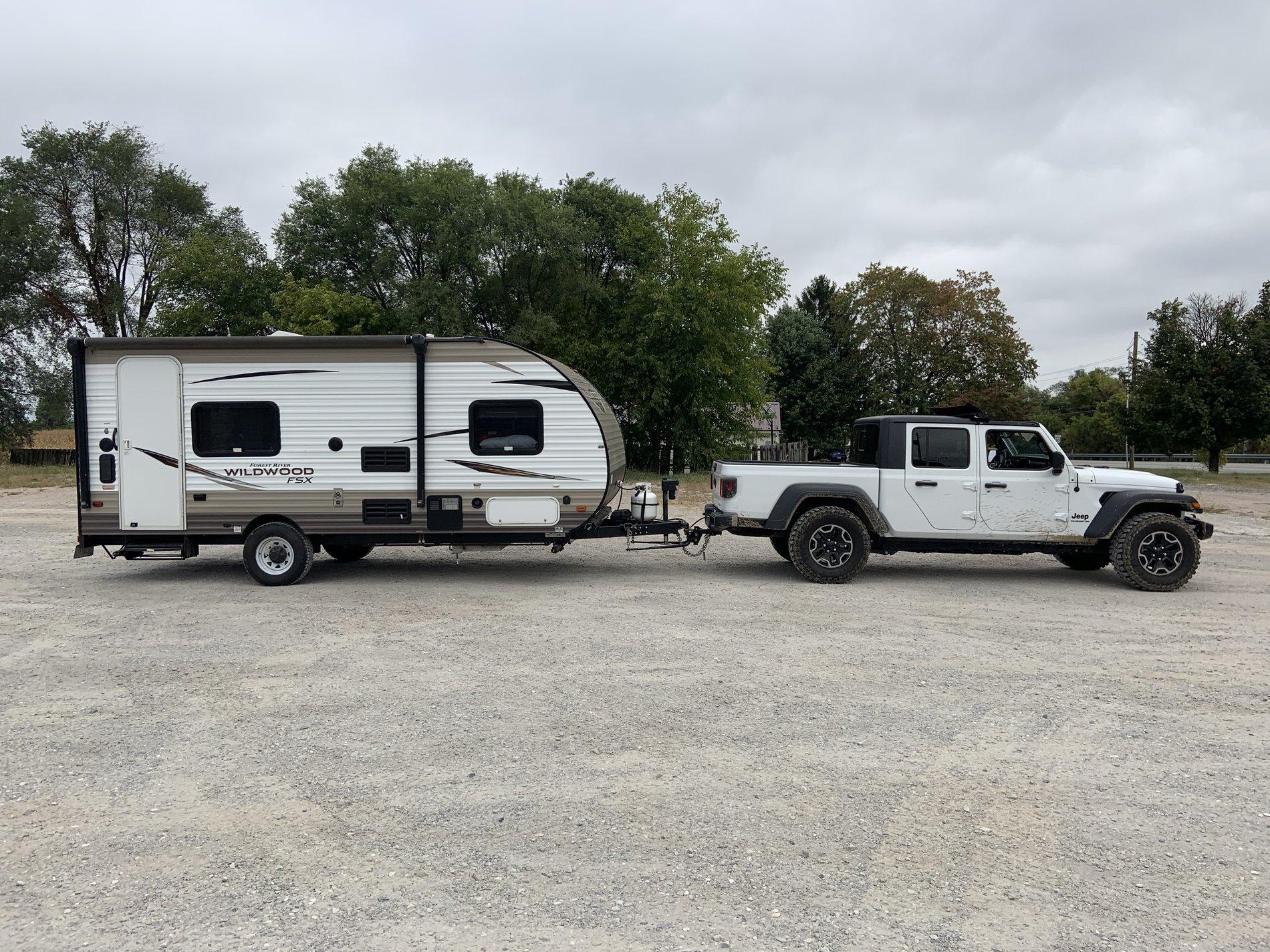

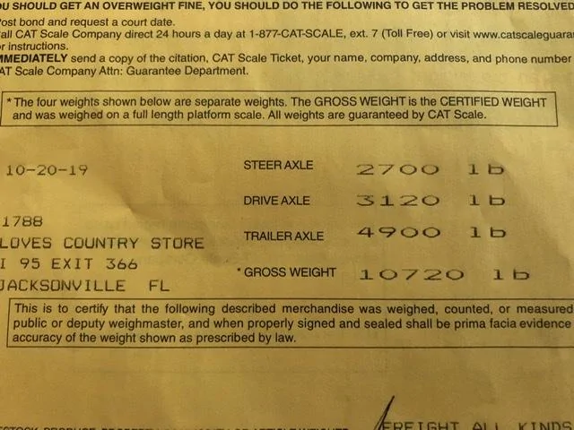

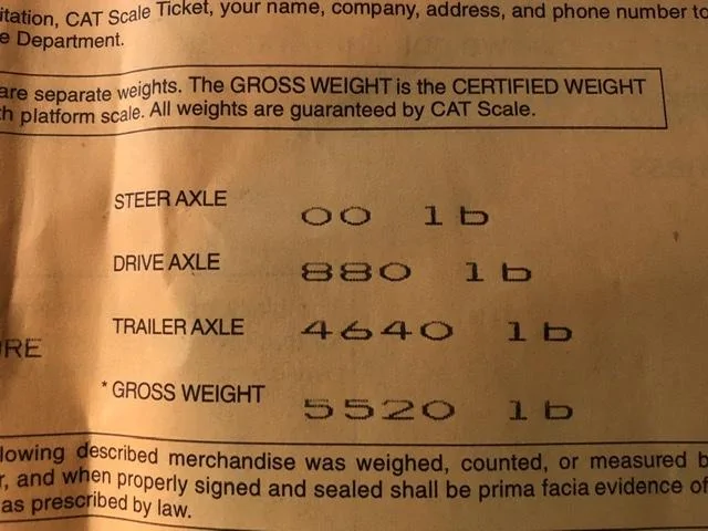

I would recommend bags only after you have the right weight distribution hitch setup and tailored to the setup. I recently acquired our JT max tow, coming from a Tundra. I realized my WDH wasn't adequate at 600lbs after many attempts to level my camper. Today I installed an Equalizer setup and got it perfect. I won't even need bags.
Attached are pictures of my scale results and the two hooked up.
