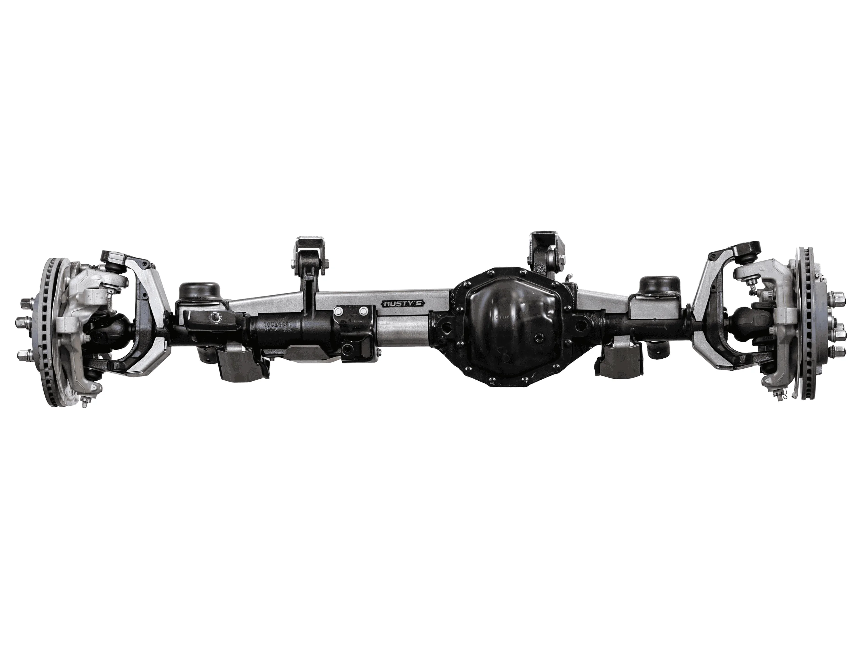

Anyone installed a Rusty's Truss Kit?

I feel it's a little on the pricey side, but that's an awesome looking kit. I'll be following along to see if anyone has installed one as well.
6,372
14,541
I've been looking at the Rusty's truss kit too. As it checks all the boxes. 👍

I like the rusty's design better, but it looks like Barnes offers 3/16 parts for much cheaper
CrazyCooter
Tony
Nov 1, 2020
1,904
1,979
Far NorCal
Specialty Off Road Shop Owner
I like really Artec as it looks like they designed theirs with more angles and reached down closer to the center of the axle tubes. It also looks to fit the areas around the control arm mounts better. May require additional bumps stop spacing if a person isn't already running more spacer than required as standard on most lifts.
The Barnes truss just looks cheesy with a lot of gaps around the control arm mounts and is pretty tall also. It is the cheapest though......
The Rusty's truss is the lowest profile of the 3, but lacks the multiple angles for strength over the Artec. If you look at the pics, it looks like they also supply a sleeve to fit around the passenger tube? Interesting.
I'm thinking Rusty's might be my choice out of these because we're really just trying to add strength to the right tube and my truck is a diesel, so thinking I need all the clearance I can get? I don't think the 1/8 vs 3/16" really come into play here as the rest of the housing is plenty weak? The M210 front axle isn't anything that will take the serious abuse in comparison to a 1 ton axle in a vehicle that would be getting trashed.
