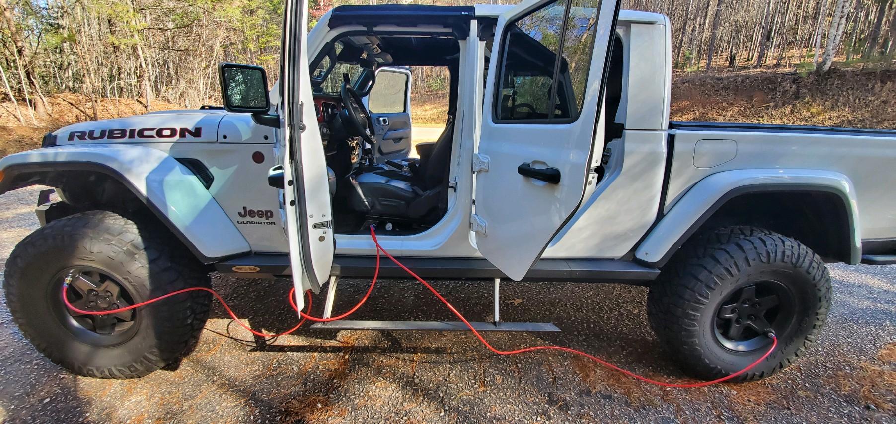

I had to run primary power to the battery for the compressors, but for the "trigger" wire, I just ran it to the switch wire in the cab. Basically following their instructions to a T for running the wire through the floor drain hole.
Takes about 10min to air up or down with my 37s.
