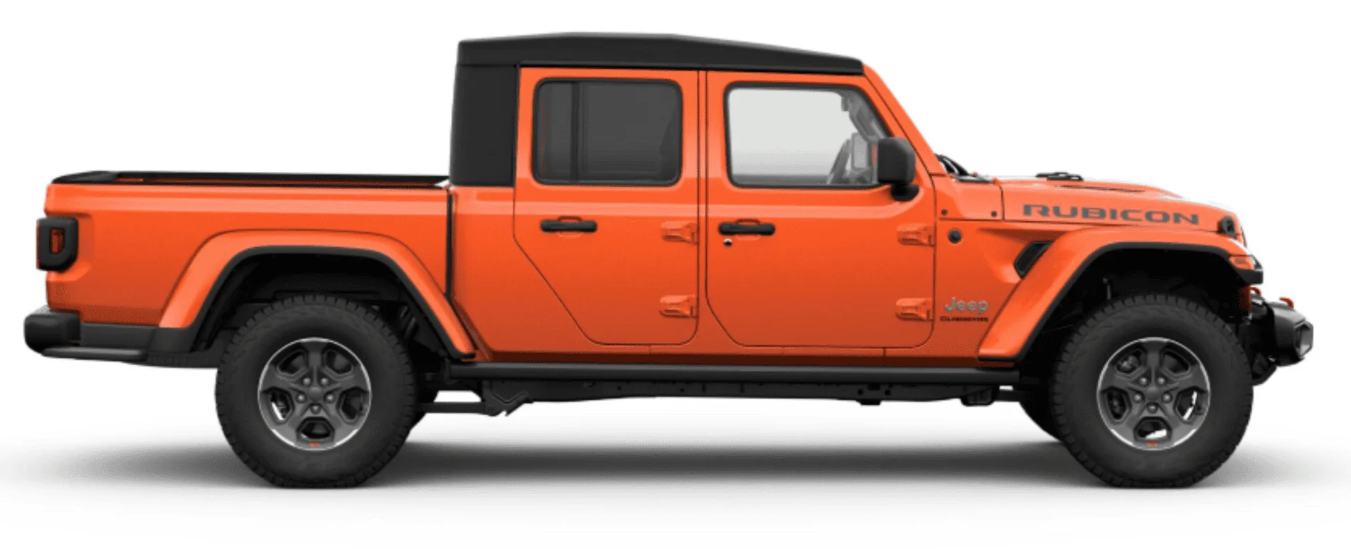

Are Rubicon rears also higher than Sport?
Also interested in this. Haven't been able to find much on the Gladiators. I know on the Wranglers they are.

Yes, the rears have more clearance on the rubi flare. The top of the flare might not sit any higher relative to the beds top, but the flare itself isn't as tall/thick. You can see this difference on the jeep build site
So, it might look odd to have different clearances front to back, i.e. need to replace front and rears together.
I doubt you'd notice much to be honest. Even on the Rubicon the front flare openings look quite a bit larger than the rears due to the massive amount of flex the front axle has with the sway bar disconnected
