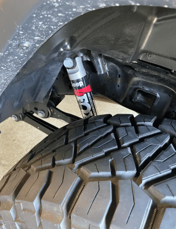

Binfordtools
Feb 9, 2021
125
200
Michigan
2021 Hydro Blue Willys
Automotive Manager
Just this week I added some take-off Fox shocks from a Rubicon to my Willys with a 2" spacer lift and 35" tires. The front ride isn't that much different but there is a noticable difference in the rear. A bit less "bounce" and skipping on curves where there is cracks/uneven pavement on the road. I bought a used set with 2000ish miles on them. Low risk from a cost standpoint and there is some ride-quality improvements, so I am happy.
