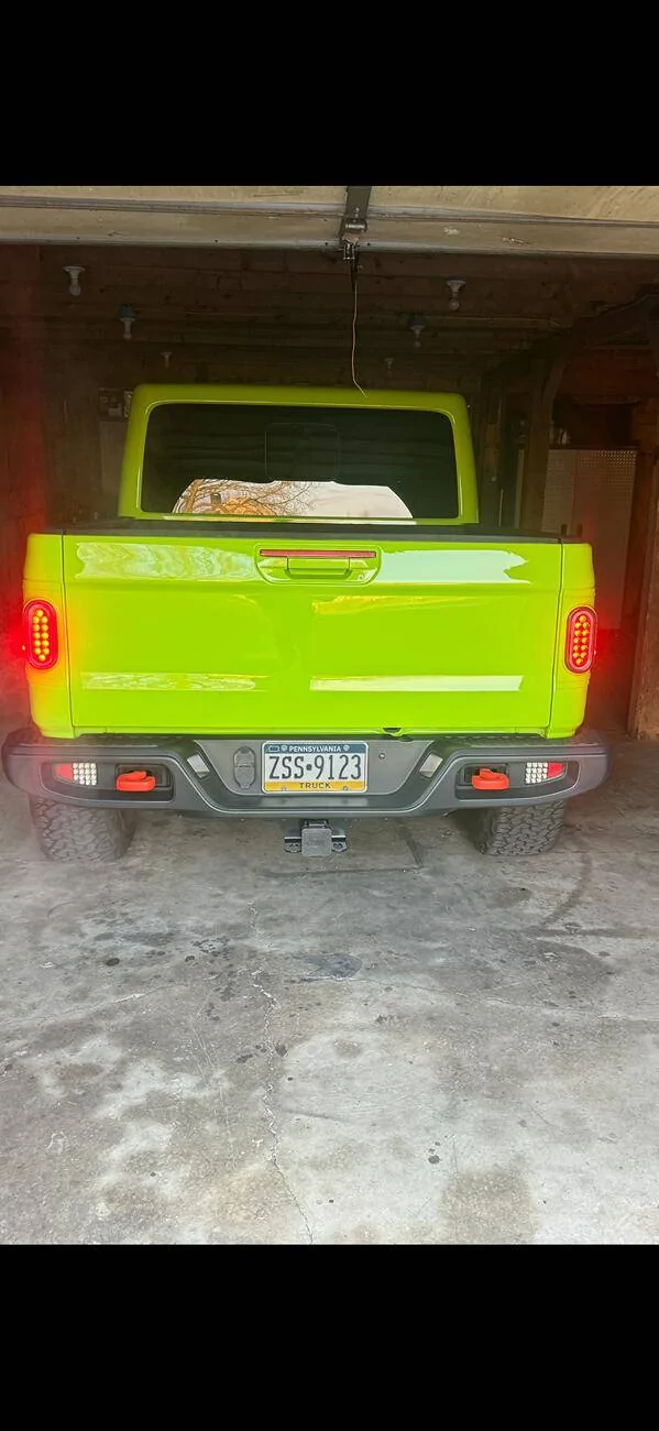

Jeep Gladiator Anyone remove gladiator tailgate badge D243B5C1-5CAC-47DB-8AED-E2CDF3D45D4F

Yes, we do it all the time when we install the tailgate wrap. Just need a fishing line, goo gone, a microfiber towel and a lot of PATIENCE.
I like to start with some goo gone ( let it sit for 30 sec-1 min), wipe the areas around the letters, then get the fishing line and go around the letters.
When you have an opening between the letters, spray goo gone again, and let it for a few sec. You can do the fishing line while it's getting sit.
When the letters are off, you probably gonna have glue on the tailgate, wipe it with goo gone/ microfiber towel (circle moves) and then wipe it with alcohol to remove and clear any goo gone residues.
