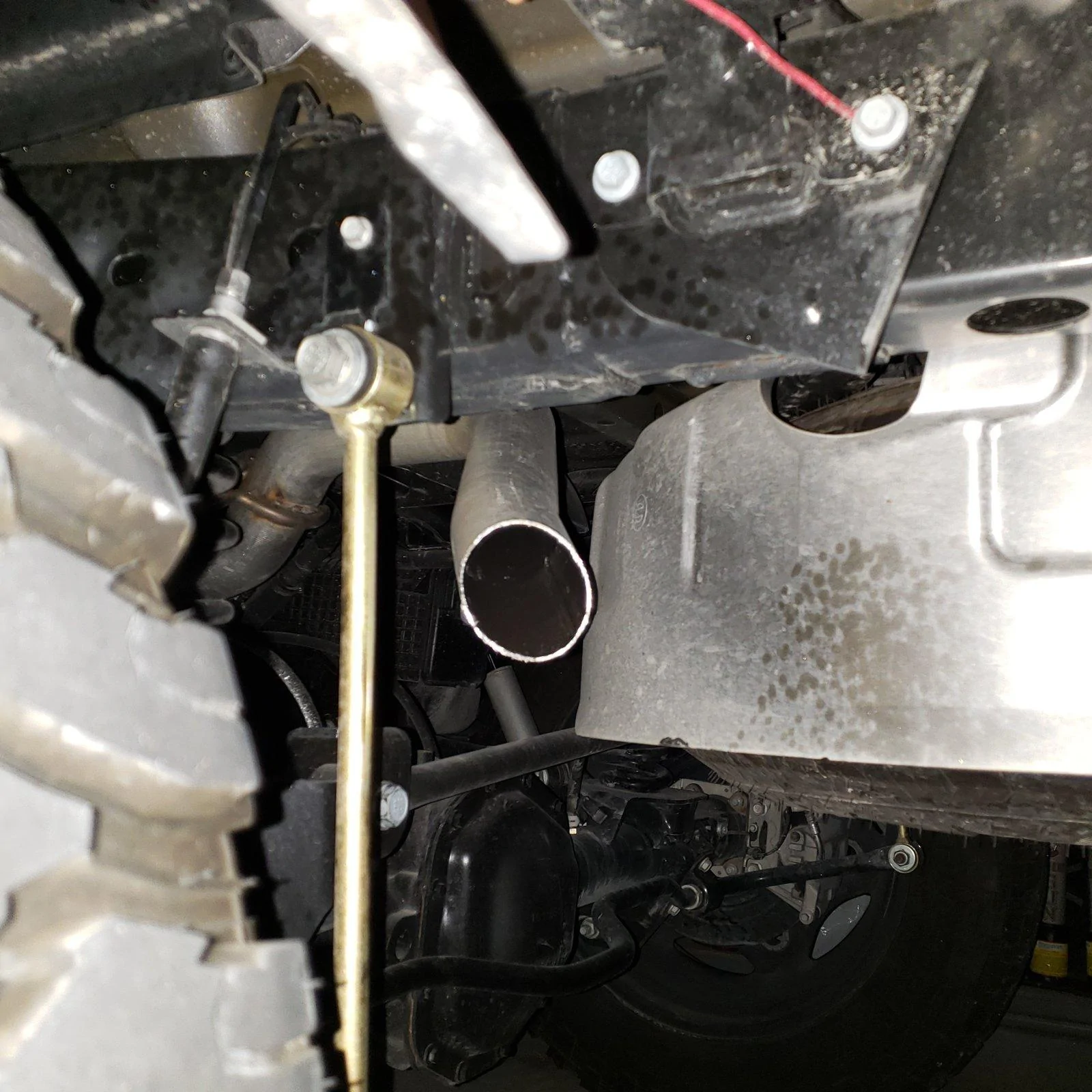

Just wondering if anyone has removed the resonator yet? There are a bunch of threads on the JL forum about it but nothing on this forum about just removing the resonator and leaving the stock muffler. I am considering cutting the exhaust just before it reaches the spare tire area and installing a turn-down tip. The Gladiator is setup to do this unlike the Wrangler where there was no easy option other than removing the muffler and retaining the resonator. If anyone has done this let me know what it sounds like...otherwise I'll prolly be the Guinea pig in the next week or two.

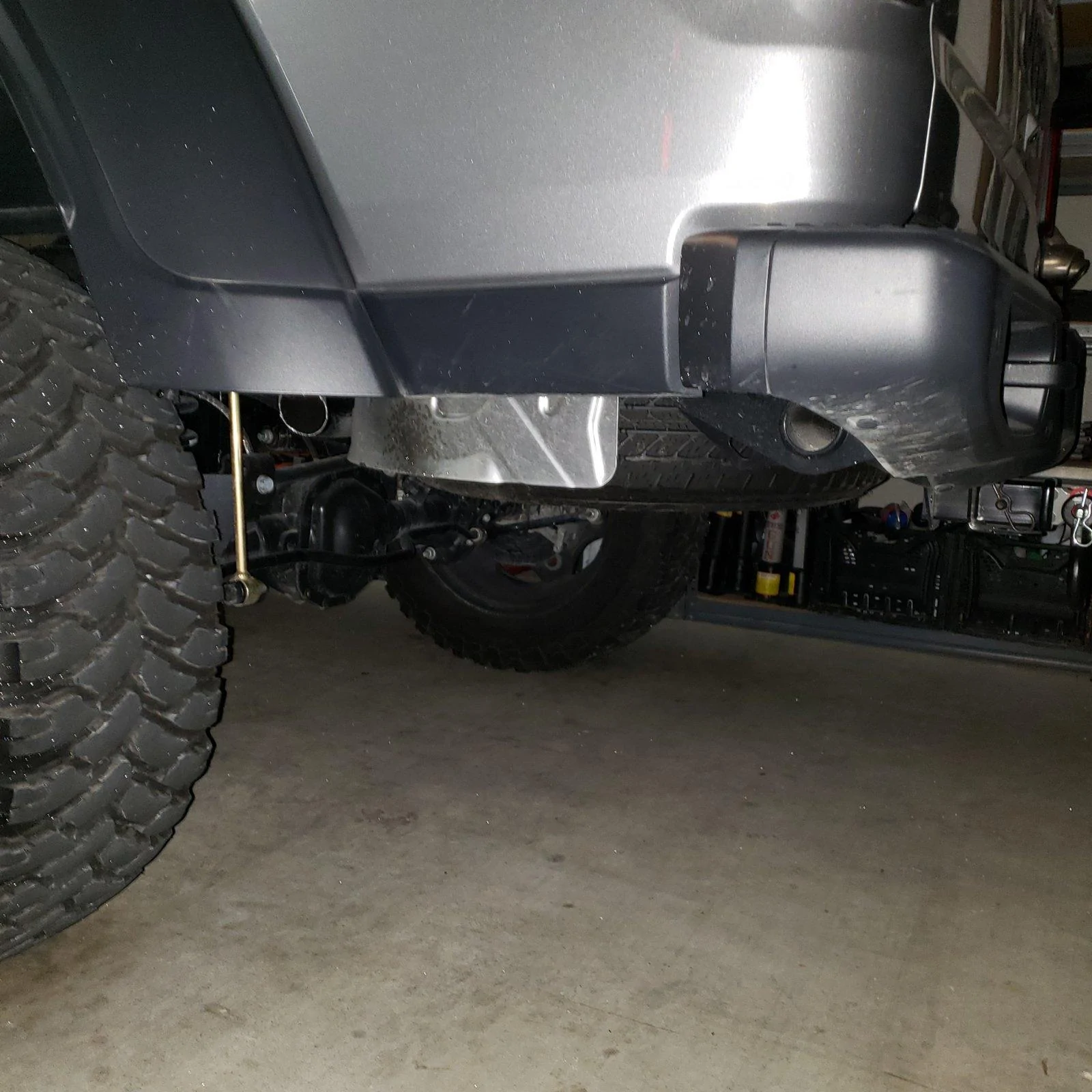

Update: Deleted the resonator today and it really didn't do much sound wise. I'll get some better pics tomorrow and hopefully a video too.

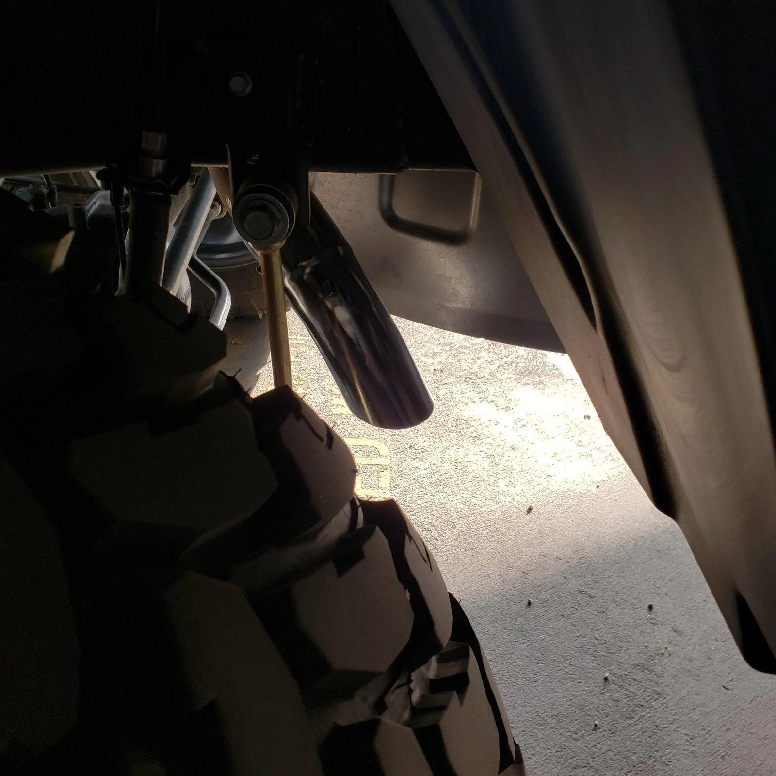

I mostly just wanted to physically get rid of the resonator because I didn't like the way it looked and hoped that it would give a little additional sound. I cant tell that it did anything to increase sound...which is fine, I'm just not sure why it's even there. I did finally get time to install a turn-down tip on it!

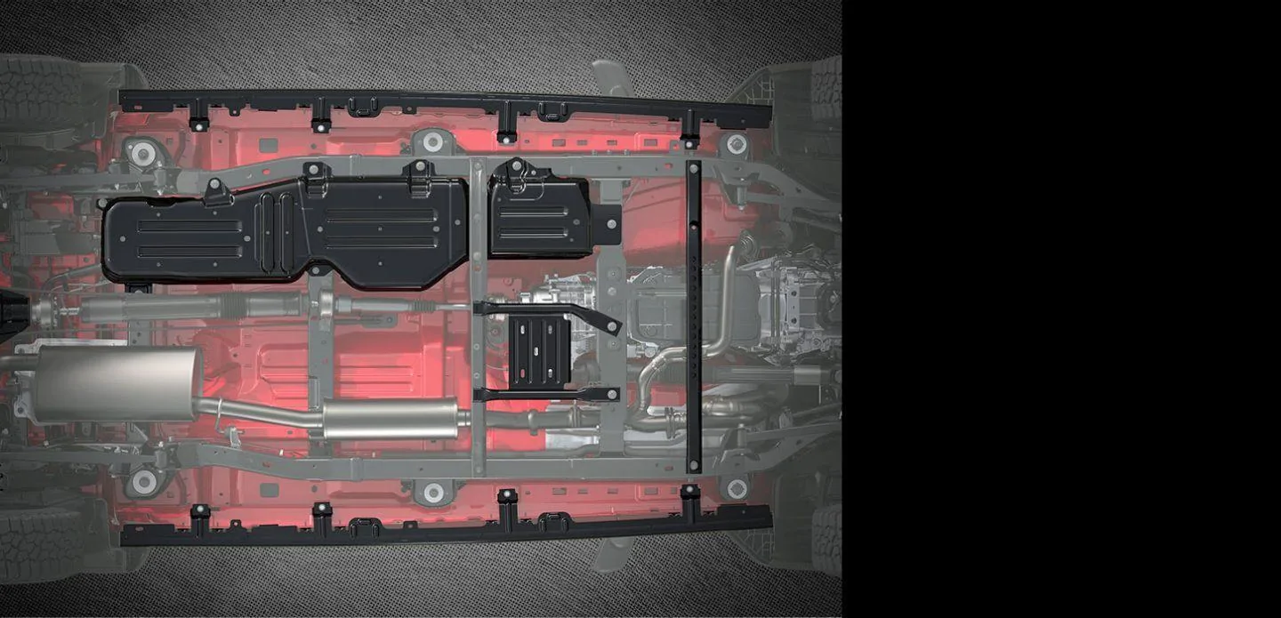

Interesting video - thanks for posting it MoparDave. He cut the pipe and removed the muffler and the other "can" and then reattached the rear resonator which shortened his exhaust system considerably.
Here's an underside pic from JEEP showing the stock exhaust system:
