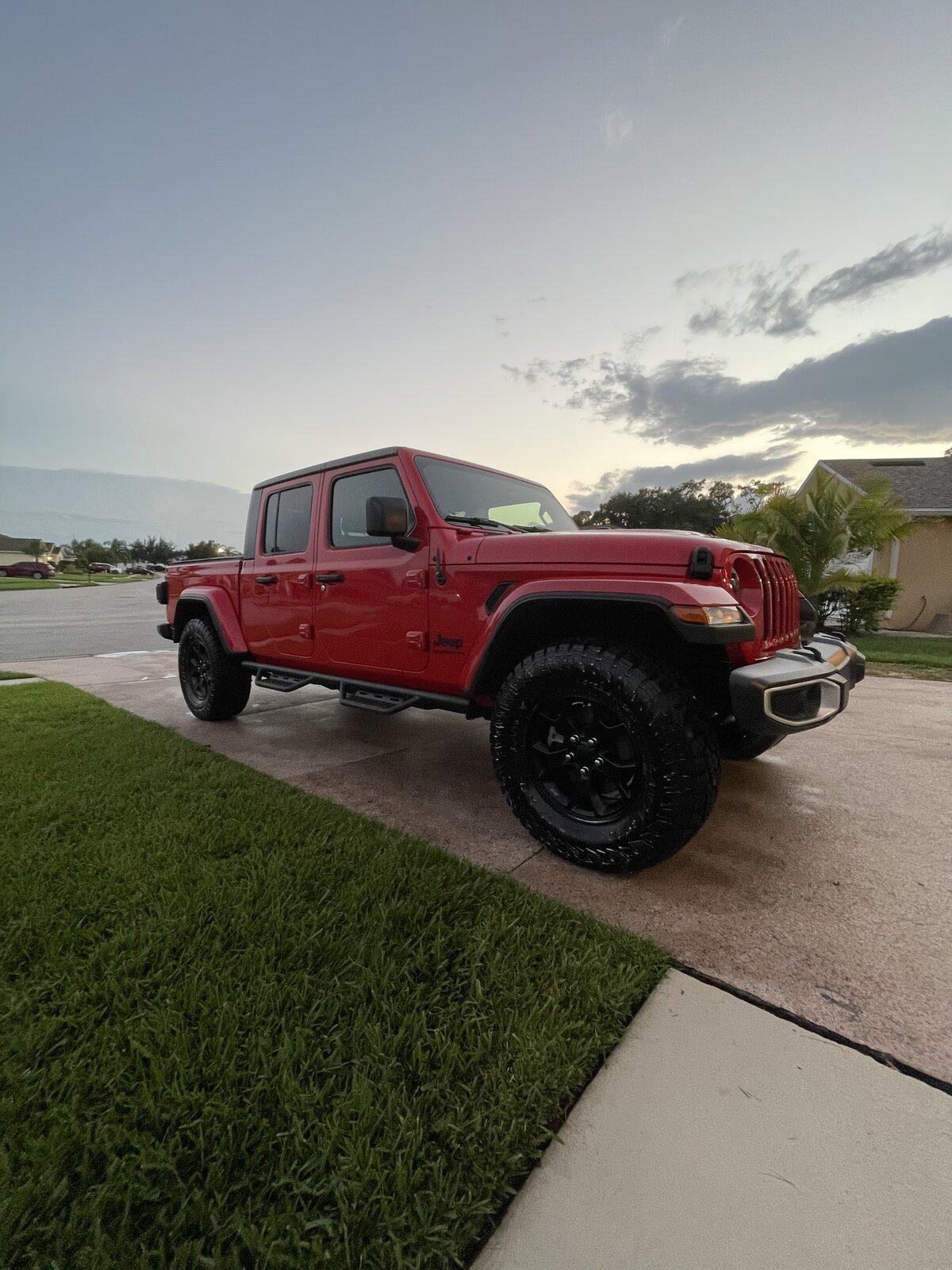

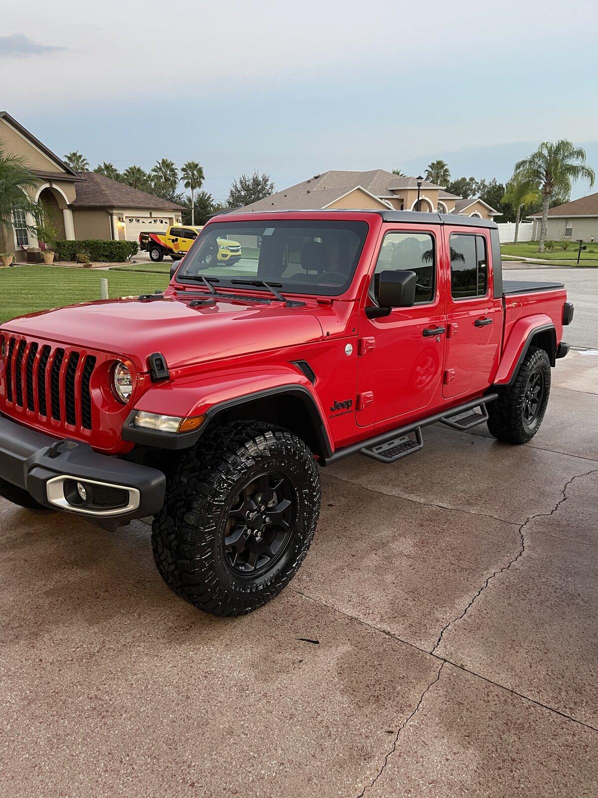

Yup 35x11.5 Nitto Trail grapplers on my JTR, looks phenomenal, it’s a game changer imho, I like the oem + look on my rigs so keeping the stock wheels was important to me....zero rub anywhere at any point.
check this for reference:
https://www.drivingline.com/articles/trail-tested-jeep-gladiator-rubicon-35s-no-lift/
I am considering doing this right out of the box on the stock rims. I know they’re about 10lbs heavier each than the stock tires, any loss in power or mpg? Any pics of your setup?
