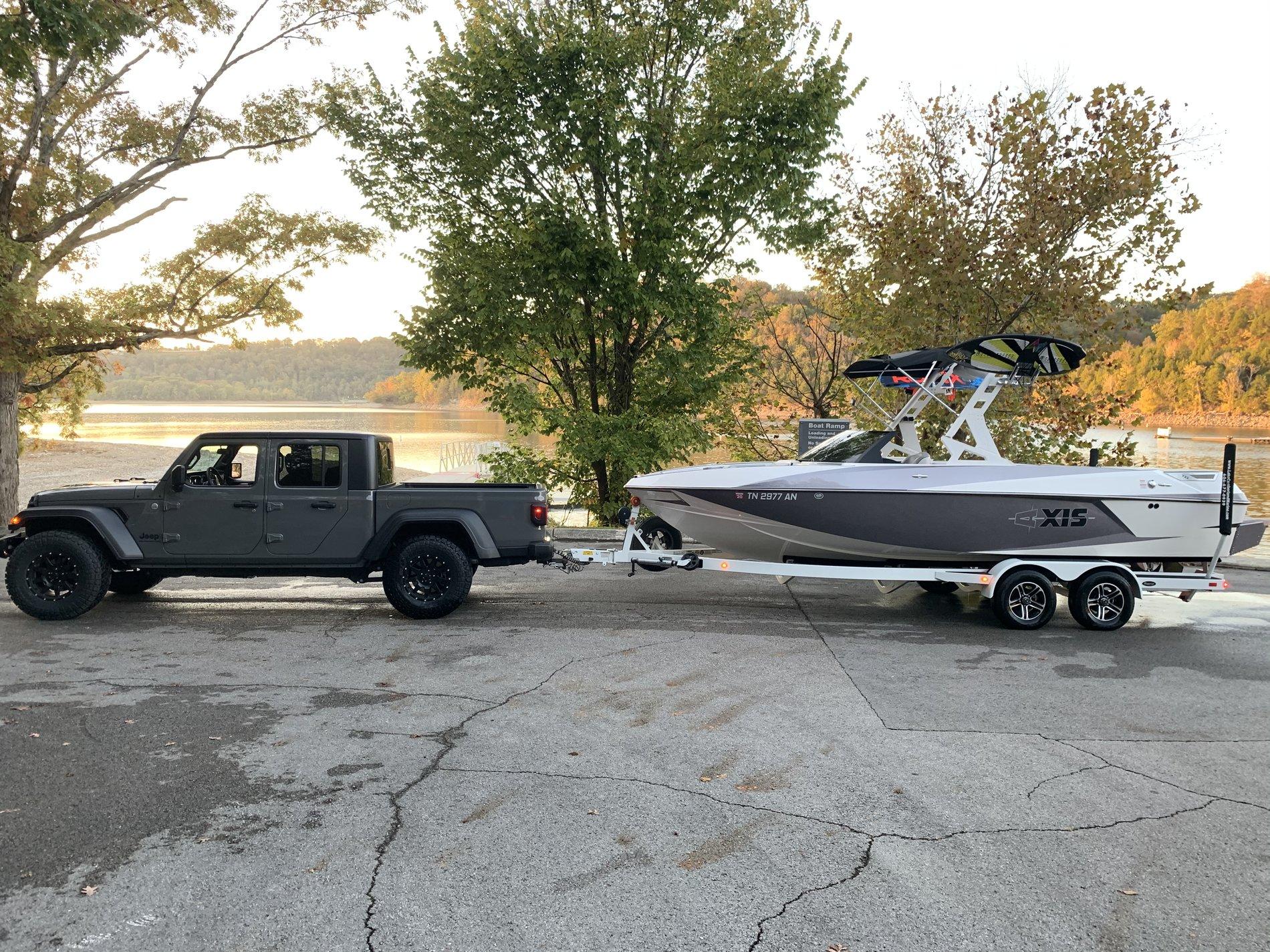

sorry I don’t agree I have lost 20% towing ability by adding 35’s... May have lost a little but not 20%. I actually can’t tell a much of a difference in towing... especially if you have a properly equipped trailer. I would be willing to bet I have towed as much “weight” with my Gladiator as anyone on the forum.

I agree it does play a big factor... I just do not feel personally I have lost 20% towing capacity. I am sure I have lost some... but not 20%.
just my opinion based on towing my boat completely stock and towing after adding 35’s.

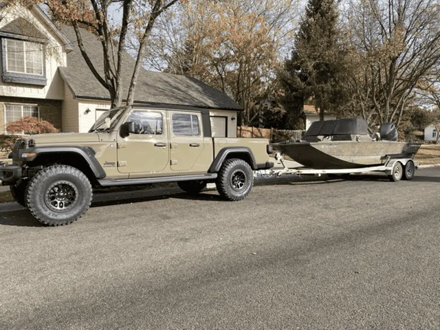

Yes it effects it more then 20%. Time or energy getting into figuring it out? no. But i bet its closer to 40%. My boat trailer is close to 4k lbs. i would wager that i would be about the same stopping and accelerating distance with a stock JT with 7500 lbs.. meaning its nearly cut in half.. #changemymind but the boat trailer has its own brakes so that could help with stopping...
