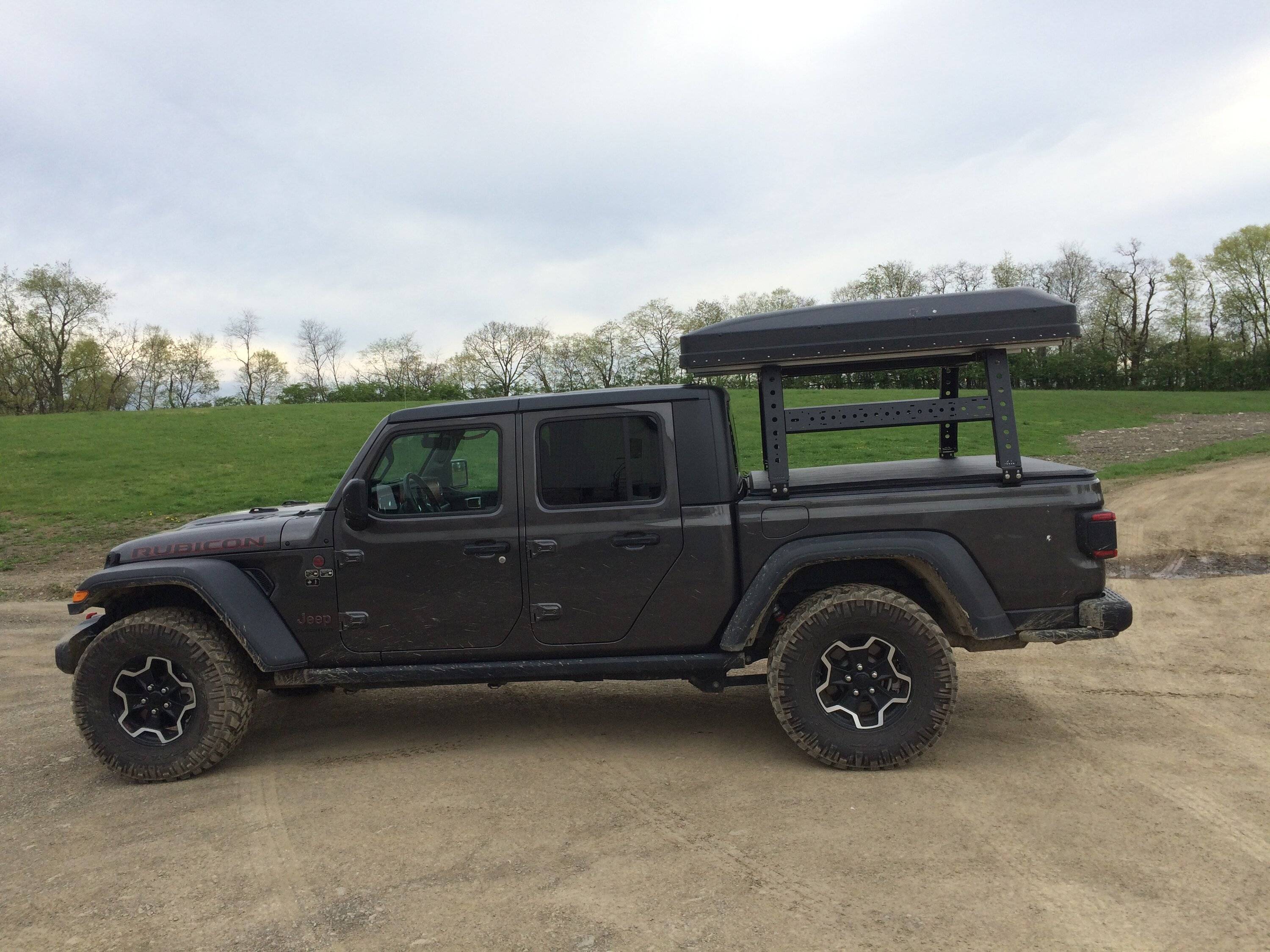

Jeep Gladiator Anyone running a ROAM Vagabond RTT on a Max Modular bed frame? TentRack2.JPG
You can see in this photo that the parrallel supports only contact the cross bars. (46")

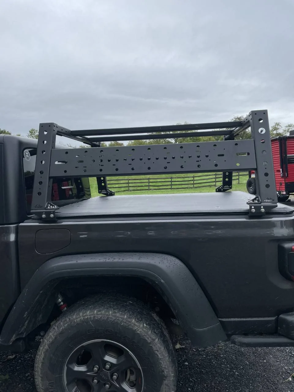

Jeep Gladiator Anyone running a ROAM Vagabond RTT on a Max Modular bed frame? Rack58
Same rack but with 58" long bars.
