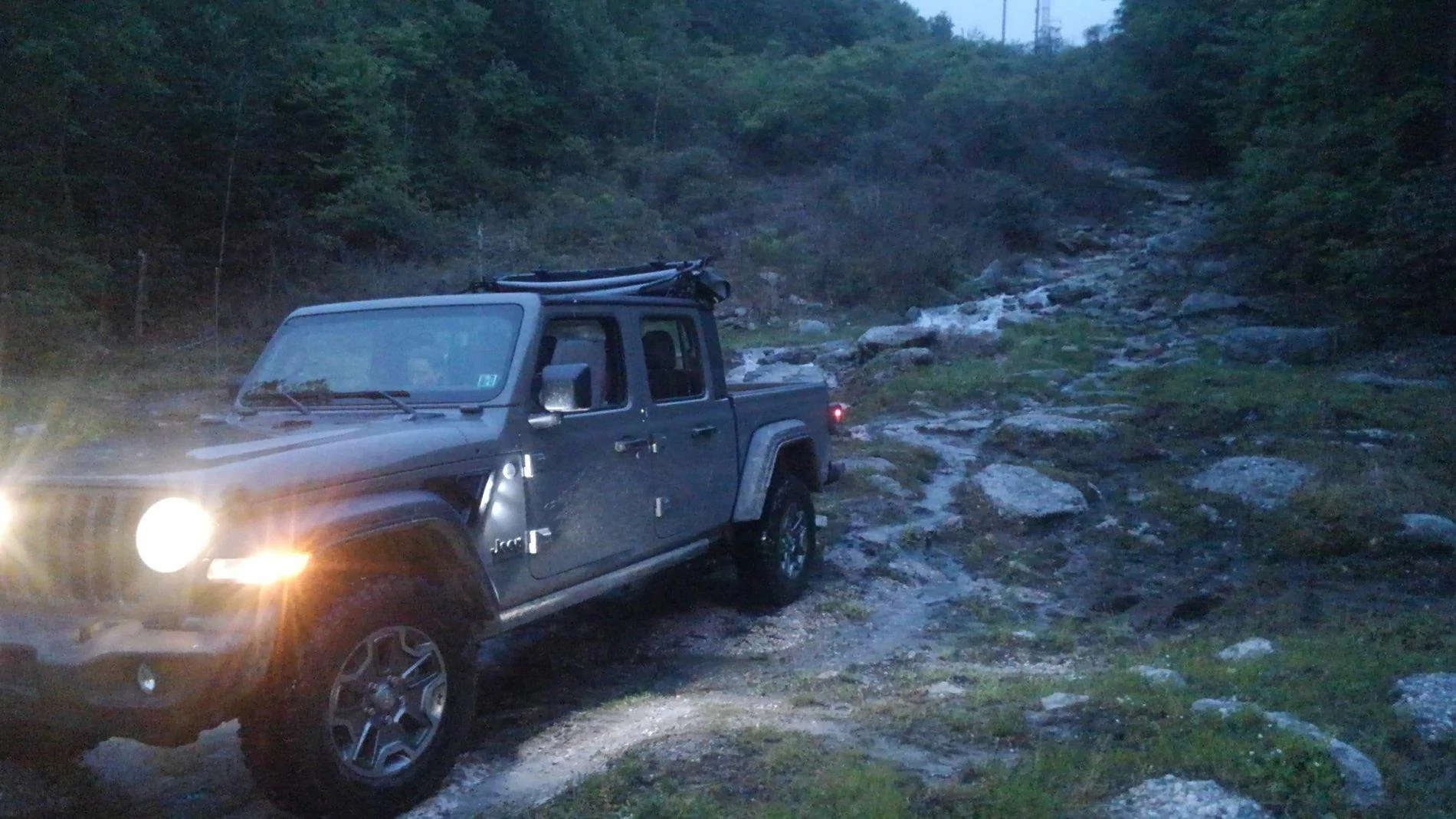

I have them, and love them. I wired mine to the bed lights since I have a bare bones sport and no such switches. I just press the bed light button to turn them on when backing up. They do focus most of the light under the door, but they are very bright, and do light up the entire surrounding area. I'll try to get a better picture tomorrow morning (or night) for you...
bquiz
bquiz
Bret
Jul 22, 2020
Missoula, MT
2020 Jeep Gladiator Overland
Jeep Gladiator Anyone using Oracle Sidetrack fender lighting system? KIMG3092.JPG
benbeen! this is great! exactly what i was hoping for! great call on the bed light switch. i think i would wire them to my aux backup lights to reduce how many buttons i have to press. haha. would love more pics if you have the time but if not, this has been lots of help. much appreciated. cant wait to help one of you guys out with something some day. haha. cheers.

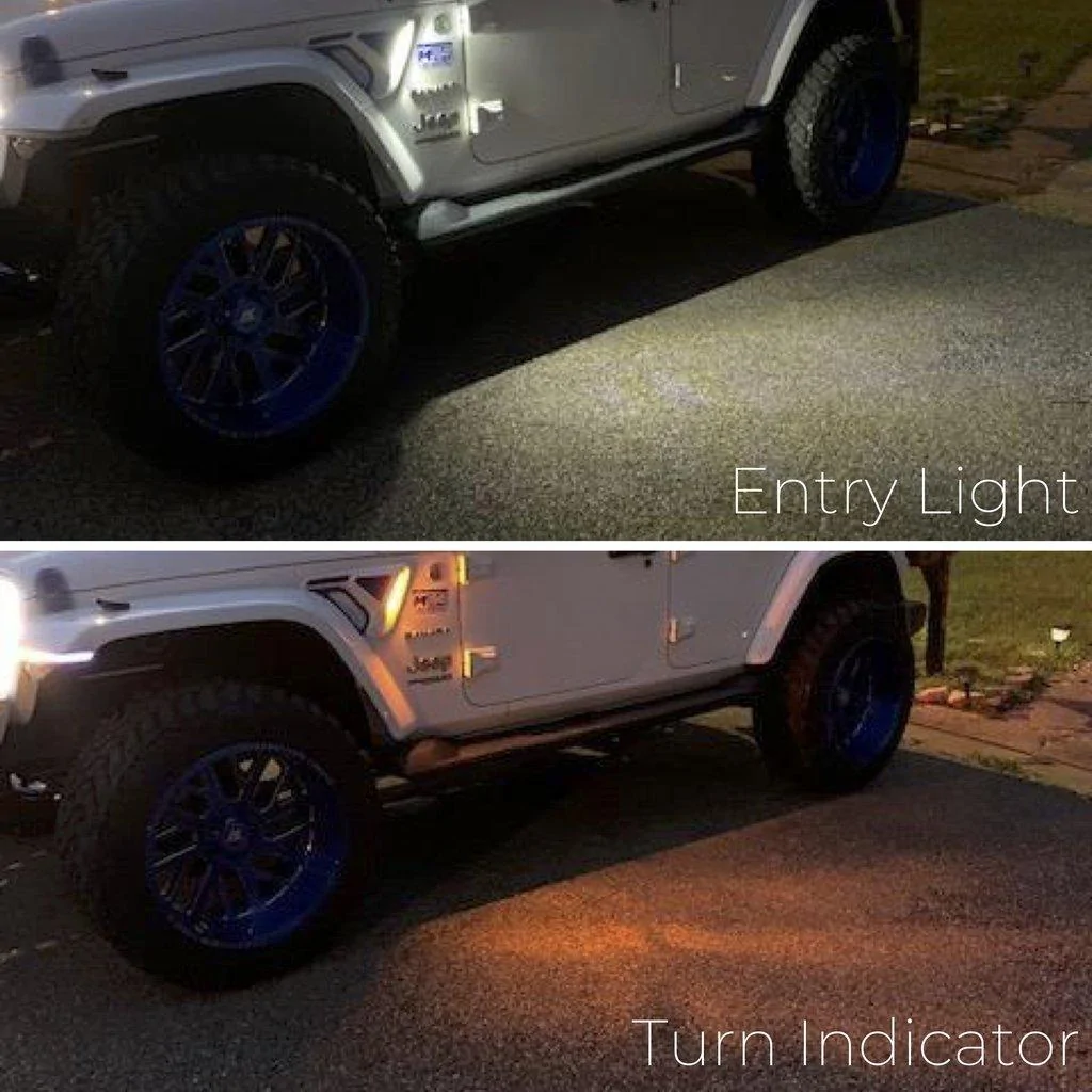

Here is another customer photo for reference:
Jeep Gladiator Anyone using Oracle Sidetrack fender lighting system? sidetrack_chaddaniels_1024x1024

Wow! Those Oracle sidetracks look cool aside from being functional.
