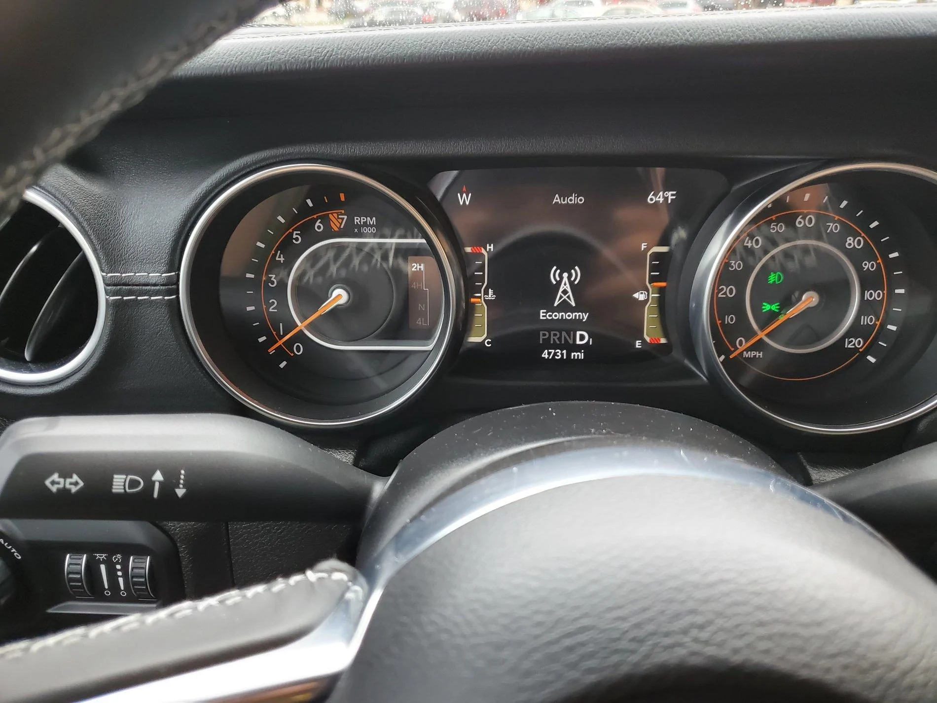

Only had mine for around 1000 miles but with the 37x12.50s and 2” mopar lift I’m averaging 17-18 on highway in economy mode. Also pulled a 5k boat/trailer about 200 miles in tow mode with the lift/tires set on 65 cruise control and managed 10mpg and never got above 4K rpm even on hills. Seems to be a nice increase in power/mpg along with the fact that you can correct speedo, change tire pressure settings and turn off auto start. As others mentioned, performance mode seems fast and makes the truck feel as if it doesn’t have the larger tires.
