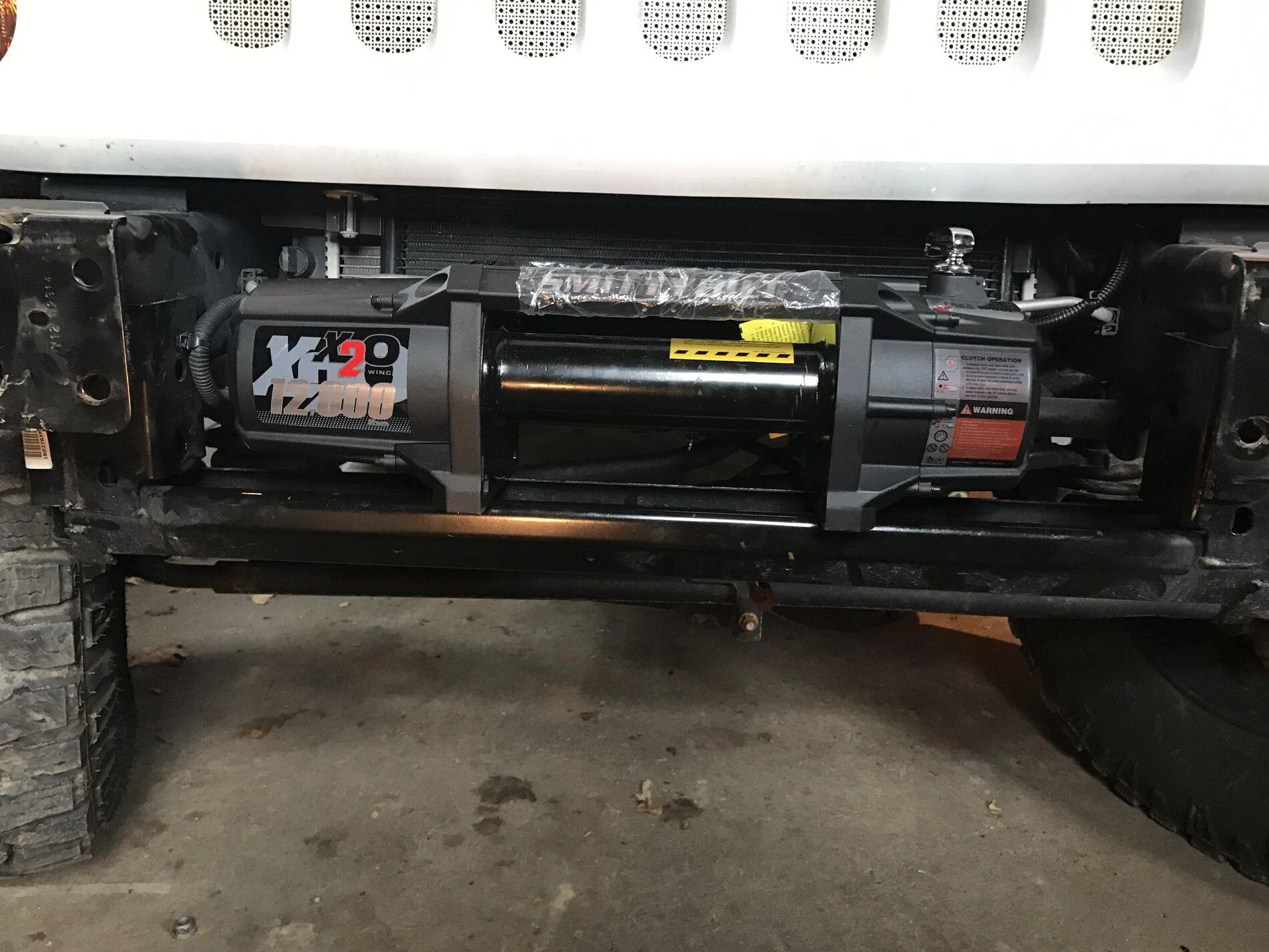

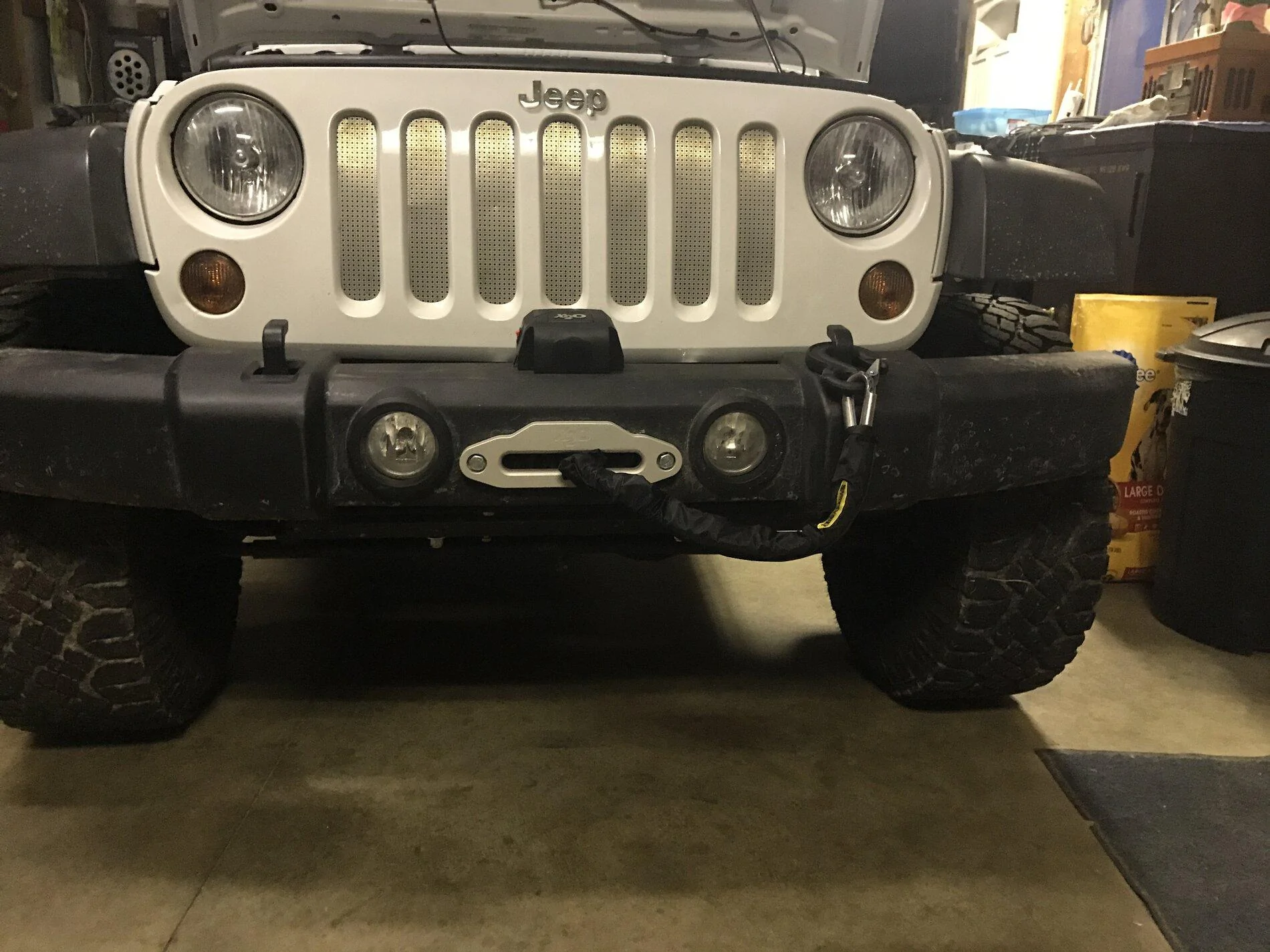

One could mount it in the bumper not on the bumper. I did this with my JK. I fabed up a mounting bracket that bolted to the inner frame rails and then cut into the stock plastic bumper a but so that I could tuck the winch into it. It turned out very nice. Used it that way for years.
Jeep Gladiator Anyone with a Sport or Sport S mount a winch to the stock bumper? IMG_0159.JPG
Going to have to look into that. What size winch is that

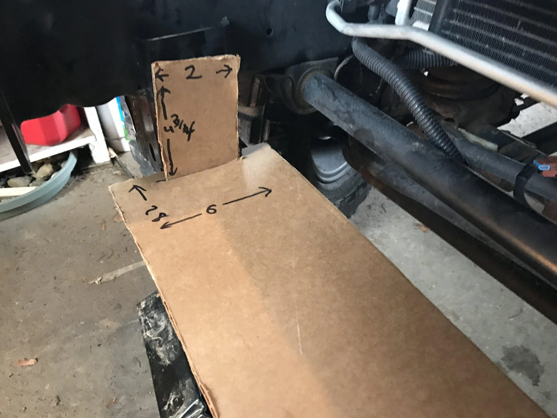

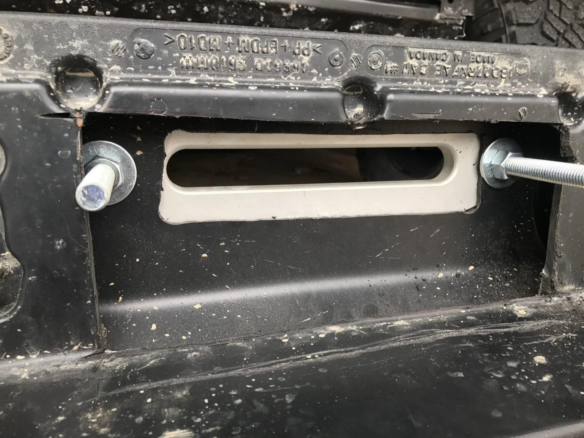

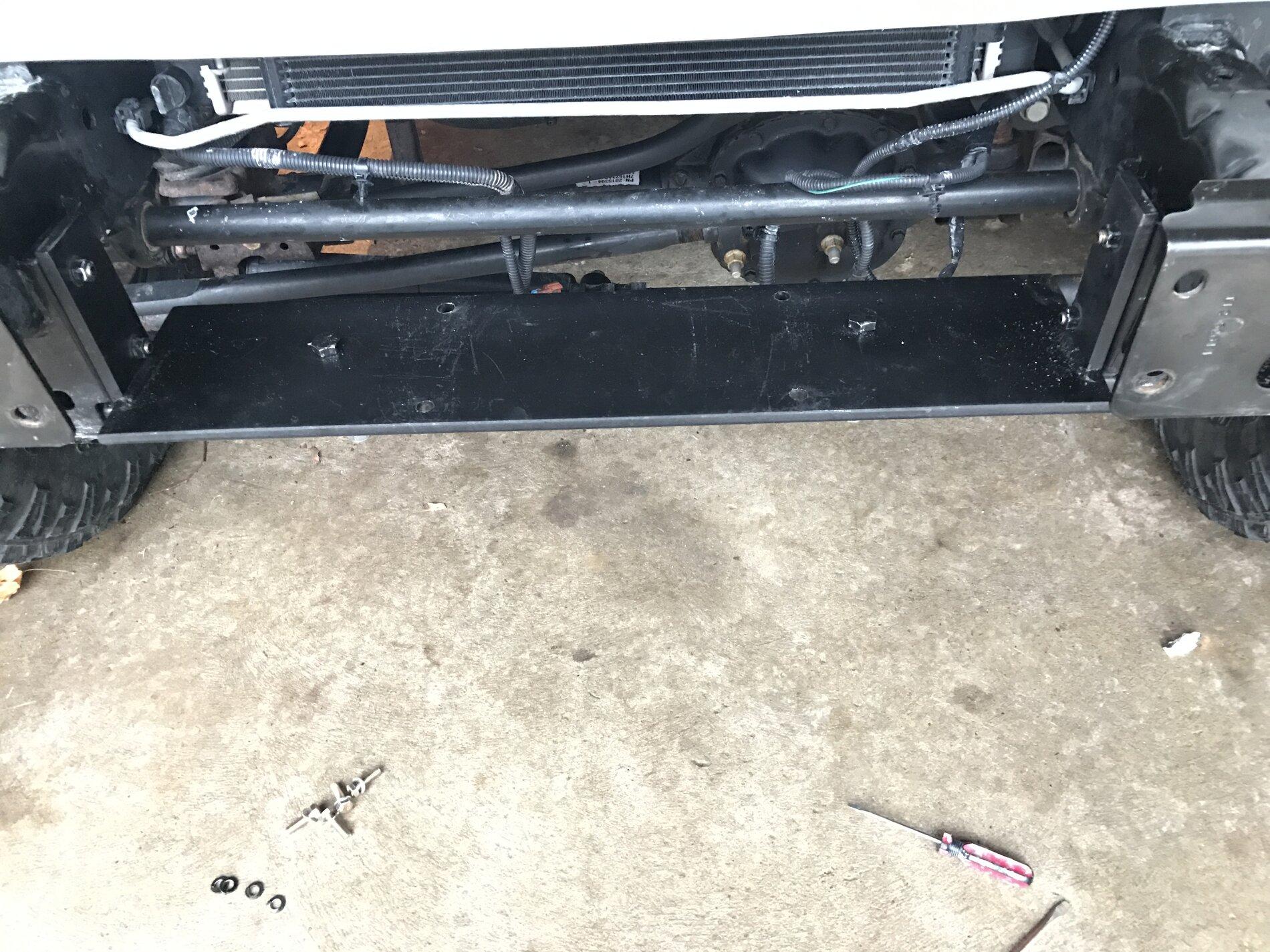

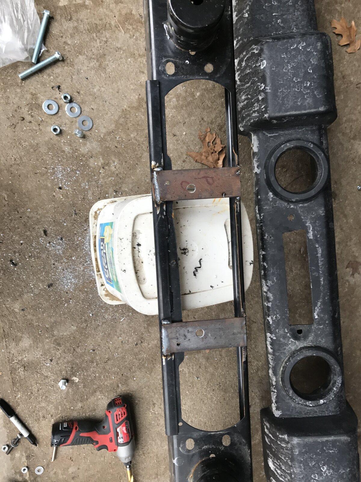

Smittybilt X20 12,000. It really was not that difficult. Started off with cardboard and mocked everting up. Then just took my time making sure everting was correct before moving to the next step.
