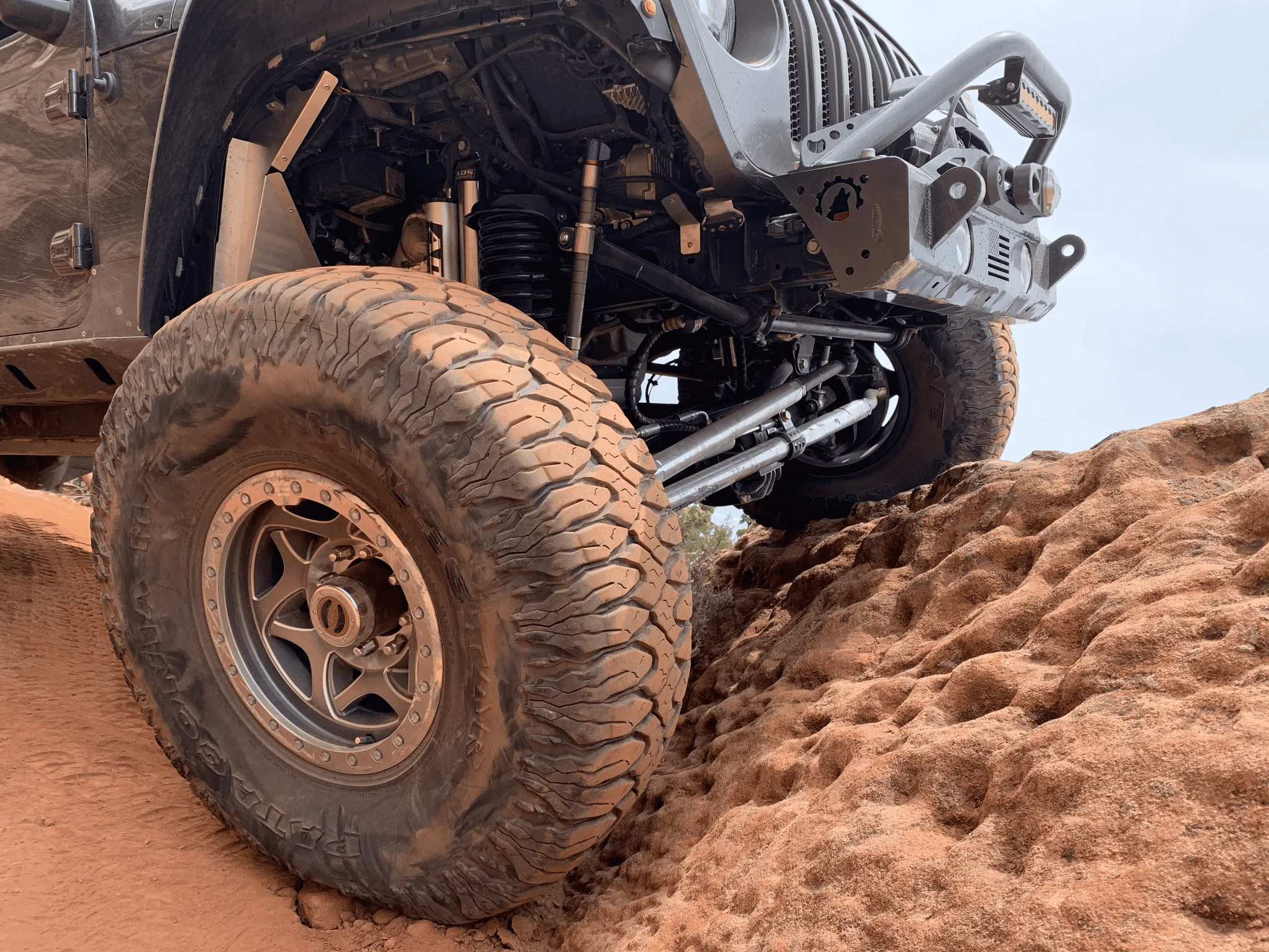

Kinda hard to see but there they are, flexin'...

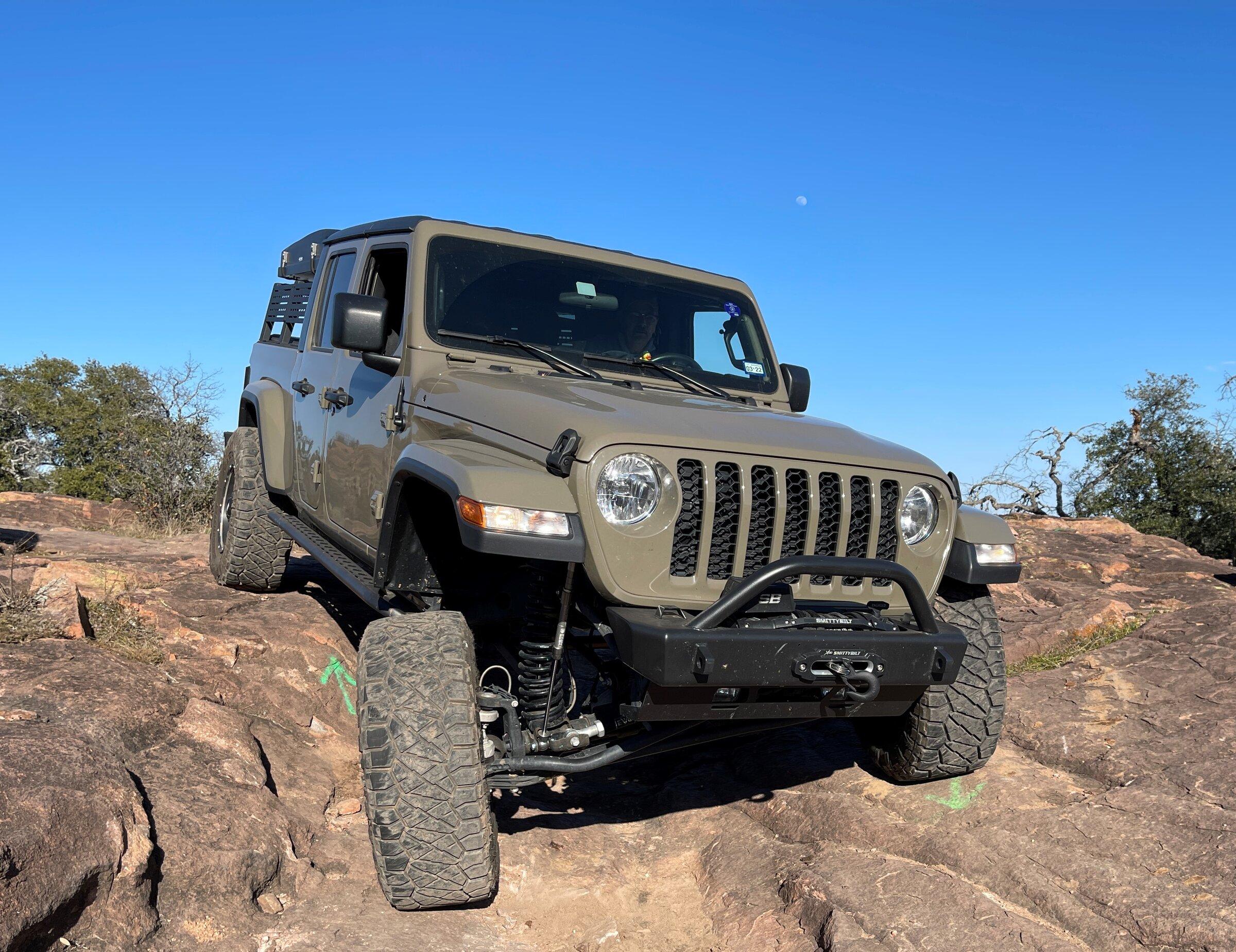

How are you supposed to get at the knob with fender liners installed?
Jeep Gladiator Apex autoLYNX Sway bar disconnect 1645591027933
They sit outside the liners. You do need to check clearance while flexed to see if you need to trim your liners.
