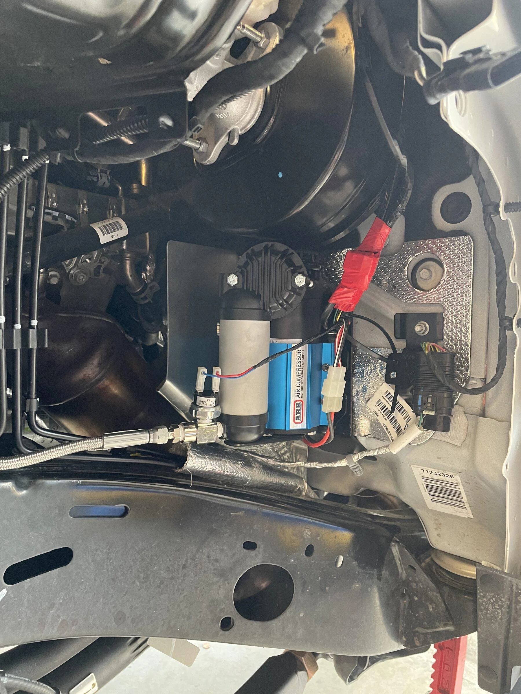

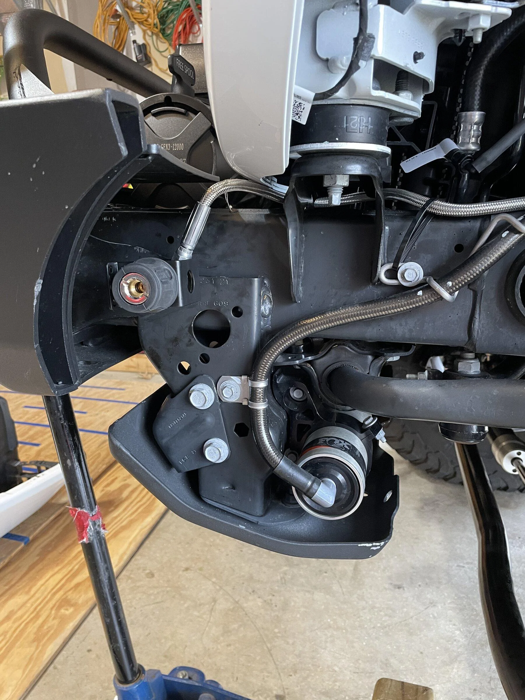

Air up duty cycle is a little slower with the single but will handle 37’s and even 40’s if you’re not trying to air all 4 up at once. There is several YouTube Videos comparing air up timing
I went single and mounted it under the driver fender. Also added a heat shield to knock down the heat from the Cat. It’s convenient to access and wired to the factor aux switches.
